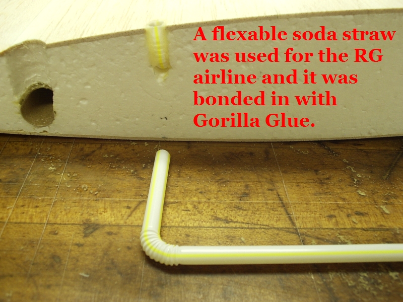

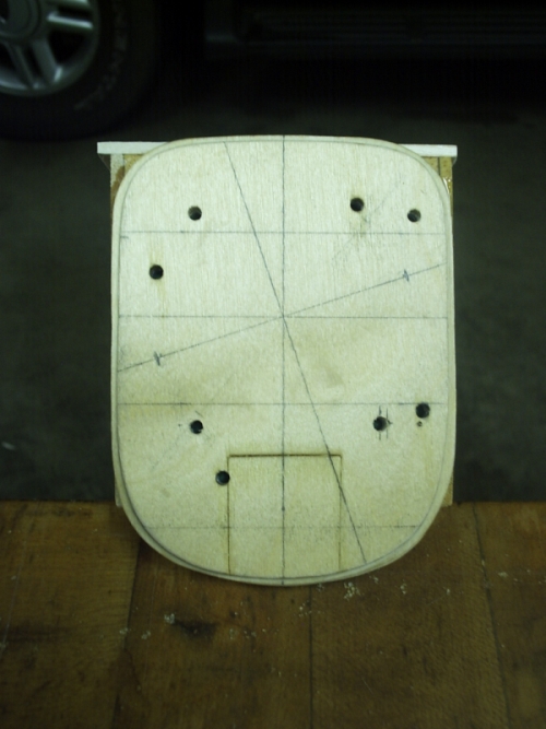

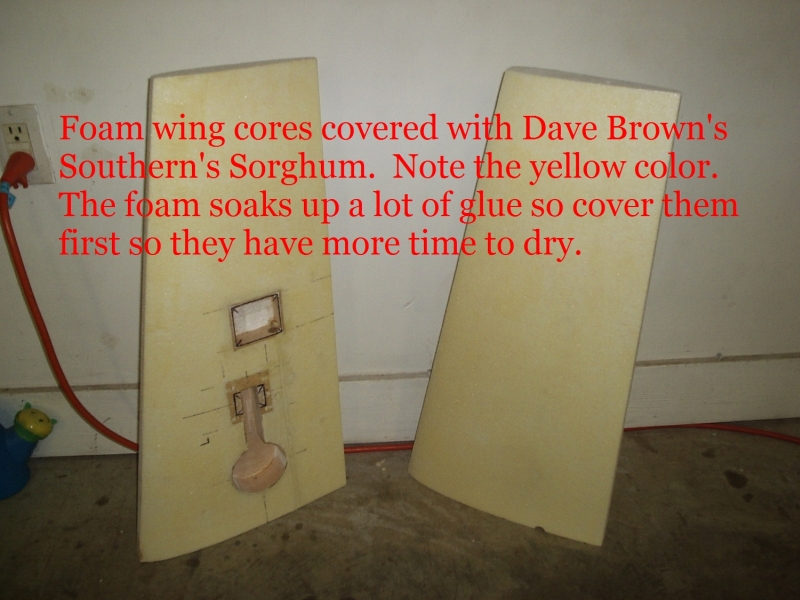

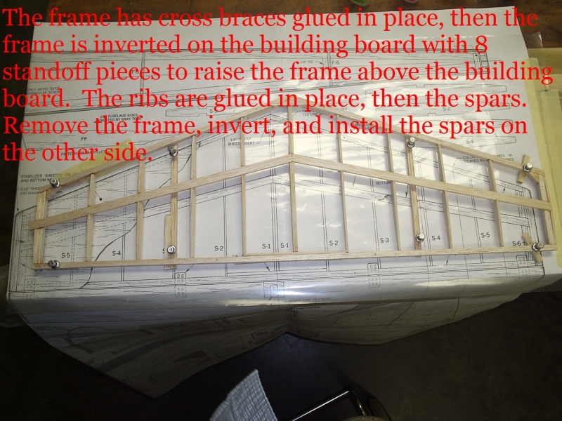

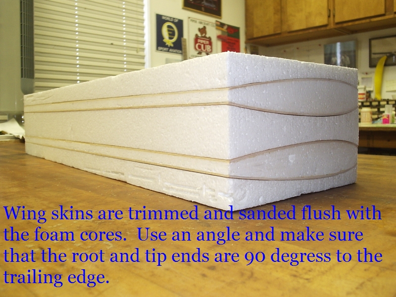

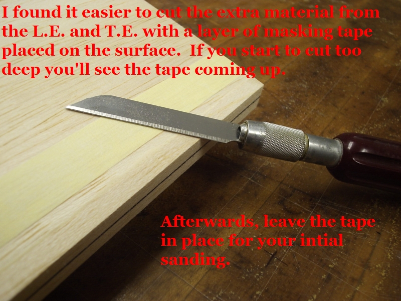

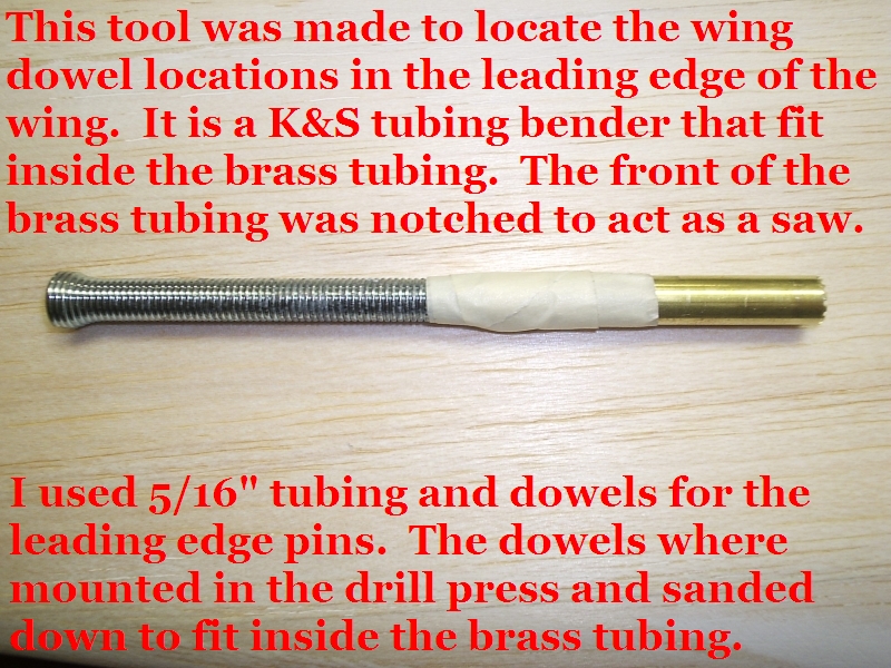

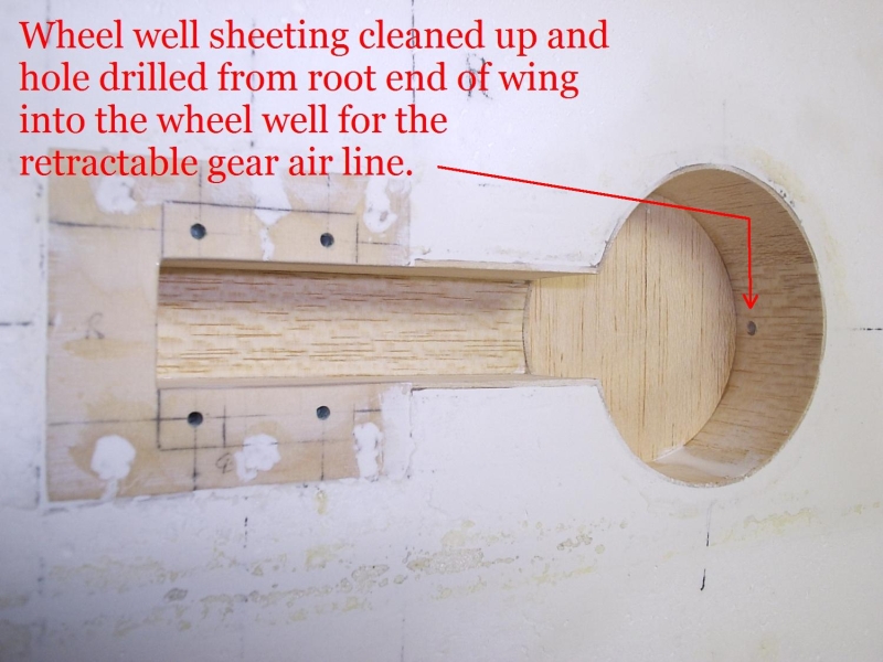

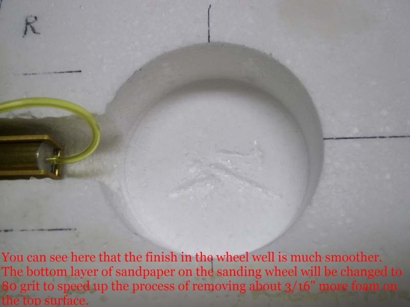

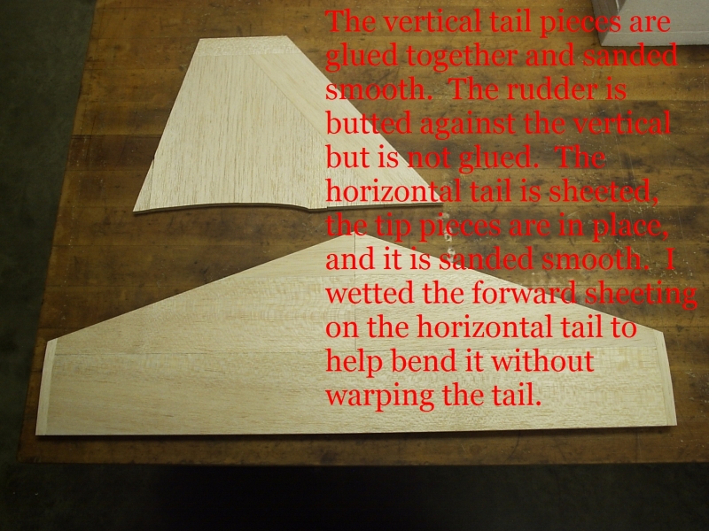

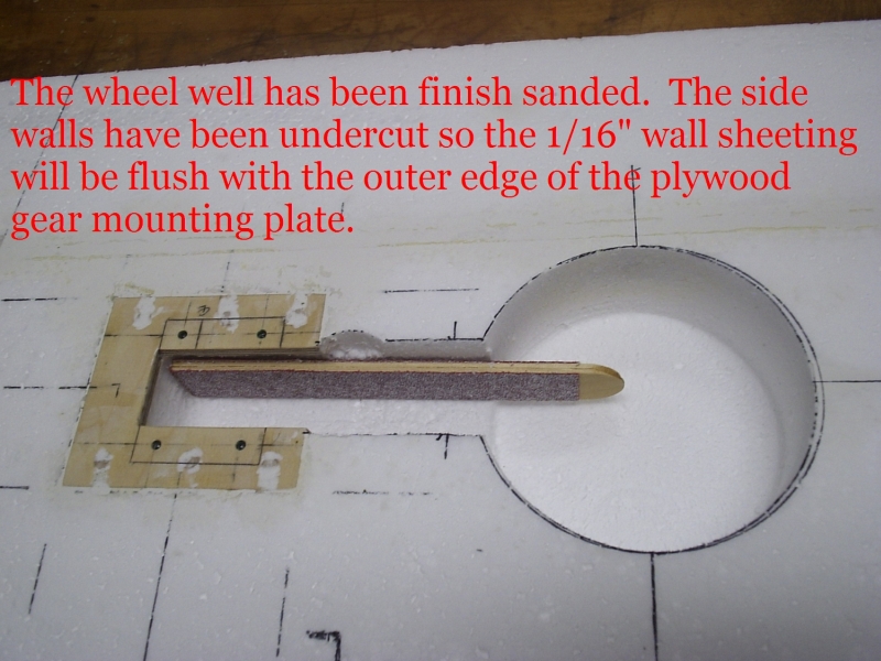

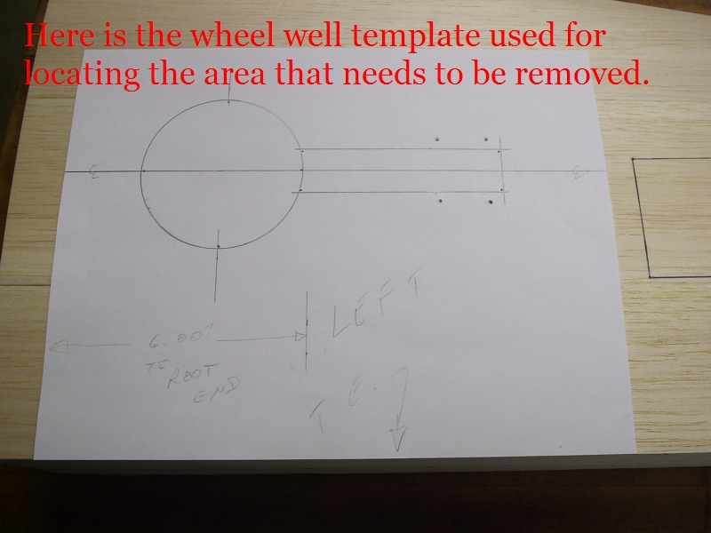

Thought I would start a new thread on the Sig King Kobra showing some pictures of my construction. I will update as I go if there is any interest, but be forewarned I am a slow builder!
These pictures show the way that I am constructing my KK, but in no way am I saying that this is the way to do it. If you have any different suggestions please chime in.

The aileron servo bay covers are three layers of 7781 and one layer of #120 cloth. The aileron servo will be attached to the inside of the cover. If the thickness is not enough to be flush with the wing skins I will add more material to the edges to do so, or skin the outside with 1/16" balsa and sand it down.
I use an epoxy laminating resin that I get locally but is similar to Aeropoxy PR2032/PH3660. Aeropoxy makes some really nice products and you can get your composite materials from Aircraft Spruce and Specialty or Wicks Aircraft Supply.
The second picture shows both covers laying on the wing that they will be used. The landing gear cover is ruff trimmed and laying in position. The aileron cover is in position, but does not sit flush with the outer wing skin. It will need work to bring it up flush. If I had used another two layers of 7781 cloth this cover would have been very close to flush, maybe two or three thousandths under, but close enough.

scalemaster90 and submikester, thanks for the positive comments. SM, you had better cycle those batteries and get ready to fly at the new field!
HEY SIG, YOU SHORTED ME 1.5"!!
After bonding the wing halves together I noticed that the wing span didn't look like it was up to spec. I figured it was just an illusion since the wing tips had yet to be installed, but I measured and my eyeballs were correct. The literature says the wingspan is supposed to be 58.0", but the wingspan on my KK is only 56.5" with the tips in place. I measured the chord lengths and compared them to the plans and there dead on, so I'm at a loss as to where that 1.5" went!
For your building information, each of the foam wing cores measure 26.75" in span (53.5" total) and the wing tip blocks total another 3.0". Measure your materials before you start for comparison. I did not call Sig about this issue. It is what it is!
In the wing pictures you will notice that I left the wing tips squared off. I built my last Kougar this way and I liked it, so the KK will be the same. The aileron servo wire tube exit and retract air line tube exits are barley visible.
The fuselage pictures show the nose gear retract in place, and notice that it is offset to one side. I did this so the wheel would be on the fuselage centerline while retracted (I believe this is mentioned in the instructions). As set up the coil on the nose gear wire will not be visible from the exterior in the extended position, and the tire will be completely inside the fuselage while retracted. The pictures in the manual show the nose wheel slightly exposed while the gear is retracted.
I originally set up the firewall for two engines: a Saito 91 in the vertical position and a S.T. 61 ABC in a canted position for a Tuned Pipe. I originally started this kit two years ago this month and got side tracked with some other projects thereafter, and in the meantime I decided to use the new O.S. 75 and save the .61 for the next Kougar project. I'll have to see how the .75 is going to fit before I get too far along with the fuselage.
In the picture of the plans you'll see my notes where I raised the top surface of the nose gear retract mounting plate (TF) up to the fuselage centerline. If needed for C.G. purposes this leaves room above TF for batteries and/or the retract air tank. The 16 ounce Hayes fuel tank will be located between fuselage former F2 and F3. Former F3 will be modified and another complete bulkhead installed just behind the fuel tank. I'll get pictures posted of this later, as I'm not that far along yet. There is still plenty of room between former F4 and the fuel tank for the elevator, rudder, and retract servos.

i have a question about your ailerons if you've got that far yet. of course the trailing edge is square to the wing but the ailerons are not true elongated triangles. they are really a elongated triangle half with a beveled leading edge as best as i can describe them. i don't like the way they droop when laid flush against the wing trailing edge. what is your opinion or intentions? thx, david
dhal22 is offline
Reply With Quote
Old 11-11-2007, 09:06 PM
ExperimentalAviator
My Feedback: (15)
ExperimentalAviator's Avatar
Join Date: Jan 2003
Location: Tuscaloosa, AL
Posts: 239
Gallery
My Gallery
Models
My Models
Ratings
My Feedback
Default RE: Sig King Kobra Build
David,
My aileron stock was not usable because the leading edge was not thick enough to match the trailing edge thickness of the wing. I went to the my LHS and found some beveled ailerons that will work, and as a bonus the balsa was a little higher grade (more dense), and were already shaped like the bottom aileron side view in the picture below.
The picture below was taken from page 11 of the instruction manual and the top view is the shape of the aileron as it comes out of the box. The bottom view is what it should look like after it is shaped. Notice that the dimension that you are to mark and sand to is not the same on top and bottom. This is due to the shape of the aileron as Sig provides it. If you mark and sand the aileron just as the instructions show here your aileron will come out with a beveled leading edge that is perpendicular to the chord line.
If you have a stocked hobby shop nearby you could take a piece of your aileron stock down there and find two that are the correct size and already beveled. I believe mine cost $3.00 each.
