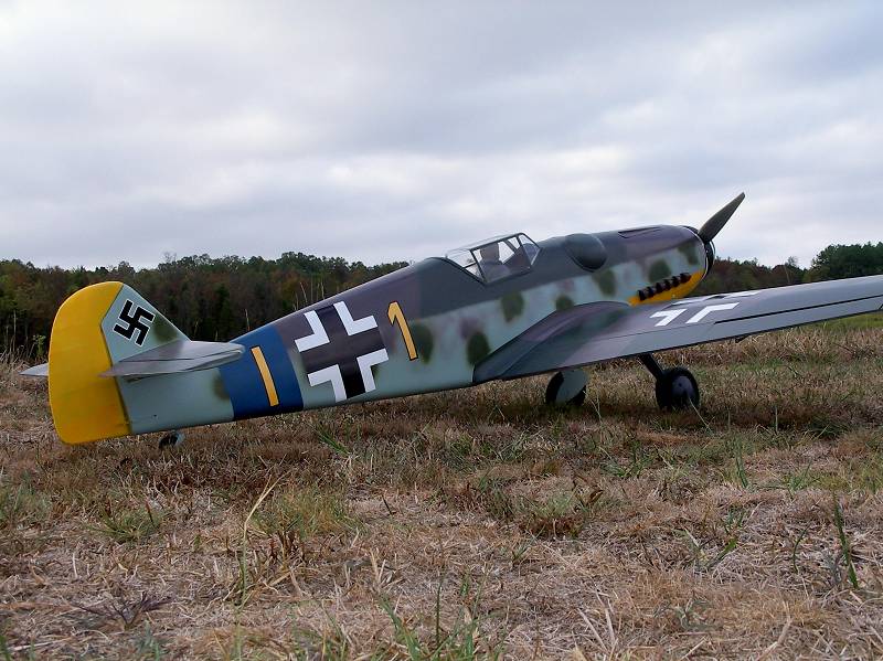

this is what I did after much fiddling with this paint,and what I found worked best for me.
I have been using my airbrush to spray my www.warbirdcolors.com paint, it has larger needles so I can shoot large volumes of paint that most won't, thinning about 30% with water has turned out to be a good ratio for my gear that I use.
so I have a old hair dryer one of my wifes cast offs that works well,I first lay down a light coat, lightly blowing the coat dry,too close with the dryer, or too heavy of a coat, and the paint will skin over and cause checking, so hold the dryer about 3ft away and wave back and forth rapidly,so it drys even and not to fast,after a couple of min.you will see the paint begin to dry at the edges the wet and dry areas will be obvious as soon as the coat is dry spray another light coat and repeat under normal circumstances a section/wing side can be done in a 1/2 hour 3-5 coats for the last coat I would spray a little heavy give it a light blow and leave it so it would set for a bit.then you can flip the wing or fuse and shoot the other side
if your space is really cold then a space heater wouldn't be a bad idea but the hair dryer works great once you get the hang of it.
before I started using the dryer I was having dripping problems, spraying the paint it would run and drip with even the thinnest coats, the warm air sets the paint in position and evaporates the water quickly so far its been working great with this method.
I have even taped over sections of white and shot black invasion stripes doing the job in about 4 hours,one thing I would recomend doing is back sealing any tape lines so the tape doesn't leak I use the clear coat to do this spraying the edges to seal them then shoot the color coats it makes a clean line and requires little touch up it takes some practice but once you get it dialed in you will be surprised how well it comes out practice with the product makes the difference,I screwed up a few times before I started having the results I wanted,and I have been working in const.and house painting for over 20 yrs.
some of my results from my Top Flight P-47 and the stencils I used from www.getstencils.com

I will probably give it a try Bigtim. I noticed a couple things on your pics. Any reason you didn't paint your white first? I think it would take a lot more and be harder to get it to cover? I was always taught start with the lighter colors first.
I see you used stencils? I'm wondering if I can buy the stencil material some place and make my own? It sure looks easier than masking etc. I watched the heat in my garage over the weekend and it held 60 degrees pretty easily without heat. I'm hopeful with a heater in there I can open a window and keep things around 60. What kind of temps are you painting in?

the way gary from www.getstencils.com has it set up you do the background first his stencil line up method is pretty fool proof,US insinia blue doesn't cover that well,really all the primary colors ,blue,yellow,and red take alot of coats to get them to be opaque having to cover the white would have been a nightmare,the white covers in 3-4 coatings easy.
really the amount I paid for the stencil work was well worth the time I would have spent trying to cut them out and I would have never been able to do it as well as the ones I purchased,and I had my boys initials done for the large lettering on the fuse side in the font the came in,as well as the numbering for the tail that I didn't show.
the invasion stripes were done with a white background and the black was done over that.
as for temps I live right on the coast temps in my shop are around 50-60o there doesn't seem to be a problem when I use the dryer,just remember the paint isn't cured fully so a light touch is what I would recomend for at least a day, or you might find your fingerprints in the surface.
