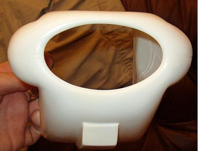

3) bought a fiberglass cowl from Fiberglass specialties. Another cosmetic thing, but this cowl is awesome looking. I'll attach a pic.

Old 02-24-2003, 04:08 PM
Heath
Join Date: Jan 2003
Location: Morgantown, KY
Posts: 99
Default SIG Four Star 60
Here's a pic of the cowl from Fiberglass specialties.
