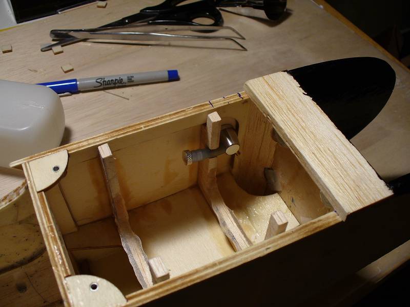

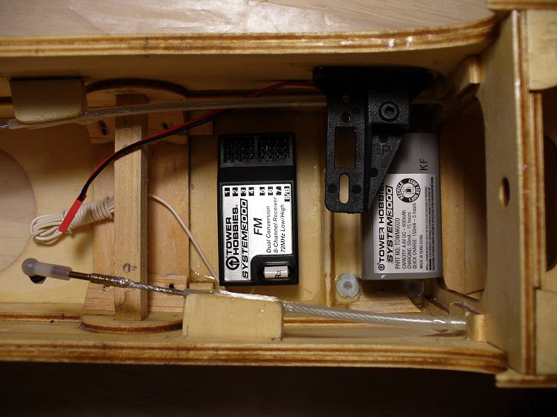

The battery need to sit behind the servos for balancing the motor, with OS 46 its tail heavy otherwise.

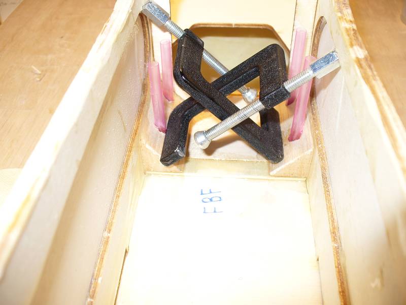

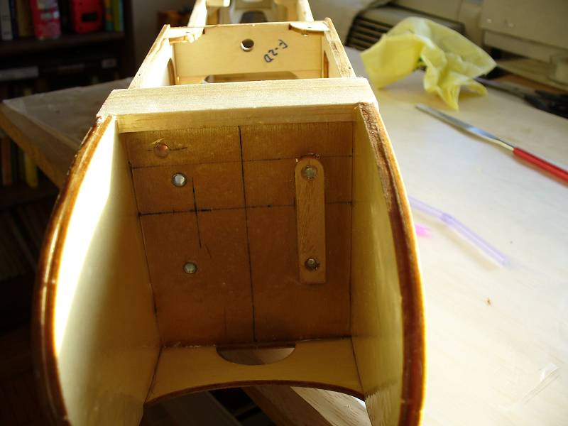

First picture i’m planning the battery location and the servo tray.
An antenna tube need to be inserted eventually
My wife is getting me a dremel for my birthday, I need it for plywood servo tray, so I’ll imagine it with futaba servo tray and then squeeze in a ply wood tray.
I’m getting nuts with details and glue

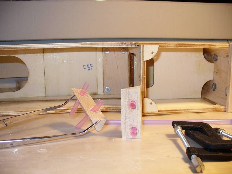

This time the support for the landing gear base is being glued, they need to be tight with everything around them no gaps.
I found a funny way to press the triangular spur against something in this tight space.
The drinking straws are for not to fill the holes with epoxy.
Later on I’ll place there a fiberglass tape from wall to wall to hold it to the fuse, I don’t know if its good to hold it so tight that the landing gear wont come off under any circumstances.

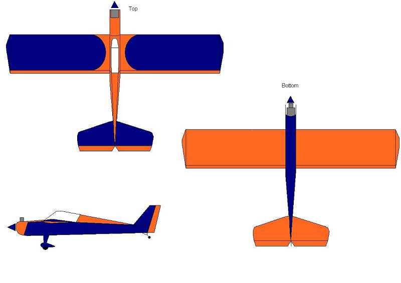

Close enough on the motor, in the picture it's a O.S. 40FP, it was replaced by an MDS .48 later on, the FP
just didn't have the guts for verticals but the MDS really did. The scheme I was aiming for back then was
early reno racers (hence the checker bottom). I always did think that the mid star would look pretty good
in BF109 colors....

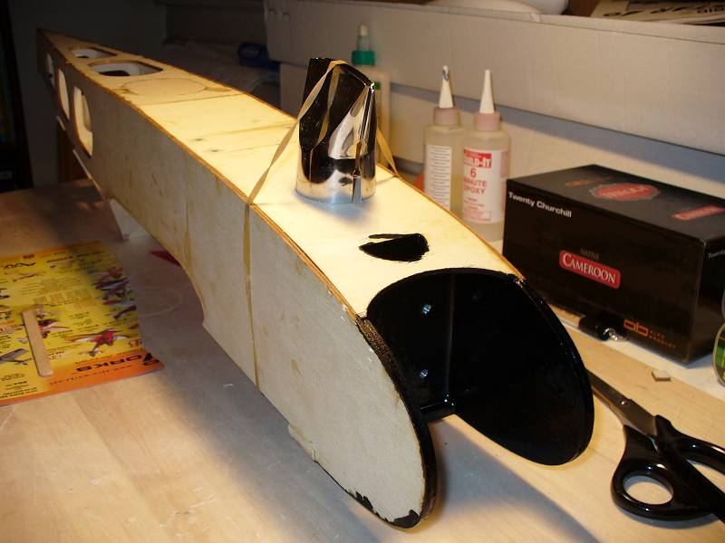

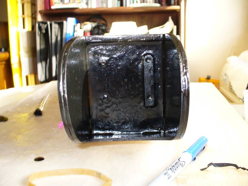

I made a big mistake during the build with the fire wall, its looking left about 3 degrees so I added a popsicle stick under the left motor mount and sanded it, now the are even and looking straight.
Painted the engine compartment with epoxy first the aero gloss, this way no oil will be absorbed in the fire wall and connections to the fuse.
The holes for the motor mount were covered with tape to avoid epoxy, its breaking easy with the screws.

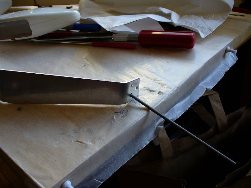

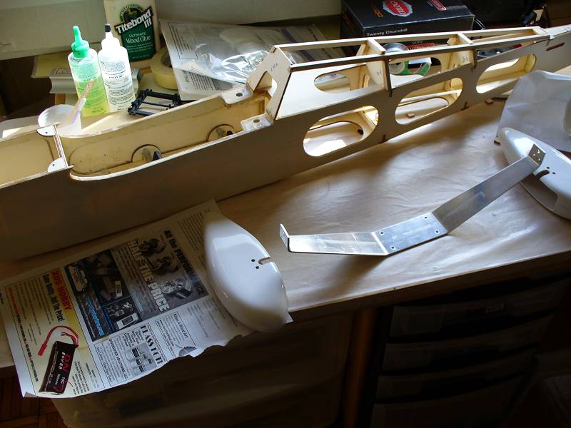

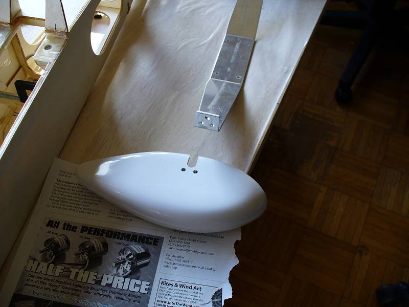

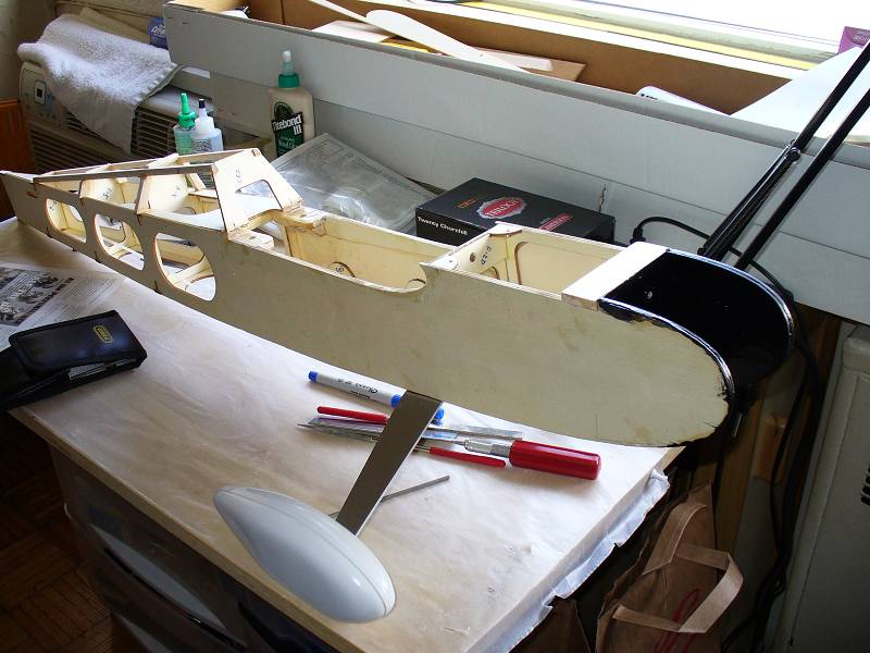

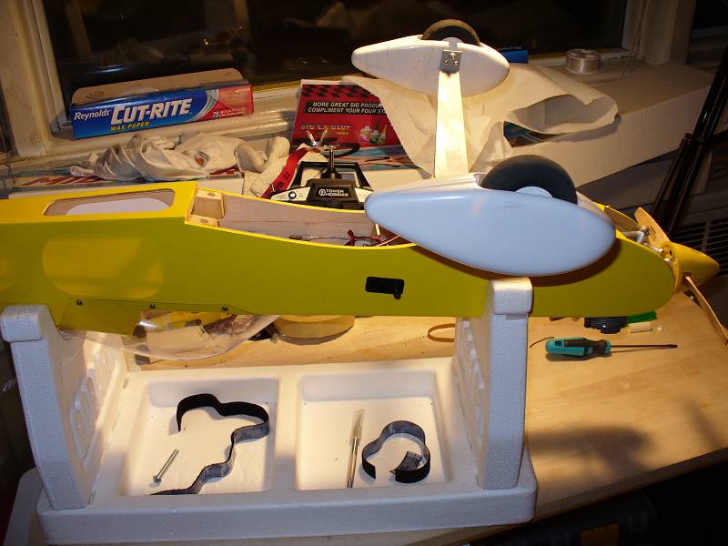

Because of weight I took the front wheel off.
The tail wheel bracket that comes with the kit is a sad joke, its just getting stuck in the rudder only, and what is being used is this (sorry for the after market announcement)
http://www3.towerhobbies.com/cgi-bin...?&I=LXFV47&P=7
wheel pants: I intend to buy and use the four star 40 ones, it’s a similar landing gear with the same bolt pattern for the same 2-3/4” wheels.
I’ll get them from sig directly www.sigmfg.com
Also additional engine mounts you can buy only from sig, they are good and cheap though.
motor mounts i'm buying only from them it comes with hardware, i mange to spoil one pair of mounts every build...
Sig’s customer service is very good, they sent me a new wing for 4*40 even it wasn’t their fault.
Who asked me if it’s the same profile as the four star 40, it is, I just placed 4*40 wing on the plans and beside 1/4 “ shorter because of ailerons its identical.
Color scheme now I’m at neon green bottom wing and fuse and insignia blue top, maybe cub yellow I have some pieces of it….

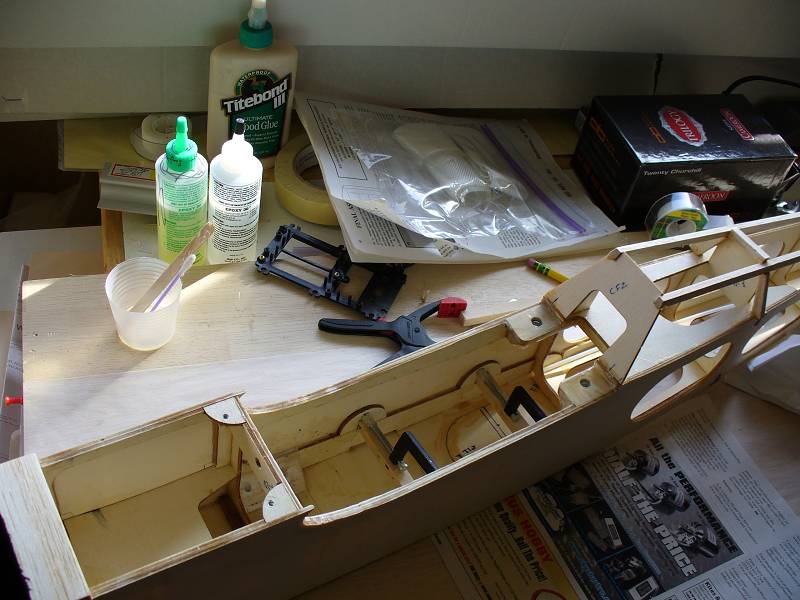

I have to agree with Alex about the rudder mounted tail wheel I have had problems with that myself before. It puts a lot of stress on the rudder and mounting I have had a rudder depart the airplane on takeoff using ca hinges with the tail wheel on the rudder. On my Something extra I am going to use the (Dubro Semi-Scale Tailwheel System Size 20-60 DUB955 #25511) it weighs 18 grams or so.
Worse case you have to a 1/2 an ounce or so up forward, my favorite method is to use the weights like the control lines guy use that go behind the prop nut. It helps make for a smother idle although it does slow the spool up and down of the motor a bit but I am not looking for a fast response on the throttle.
Alex nice use of the clamps I will have to remember that setup for internal clamping, along with the straws, nice work!

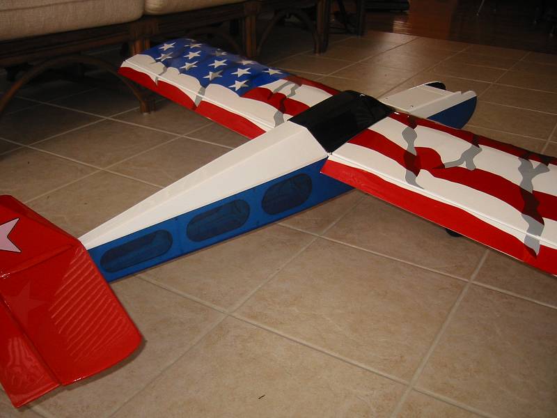

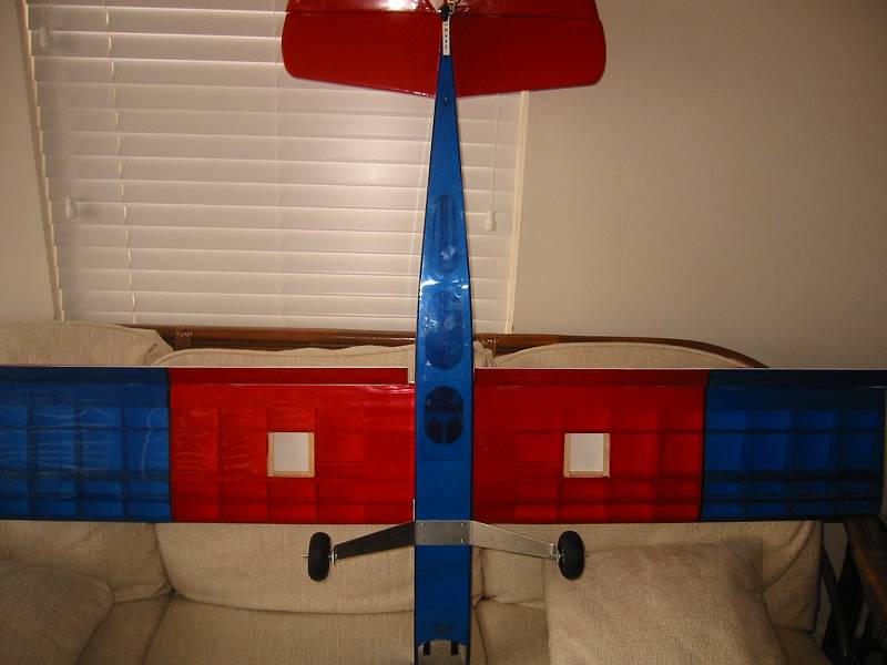

Here are the pics of my Mid-Star that I referenced a few posts back. Kinda looks naked without an engine up front. I have a TT .46 PRO to throw up there which ought to be plenty for this airplane. I got the idea for the flag from this thread on RCU in case you're interested ([link=http://www.rcuniverse.com/forum/m_603331/anchors_603331/mpage_1/key_flag/anchor/tm.htm#603331]3D Flag[/link]). This was my first time using the "windex" method and am pleased with the results. Could it be better? Sure ... but for my first try I think it'll pass . It took me forever to complete the pattern, but I am a naturally slow builder.
Anyway, keep it up. I wish I had the patience to post pictures during a build - thanks to people like you, we can all learn new tricks ... even some of us "old dogs" [sm=lol.gif]!

wow nice covering job MA,
Question: does the transparent blue has the same tone as the insignia blue?
Means if I put the near each other, will I see difference in tone besides the transparency?
I was thinking to make top wing in transparent blue and fuse insignia blue.

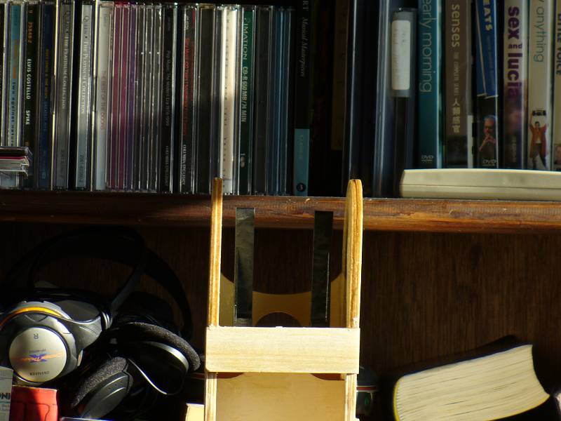

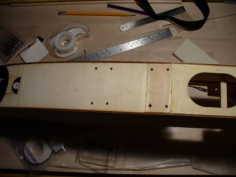

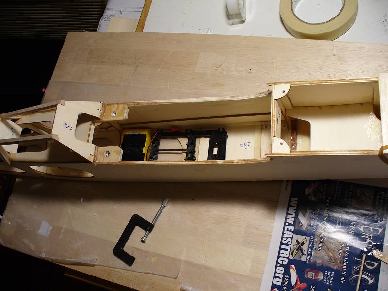

In pictures i’m gluing the servo tray holds, I’ll see what sits better, the futaba plastic one or cut out of 1/8 ply wood for a tray.
I got from Sig the wheel pants of four star 40 ARF, they came with inner plastic with ply wood and blind nuts already in place, had to sand/enlarge with a file the holes in the aluminum LG about 2 mm to fit the holes.
I have some lusterkote paint of insignia blue which I meant to paint the LG.
its not attached yet, its 29 F degrees outside and windy [].

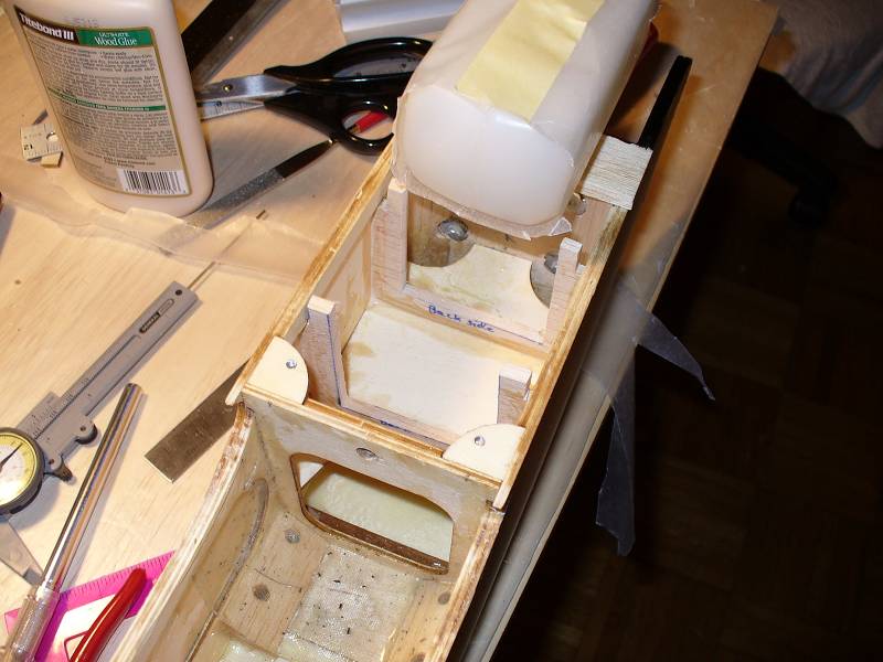

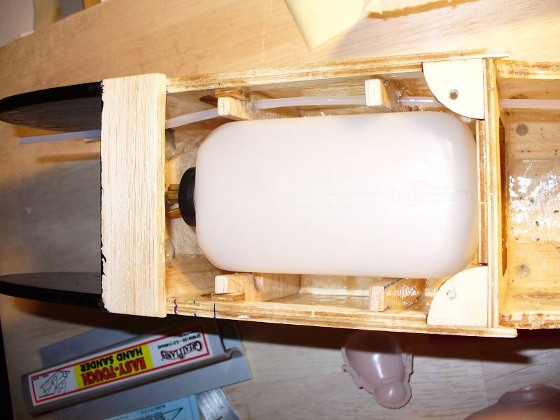

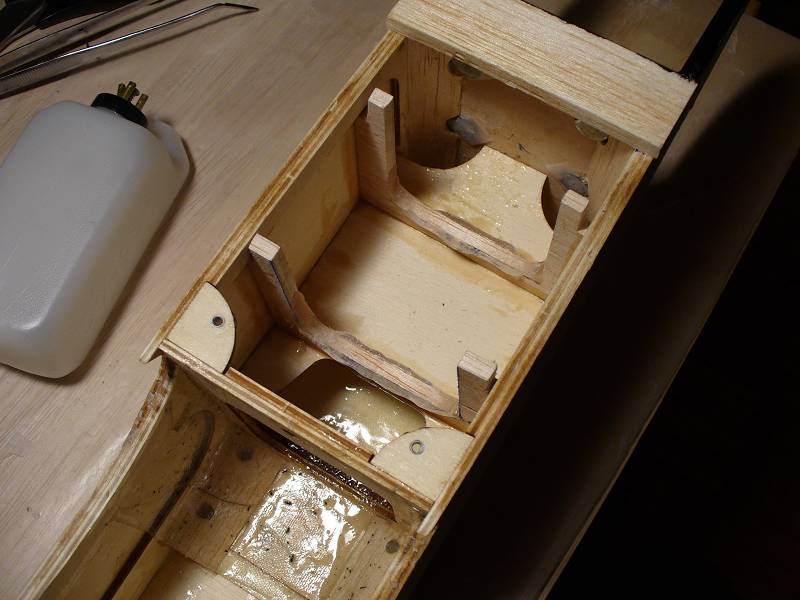

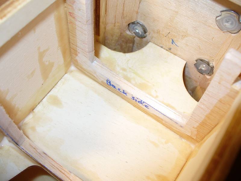

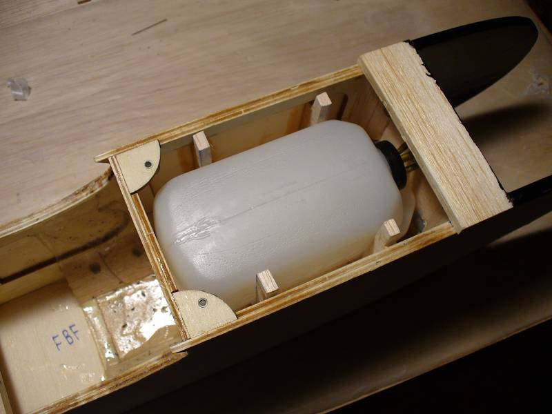

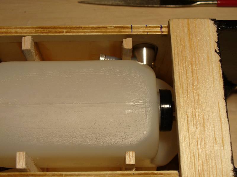

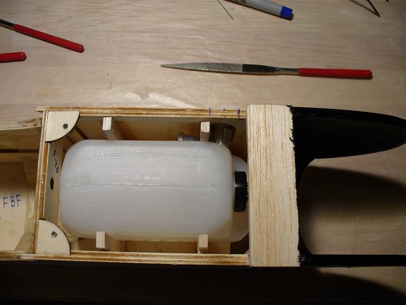

The fuel tank compartment is being assembled.
Foam for holding the fuel tank was working for me so far just trying more elegant setup for the fuel tank.
I used 5 min epoxy to formulate the shape around the tank, its kicking in faster.
Added tape so there will be corners to hold the glue.
Filler valve was added and I’m gonna use it just to fill and empty the tank not to carb.

Bob and David,
In post #5 before you glue the fuse inner part, thats when you need to decide what fuel tank you are gonna use.
If its Dubro 8S as instructed you don’t need to change anything.
After that stage changing the tank floor becomes complicated.
As for motors, I put on mine OS 46 AX, it takes off with ¾ throttle swinging 11X7 prop.
I’ll put the OS 46 that I have with 11X6 prop this time.
In my opinion
I would use 2 stroke because of location of the throttle on left side on 4 stroke motor.
If the exhaust is on the right side then the switch, voltmeter, filler valve is on the left and in addition to add the throttle cable into there, it’s a recipe for a wire spaghetti.
On the other hand 4 stroke motor produces much less crap from its muffler, in my midstar the wing is getting filled with this crap.
Things to think about.
Alex

What do you think about this color scheme?
The covering material gonna be monokote.
Trying to decide if to use neon green or neon orange on bottom.
i'll do the orange, green is very beautiful i intend to use it on 4*60 i'm gonna build this winter.
On top i’m thinking about insignia blue.

Bob,
As far as engines go, either choice is fine. Just keep your prop clearance in mind. The stock gear will not provide "adequate" clearance with a 12" prop. That is my experiance with the taildragger configuration and the Saito 56. Switching to a taller gear made a world of difference. If you look at photo 82 in the instruction manual, you can see the prop doesn't have much clearance.
Alex,
Keep up the good work! Your color schemes look good. I think it's important to use bright contrasting colors when using dark blues. Maintaining orientation with dark colored airplanes can be tricky at times.
