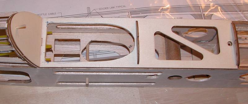

Some small progress made…
I managed to reduce the weight of the plywood base for the canopy hatch from .6 oz to .4 oz so that is another .2 oz to add to the total weight reduction. That now puts the total amount of weight reduction at 3.7 oz thus far. After that I installed the two formers three stringers to the hatch assembly and am now ready to start adding sheathing to the hatch.

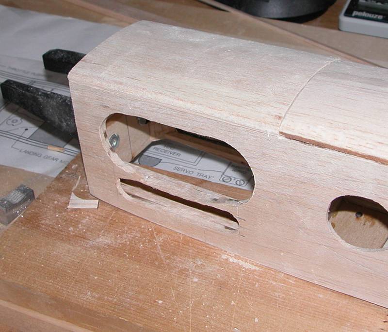

Got the canopy hatch sheathed, and built and sheathed the tank hatch. Got the skin to sheath the turtle deck glued up other than that not much progress other than taking a hard look at the tail feathers and how they are going to be modified.
I have not finished the sanding on either hatch as of yet, I will do the finish sanding after the cowl is shaped and the rest of the fuselage sheathed.

Thanks for the compliment but the canopy hatch has some filler on it, thank goodness for microballoons … The wood was a bit stiff and I cracked on that side as I bent it, and it was soaked down fairly well. The forward hatch was planked on the sides and then skinned, lots of sanding on that but not much filler. Basically sand away anything that doesn’t look like an airplane…

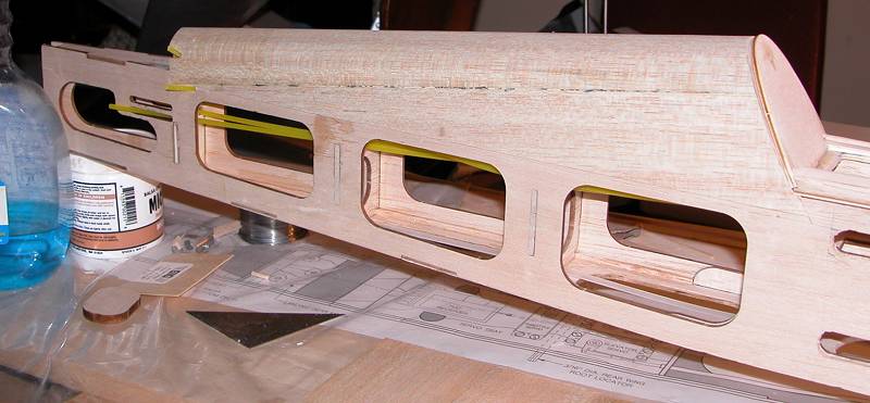

I have been working on the plans for the horizontal stabilizer and vertical fin modifications I intend to do and plan to start putting them together in the near future.
I have the turtle deck sheathed and one side of the fuselage sheathed just sanded out the skins for the other side tonight after our club meeting. I hope to have it done tomorrow night and will try to post some photos as an update then.

Just a quick note and some pictures to update my progress thus far.
The first picture shows the turtle deck sheathed and the second shows the sheathing applied to the sides of the fuselage. You may make note the sides are sheathed with the grain vertical as you would do a shear web for the same reason. This along with the carbon fiber veil should add a lot of strength to the airframe. And allow me to add a radius to the bottom of the fuselage to clean up the airflow a bit.

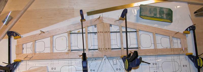

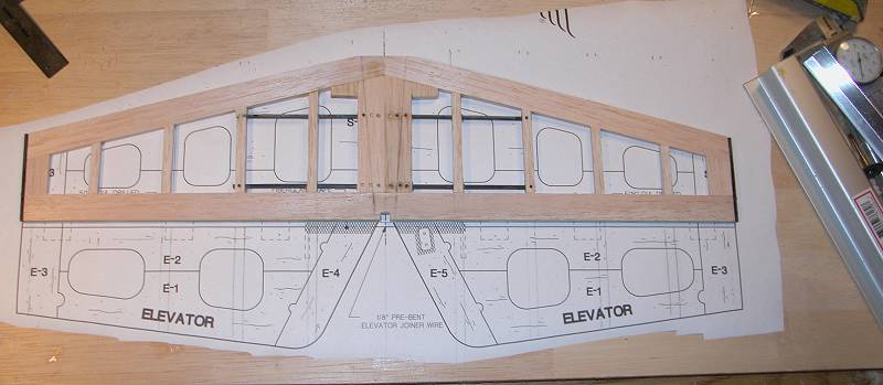

I started to work on the my version of the horizontal stabilizer and elevators tonight but it is getting late I did not get much more done than the basic outlines done at this point. Hopefully I will be able to get the ribs and spars done tomorrow night so I can start on final assembly this weekend. I will post some photos on this whole process as it comes together over the next couple of days.

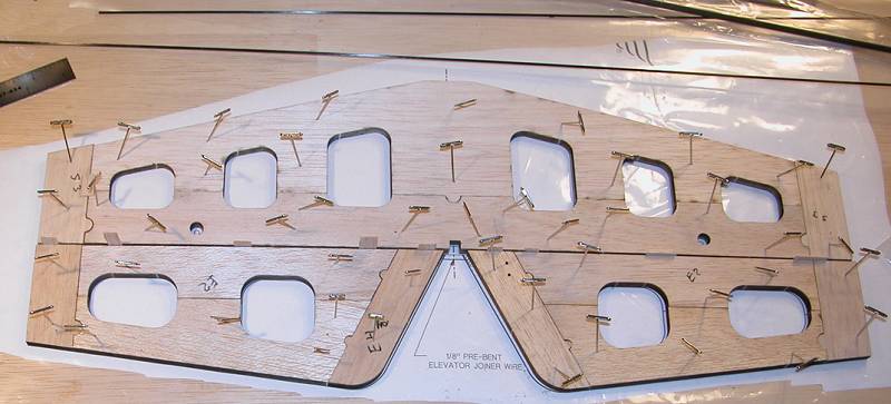

At this point because I felt that the construction of the tail group, couples with the change I intend to make in the shape and size of the components I decided it was time to sit back for a moment and consider it carefully. (A “measure twice-cut onceâ€, type of approach to this part of the modifications for this airplane build.)
Where the tail group contains two of the major control systems and I plan to modify these from stock, I was concerned as to the impact of the changes as far as their effects vs. aerodynamic considerations. So, once more as I have done often before, I went to the well (the Aerodynamics Forum) and pestered them with yet another series of questions, to make sure that any of the theories I wanted to try out were anywhere near right at what impact if any they may have.
You can find that discussion at:
http://www.rcuniverse.com/forum/m_7067047/tm.htm
What I found out was that using airfoil shapes in the construction of the built up tail group I intended to use, would only have a minimal impact if any as far as drag reduction. Oh well, at least it will look good if nothing else. Next it was confirmed, that a strong rigid structure to take the force during aerobatic maneuvers was a must. And as in every step of the build thus far keeping the weight down would be the one thing that would give me the “biggest amount of bang for the buckâ€. With that having been said, as always in dealing with an airframe, a strong rigid structure is a must, but that has to be balanced around keeping the weight down.
So now I am back to my build, the sheathing of the fuselage did a lot to stiffen up the tail of the fuselage and when finished it will transfer a lot of the force of the horizontal stabilizer and fin into the bottom of the fuselage and tie all of the individual components into a rigid structure. The stock stabilizer set up has a lot of flex and the original fuselage did not have a lot of stiffness to transfer that into the entire tail, the sheathed version make the wing saddle where the stabilizer sits much more rigid and more than strong enough to transfer the twisting and up done forces into the fuselage. The stock setup has a lot of flex and uses external braces to make up for rigidity of the horizontal stabilizer and tail. Page 21 step 84 of the manual has the following caution: “We would urge you to include this support system in your model.†Given that the plane is designed with aerobatics in mind, I can understand their concern here; it would be real easy to rip the stock tail feathers apart during aerobatic maneuvers if you left the braces off. I can not however look at an airplane with external braces without thinking there is a better way of building it, and lose those unsightly drag producing assemblies.
Time to take a look at the stock setup the combined weight of the components of the tail surfaces (stabilizer/elevators, fin/rudder, braces/hardware and elevator joiner wire) is 4.6 oz. that is a total of over a quarter of a pound hanging off the tail. The hardware for the tail braces and the braces themselves add up to 1.8 ounces. The elevator joining wire is another .2 ounces so we have a total of two ounces there so the weight of the wood alone is 2.6 ounces. Wow, that is a lot of wood for something that is not strong enough to work without the added weight and drag of the external braces.
I will add some photos and information in a bit.

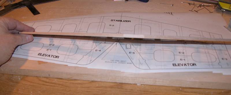

The stock horizontal stab weighed .8 oz my replacement weighed in at 1 ounce without sheathing, but with carbon fiber spars joined into the balsa root and rib arrangement. The holes you see in the photo attached, were to drip ca into the wood/carbon fiber joint to bond them and harden the balsa contact surfaces. The horizontal stab like this was much more rigid and resisted twisting much better than the stock assembly. My built up assembly was than sanded to a taper at the wingtip and will then be sheathed with 1/32 inch balsa.

Bob,
The main reason I built the horizontal stabilizer like that, was to distribute the strength of the stressed skin across the span of the tip to balance the load forces of the elevators back into the fuselage from the tips. Those wingtips of the horizontal stabilizer are only 1/8 of an inch thick so no way to embed t nuts in there. The structure I built was to be able to lose the external tail braces while adding airfoil structure to the tail feathers. I have the glue drying on one part of the skin that was applied to the stab tonight and am headed back to the workbench after this came out to get a cup of coffee.

I had hoped to be a lot further than this but i had about four versions of the tail group drawn up before committed to build this version. Rather than use counterbalances and increased span to increase the elevator area i have decided to go with a longer root cord, which should increase control response, because of the increased area and the fact that this will move moment arm back just a bit also. While keeping the major portion of the span of stab and elevator closer in to the roll axis.
