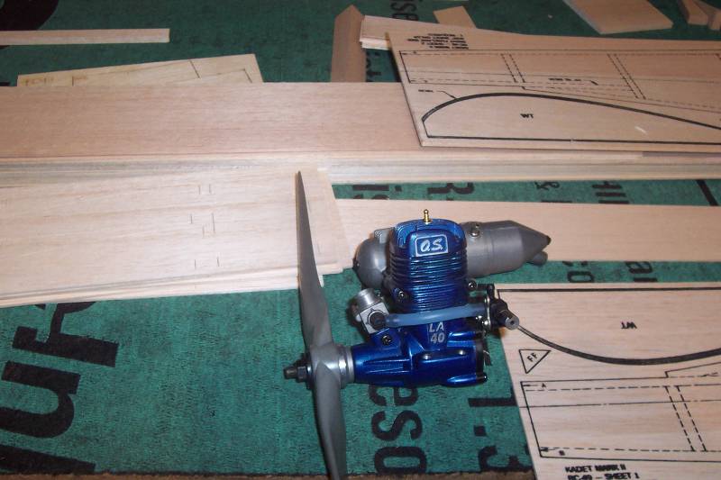

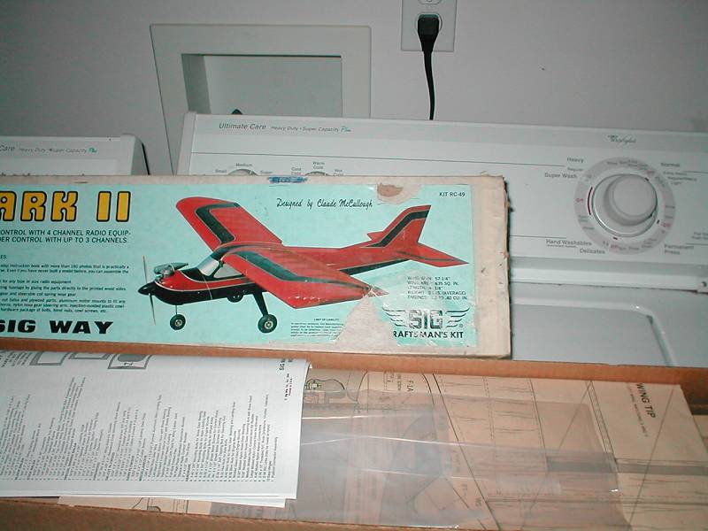

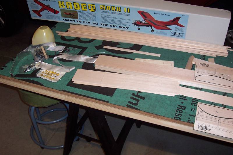

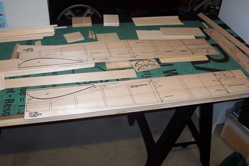

Hello everyone. I have been flying for about a year now and have decided it is time to experience taking flight of a plane that I have built instead of an ARF. So I guess lets get down to the nitty gritty . First off my name is Joe. I have no knowledge of building a plane but the Sig looks like it will be one of the easier of the planes to build because of the instructions they give you to build. Soooo with that said please feel free to give me any ideas or suggestions that you make have.
I will post pictures as I go along. So for the first few I have here are what came out of the box. The engine is an OS LA 40. I got it at a Swap Meet for $30. I have not started it yet but the compressions seems fine. So I am keeping my fingers crossed that it works and I can put it on the plane. i am thinkin about using blue covering with gold trim.
I would like to put lights on the plane but I'm not sure if I want to mess with it since this is my first build. If anyone has any suggestions, again please send me some ideas on what to do with the lights or where to get them and how to hook them up. Well I look forward to chatting with you guys.

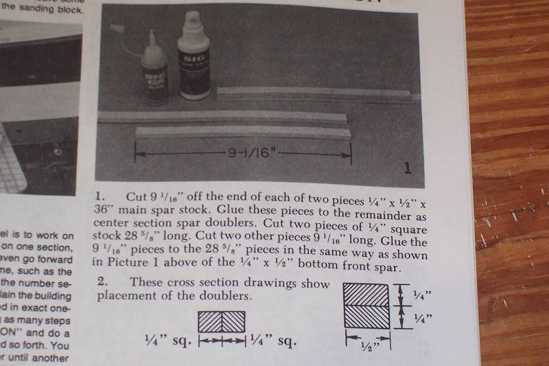

I will start of with the first question.
How do you cut the pieces out. Do you use a exacto knife or what?

Hi there glide03: The very first thing to do is read and understand the building instruction sequence. Next I would do a parts inventory to make sure the kit is complete. Then depending on the type of wood, choose either a bandsaw for llite ply, or a new #11 Xacto blade for balsa. It helps to have a self healing cutting board to use when cutting out the parts. Before starting the parts cut out, label each part to be cut out with the part number if it is not already imprinted. After the parts are all cutout, mount the plans onto a fiber building board(Lowe's calls this stuff "sound proofing board), and then cover the plans over with wax paper.
Following the instruction manual, start building the first part. It would be a good idea to inspect all the wood pieces that this first part is made of for strength, and choose the strongest sticks available to build it. There maybe some very soft building materials that could cause a structural problem when stressed during a flight. A trip to the local hobby store could replace any questionable weak balsa, etc pieces. I use 'T' pins to criss cross stick pieces when building built up stabilizers, elevator, and rudder. From this point on you move through the instructions building piece by piece. I have found Harry Higley's 'GETTING AIRBORNE VOLUME II to be very helpful in building a model as well as all of his other publications. The older RCM FLIGHT TRAINING COURSE manual by DON DEWEY also a great reference manual to have.
Get back to us as your construction progresses.

I'm looking forward to your build thread. This was my first R/C kit, and a good flying plane. I highly recommend building it with ailerons (4 channel). As far as cutting parts goes, get a good exacto knife and supply of #11 blades. Single edge razor blades are also good. You need a very flat surface to build on, a hollow core interior door is cheap, lightweight and portable. You can stick pins into it, but using the above mentioned acoustic tile on top of it is great, the tile is easily replaceable when it gets boogered up as you cut, glue, etc. When you mark pieces from the plans, always cut on the outside edge of the line and then sand the pieces to fit as tightly as possible. The tighter the joint is, the stronger it is. The old woodworker's adage "measure twice-cut once" is all too true.
Make yourself some sanding blocks. Take a plain pine board, 1x3 works great, and cut it into several pieces about 6 inches long. Use spray adhesive to glue sandpaper to one wide side, allowing the paper to fold over onto the thin sides, and use a different grade of sandpaper on each one; I recommend 80 grit for the coarsest, then 100 or 120, and 150 or 180, and then one with 240 and one with 400 for very fine finishing. These sanding blocks are great for shaping and fine tuning pieces.
Another good tool to have is a metal straightedge. You can use it as a cutting guide and the blades won't damage it. A small carpenter's square is also handy.
Dry fit EVERYTHING to make sure they are correct before gluing, and read ahead several steps before you glue anything to make sure you're not going to "paint yourself into a corner". Above all, take your time, and enjoy the build.

grrrrrrr...OK i feel like an idiot already. I finally got to tart building my plane today and the first dang step I feel like I have messed up already. please help clear this up if you can.
step 1. cut 9 1/16" off the end of each of two pieces 1/4" x 1/2" x 36" main spar stock. Glue these pieces to the remainder as center section spar doublers. cut two piece of 1/4" square stock 28 5/8" long. cut two other pieces 9 1/16" long. glue the 9 1/16" to the 28 5/8" pieces in the same was shown in Picture 1 above of the 1/4" x 1/2" spar.
OK. now the 9 1/16 = 9 inches and 1/16 of an inch correct?
