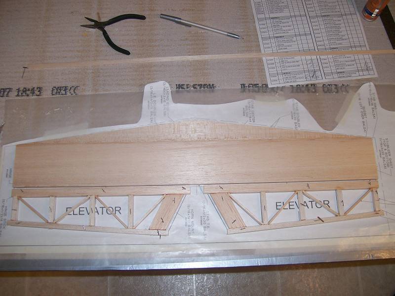

I purchased this kit a while ago and finally have it started. I'm going to power it with a OS .91 4-Stroke. I'm going to make a couple of mods to this build.
1st - Enlarging the rudder by one inch on the bottom and on half inch on the top. I'm also going to make the top cut out section (not sure what that's called) a bit larger than stock.
2nd - Reinforce the landing gear attachment points in the fuse.
3rd - Purchased a fiberglass cowl from fiberglass specialties.
The first steps are to build the horz stab and elevators. The stab is sheeted while the elevators are left open.

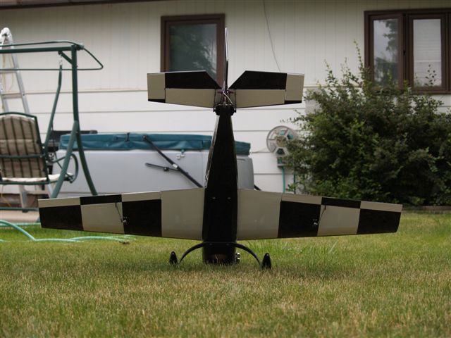

This is an awesome plane
I can't say enough good things about it. I have a YS 110 on mine and the tank on the CofG.
I did modify the stab/elevator and when I build my next one, I will build larger ailerons!
I love this plane!

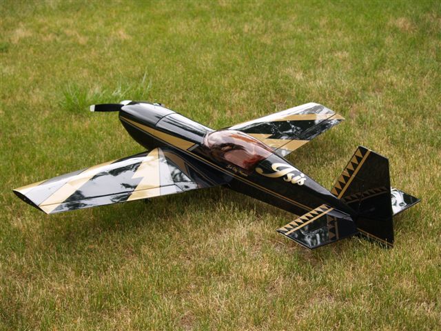

I finished mine about a year ago. Powered it with a Saito 125, modified the tail feathers with extra width and counter balances. Fiberglass cowl, pants; sullivan tail wheel. I also mounted an elevator servo for each elevator half in the rear of the plane. Pull-pull on the rudder.

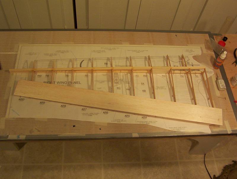

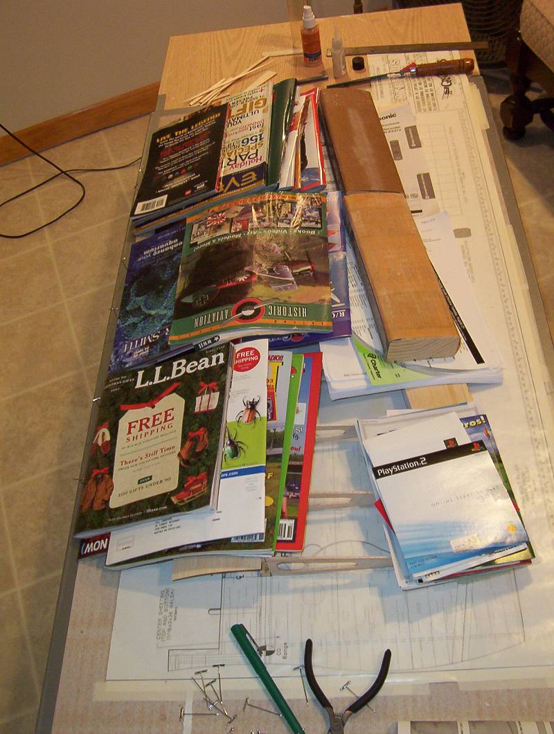

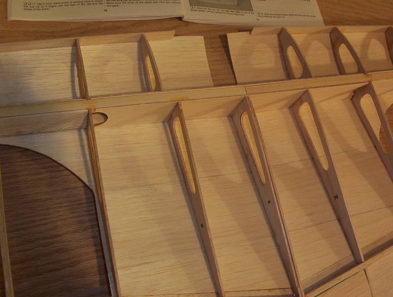

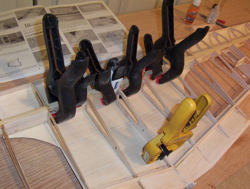

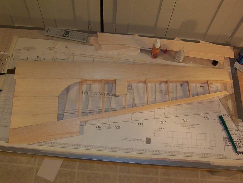

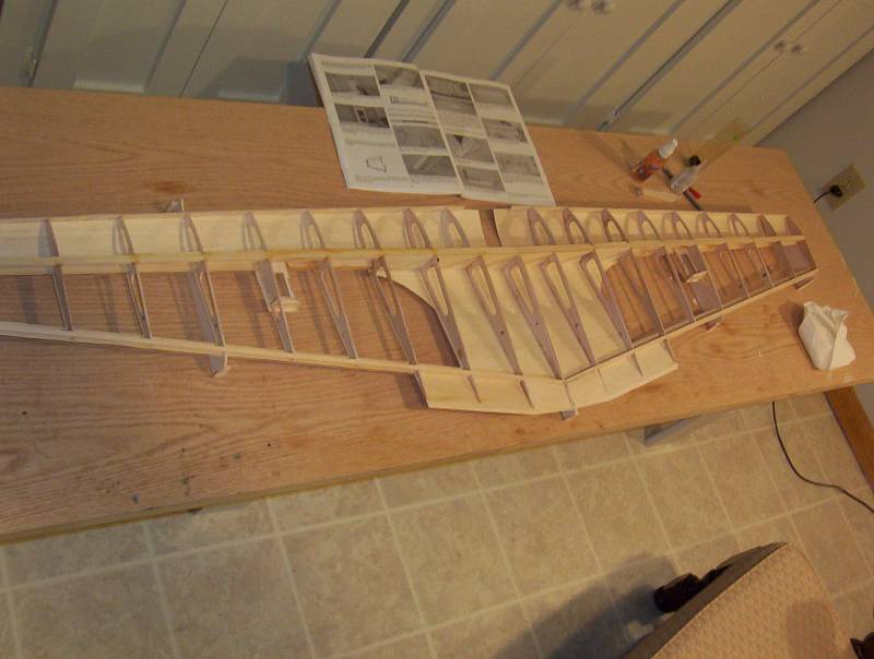

I made some progress on the airplane. I've got both wing halfs built, sheeted, and joined. For the sheeting I use magazines to hold everything in place while the medium CA dries. The joiner is just 2 pieces of light ply that sandwich the spars on each wing half. The joiner is glued using 30 minute epoxy.
The balsa that came with the kit for sheeting the built up ailerons is too light and flimsy so I'm going with some stronger wood when I build them.

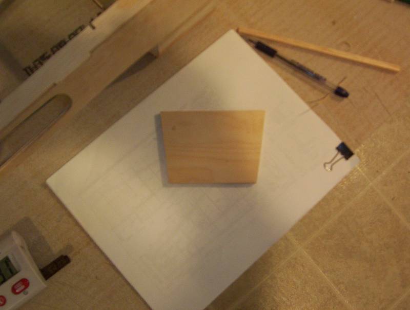

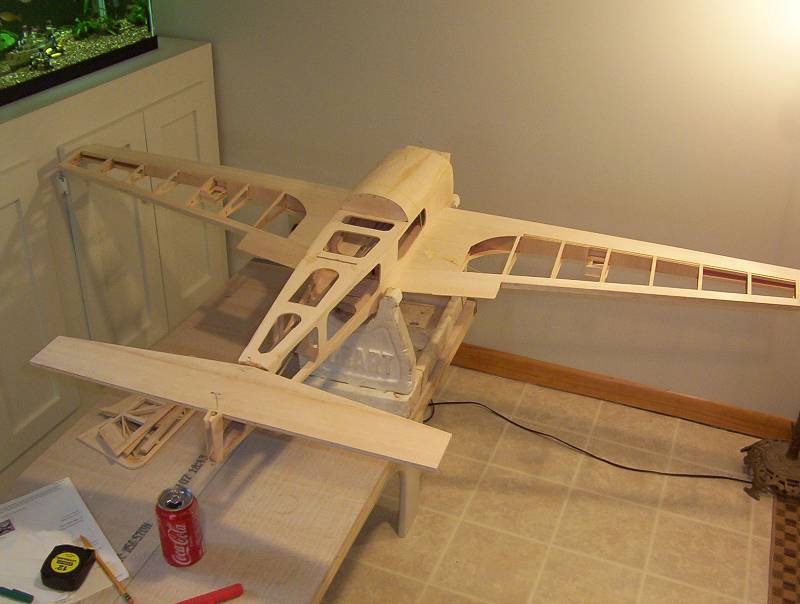

The wing is done and sanded and now I'm moving on to the fuse. The instructions say to draw a straight line on your building board and build the fuse upside down on this line. Sounds easy enough!

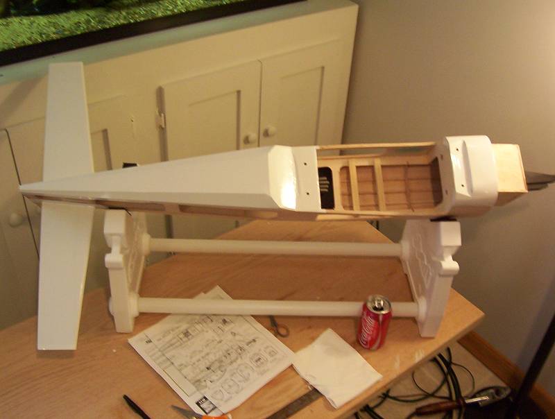

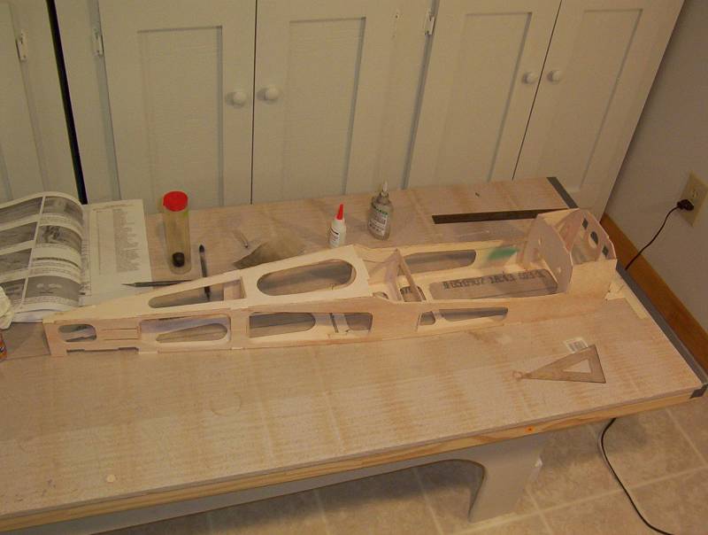

Another pic with the fuse sides and bottom added.

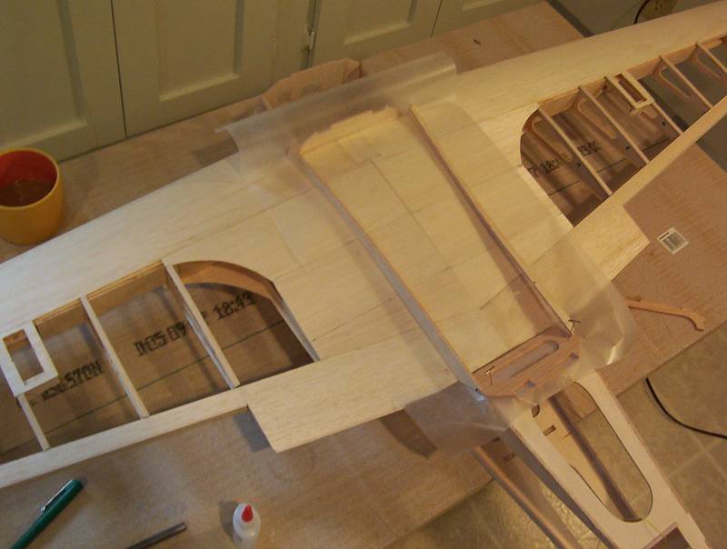

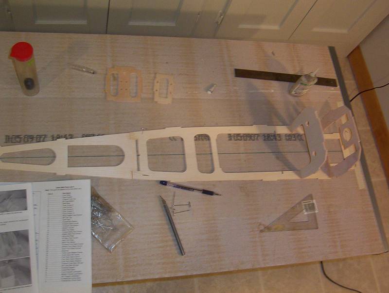

This picture shows how to attach the wing and build the belly pan. I'm surprised the belly pan is not sheeted. I hope I don't stick a finger through the monokote when handling the wing.

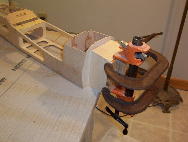

After the wing is mounted nice and straight I built the engine box and firewall. The firewall is epoxied on to the box but the box is only CA'd onto the fuse. I added a number of reinforements where the box attaches to the fuse so it should be strong enough.

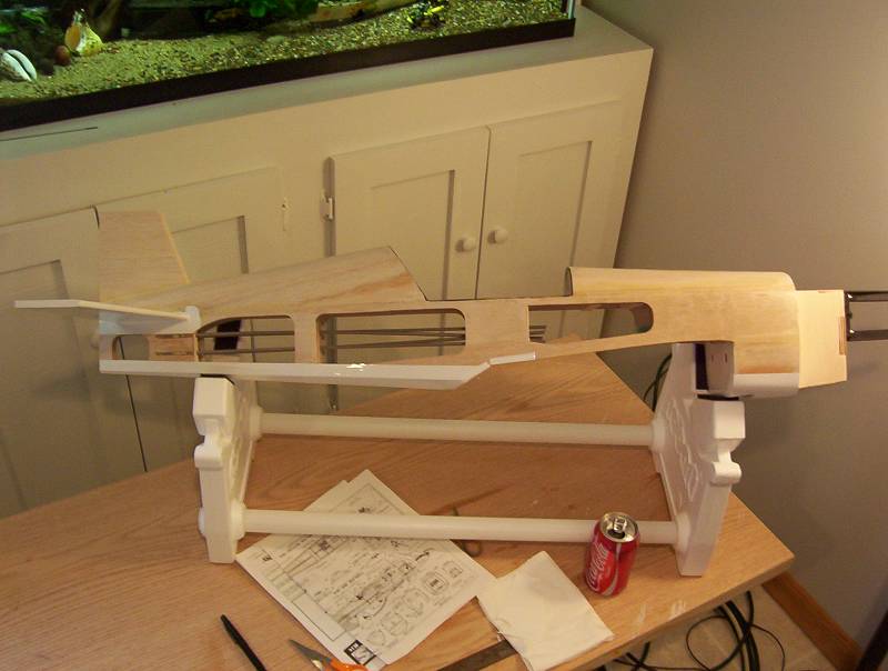

The firewall and engine box are completed. Next is to install the landing gear rails. They fit into slots in 2 of the fuse formers and into the engine box. I beefed this area up by adding a 1/4 inch piece of ply that fits on top of the landing gear rails and fits snug between the formers. Instead of using the screws to attach the landing gear I'm going to drill and tap to 1/4 x 20 and use plastic wing bolts. The bolts will break before the landing gear rails rip out of the fuse in case of a poor landing.
Here's a pic of the 1/4 inch ply I used to reinforce the area.

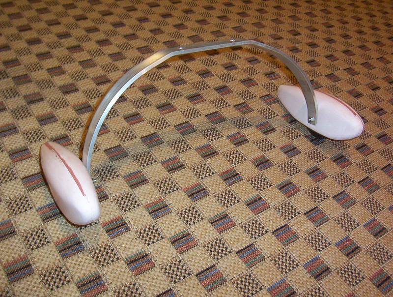

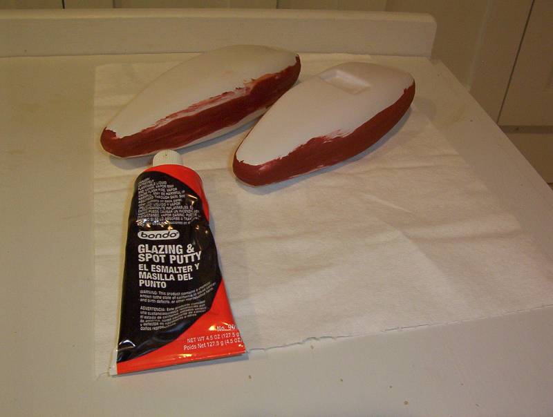

The landing gear attachment area is done and I won't be able to get blind nuts up in there. I have a number of airplanes with landing gear attached that I have drilled and tapped 1/4 x 20 into at least 3/8" thick ply hardened with ca and they havent stripped out yet. If I do have the problem I will certainly add blind nuts. I've also never boiled the plastic 1/4 x 20 bolts. Will look into doing that in the future.
I'm going with the supplied ABS wheel pants on this airplane. They were fairly easy to get together using ca on the 2 halves. I then used Bondo brand glazing and spot putty for the seam. I have at least three coats of the glazing putty on these pants as it does shrink as it drys.

I've got the rear turtle deck completed and am now starting to cover the fuse. The first part I cover is the bottom.
