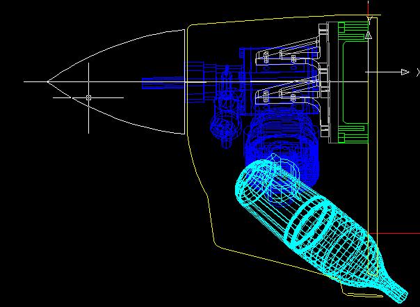

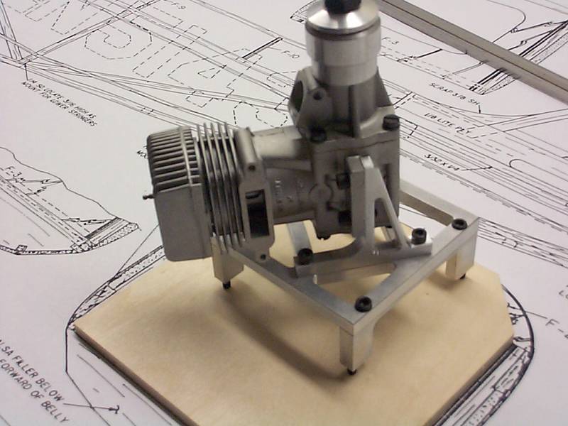

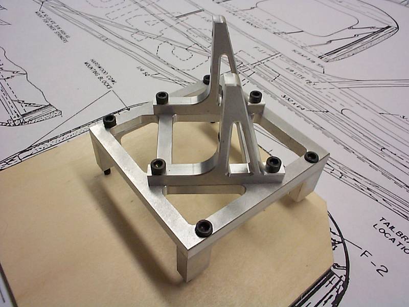

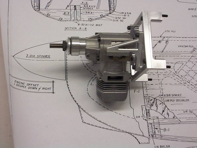

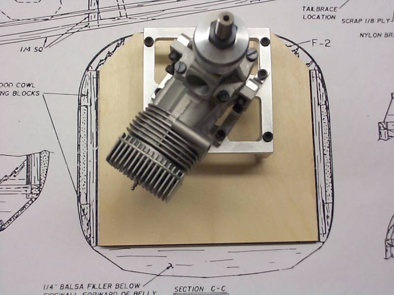

    I started out with the Motor Mount. This way I can get the firewall drilled and have it ready when the fuselage goes together.
    Having access to a CAD program and a little mill time helps me add another dimension to my building efforts. Question is will it pay off in the finished product?
    Pictures 1 & 2Using a CAD program I found a way to rotate the engine and mounts so that I will not have to cut any holes in my cowling if I choose not to. By the way, 35Β° from inverted.
    Picture 3I designed the engine mount with three separate sections (5 pieces) to allow me to make changes later on without having to remake everything. The center piece actually has the 1Β° down and 1 Β° right thrust machined into it. Later if I need to change thrust angles, I can remake this one piece and still maintain correct propeller and shaft location.
    Pictures 4 -7β€”Finished results.

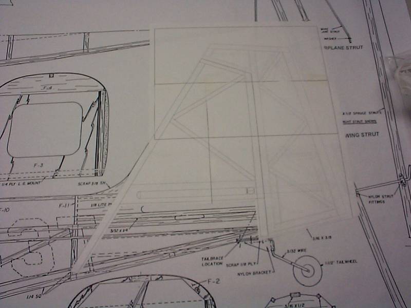

    I have been working on drawing my new rudder tonight. Unfortunately I don’t have anything to show yet. Ran into my first scale dilemma[:@]. On the kit, the hinge lines for the rudder and the elevators are the same distance from the firewall. (41 11/16”). On the full scale β€œPro” and all the other Citabria’s for that matter the elevator hinge line is further forward than that of the rudder. On the kit the rudder trailing edge stops short in comparison to the elevator trailing edge. On the full scales it is just the opposite. Which was going to work out just fine since I had decided to increase the rudder size anyway. Now I am looking at moving the rudder and vertical stab back or moving the horizontal stab forward.
    Thanks to all for the comments on the motor mount. (Kmot)[sm=thumbup.gif]
    Dave (acemcduck) I do appreciate the heads up on balance and handling. That lets me know, if I don’t go nuts with something everything should work out. Your 120 ought to drag her around pretty well. Good luck with yours as well.
    (TRJ1) This is my first attempt at doing something scale. I think this plane/kit lends itself well for getting some scale experience.

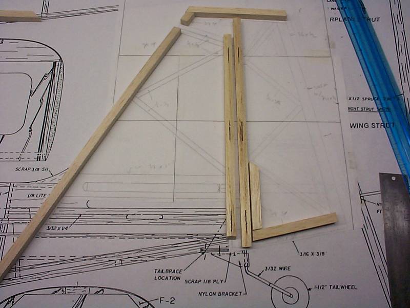

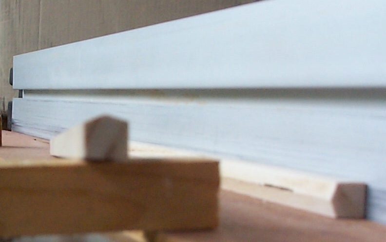

    I decided to add 1/2” to the rudder (front to back) . Pictures show the original and the new. Not a whole lot of difference. I am going to redesign the elevator/horizontal stab as well. The hinge line for the elevator will move forward about 1 inch. The counterbalance for the elevator will be enlarged as well to bring it more into scale. This will reduce the area of the stabilizer bringing it more into scale of the full size. It should help with aerobatics, albeit I will loose a little stability.

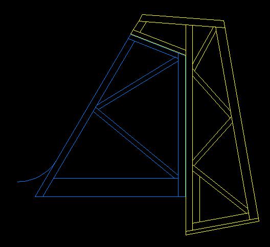

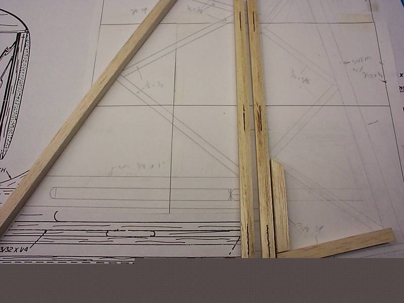

    I have run into more detail problems in the "scale" department. [:@] I realized that on the model, the horizontal-stab/elevator are positioned a too low on the airframe. To be scale, they need be about level with the top of the fuselage. So, I will try to move that as well.
    I will post some pictures to illustrate. I’ll stick a couple of Citabria pics in for grins and looks.
    The redesign of the tail feathers is about half done. But, I have to say, I thought I would be cutting and gluing balsa by now.

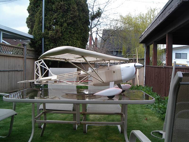

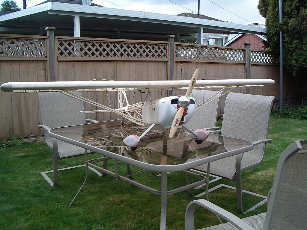

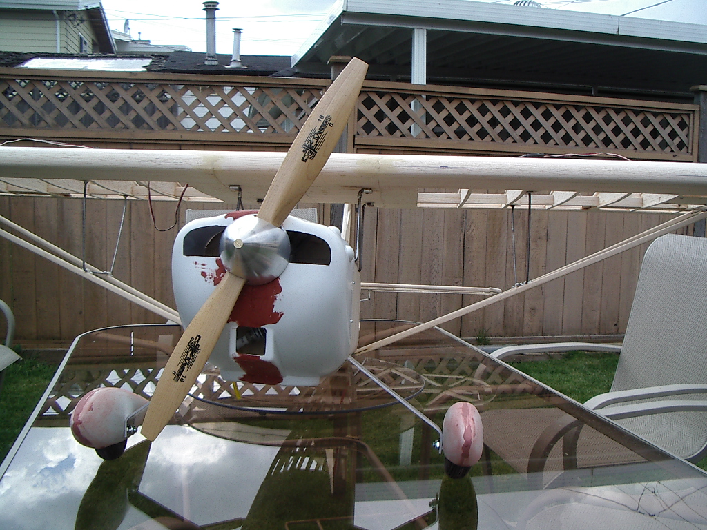

    Hey Rick, I'm looking forward to watching your progress, I recieved one of these kits from the family this Christmas, and started building it a couple of months ago, I have just started to apply my covering today, got most of the tail feathers and all control surfaces done so far. I am using coverite 21st century fabric, and pretty much going with the design on the box, as I'm not feeling all that creative at the moment.
    I had it all mocked up last weekend with all components installed except the covering, I was really trying to build as light as possible, but it still came in at 11.5lbs before covering, so Im estimating it to be about 12.5 lbs all done. It was quite nose heavy, I think in part due to the engine being a little large, I went with the SPE 26cc gasser which runs great and should, be a nice engine for this plane. I ended up installing the reciever battery about half way down the fuse and the ignition battery as far back in the fuse as I could this resulted in balancing perfect without adding any extra weight, hopefully the covering wont throw it off too much. I had the same problem as a lot of other builders on here with the incedence although I measured from the plans my wing appears to have about 1 or 2 degrees negative incedence, I'm going to put my incedence meter on it to check it once I find it, (Ijust moved recently and still cant find everything), even though the plans say not to, just to see what it says, I'll fly it as as is and make adjustments if needed as long as I dont slam it into the ground that is!! I'll send some pics on another post.
    Remember Taxiing always leads to flying!! & what goes up must come down.

    some pics

    heres some more

    Here is a summary on the changes I will make to the tail group.
    Vertical stabilizer size and location unchanged. Trailing edge stock will be extended down to become part of the tail post of the fuselage. The leading edge stock will extend down to the bottom cross member of the airframe. These changes are in an attempt to regain strength.
    Rudder as previously stated has been increased front to back by 1/2 inch.
    Horizontal stabilizer/elevator assembly has been raised 5/8 inch and forward 1/8 inch.
    Horizontal Stab will be shorter front to back by 7/8 inch (along the base of the vertical stab). The length from center out has been shortened by 1 1/8 inch. Therefore increasing the elevator counter balance width by that much.
    The size of the elevators will go relatively unchanged. However the profile near the rudder will be changed first to fit the vertical stab by coming straight out and then to allow for 35Β° rudder deflection. Almost twice as much as called for.
    My changes will certainly make the tail brace wires and absolute requirement. I’ll post a picture of my changed tail feather drawing placed on top of the original plans.
    Now it should be time to cut and glue a few sticks of balsa.

    I finally learned, if at all possible, it is much easier to do hinge slots before building the control surface. Once I got all the rudder and fin parts and pieces cut and sanded to length I set up my small drill press with a piece of aluminum bar clamped to the table as a jig to hold center spacing for drilling .050” holes in the 3/8 square stock. I drilled were the hinges will be… spacing my holes about 1 1/2 times the diameter of the bit. I then used the trust worthy ole hinge slotting tool to finish the slots off. Drilling the holes took more time but it made the job with the slotting tool so much easier. All in all I am sure I saved time and the quality is much improved. If there is a better way I sure hope to learn it soon.
    Now, for the bevels on the hinge line of the fin and rudder. I am sure these are not scale. But, the sure look nice when finished. The bevels are 17 1/2 Β° per side per rudder and fin. This will give me a max of 35Β° rudder travel in each direction.
    You will not find this set-up for the table saw in any textbook. You must be really careful and you must be confident with your table saw to be doing this. I little hobby type table saw would be much better. My problem was the slot for the blade is much too big for working with 3/8 stock.
    1drill press set up
    2&3-table saw set-up
    4&5 bevels for the hinge surface
    6&7-hinge slots

    If you are building or have built one of these, you are familiar with the pieces that make up the elevator tips. The tips are built up with six pieces of 1/8 die cut balsa. This consist of two different parts spliced together and stacked three times (Picture 1).
    I changed the ends of these parts slightly (picture 2) to adapt to the design changes I made to the elevator and stabilizer (earlier post).
    I replaced the middle set of 1/8 balsa with three newly shaped pieces of 1/16 birch plywood spliced. (picture 3). The black lines on the plywood show were the splice for the ply is.
    The intent here is: 1-to offset the spliced joints for strength… 2- the plywood through the center line like this should provide for a little more resistance to hanger rash… 3rd- more a side effect versus intended it will thin out the tips that 1/16 of an inch. Of coarse they will be feathered in to the 3/8 leading edge and the 3/16 trailing edge.
