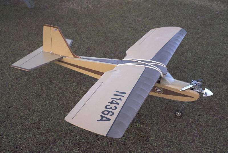

Very interesting. I'm starting to wonder when my first Senior might have actually been built. It's definitely not a metal mount. I might have to take some shots of the mounting and post here for posterity.
I've heard all the oohs and ahhs about having a large engine on the plane and when I first got it, there was a 50 Saito on it. It flew around fine. Funny thing though, it was only after I put the 91 OS 4-stroke on it that I started to have folks say that they've never seen a plane fly so slow. Yup, SLOW.... Just cuz it's there, doesn't mean that you've got to have it full throttle all the time. Folks still talk about my first Senior at both of the fields that I frequent and not about how fast it goes. They talk about its stability and smoothness, even when puttering around the field.
I'm thinking of doing a build thread on the build up if anyone might be interested. It will have a different slant to it as this will be my first kit and it'll be a great way for my dad and I to spend some time. We'll see.

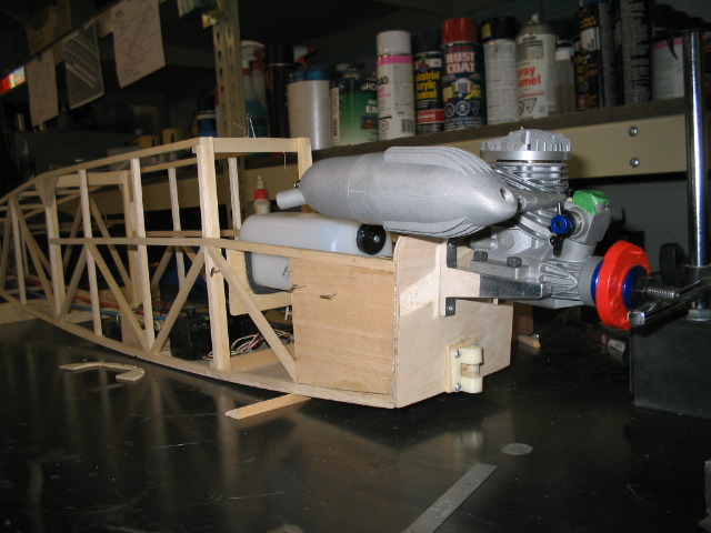

I was just over at dad's comparing the new kit with the original plane and I'm going to make a similar mount like what is on the old one. It fastens to the firewall and the sides of the fuse and is a sheet of ply, glued on three sides with a notch cut out for the engine and blind nuts underneath for the engine mounting bolts. I was wondering how I was going to beef up the firewall to help hold the engine but this seems to be much stronger becase it is mounted on the sides as well as the firewall. I'll have some pics as soon as I can but so far, this seems to be the best way to help hold the engine at bay. I really want to go with a four-stroke but those pesky SuperTigre 2300s are such a deal right now! Can you say hand launch!

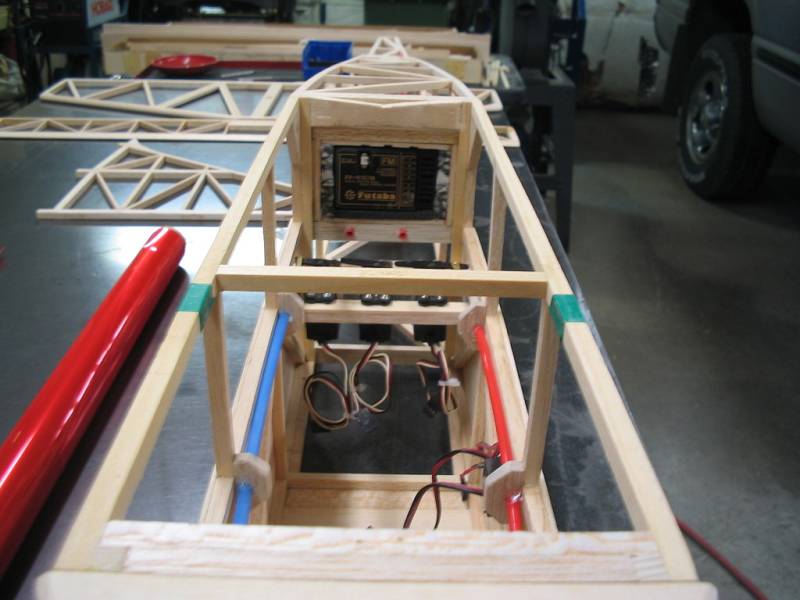

TCrafty knows where he's going [8D]. You can balance in some nose wieght easy. This thread has me doing some digging now for some of the build pics [sm=teeth_smile.gif]
I built in the radio gear on the aft side of fuse with a hatch below for batteries to allow for full area in the fuse for bombay or camera eqip in mind. Also cross braced the back of fuse top and bottom. Turned out that I had to put batts deep foward with wieght [sm=72_72.gif]. Could probably add camera gear in the place where I thought the batt would be and ditch the dead wieght up front [sm=spinnyeyes.gif]
flynte
