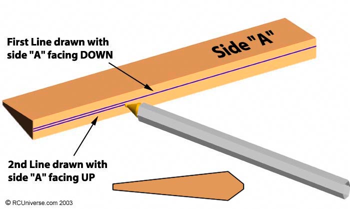

Also for my benefit what is the best way to bevel the LE of ailerons and the like?

First question: Razor Blades, Sandpaper, Razor Saw, Drill Bits, Sanding Block, Standard Hand Tools.
As for sanding a bevel, I start by laying the control surface flat on my bench. Lay a straight-sided pen on the bench as well. The ball-point of the pen should come close to the center of the hinge line, but you don't want it to be perfect - add a sheet of balsa under it if it is not close to center. It doesn't matter if the pen is higher or lower than the center, as long as it's close.
Now, keeping both the pen and the control surface flat against the bench top, draw a line on the face of the control surface.
Flip the control surface over onto its other side and repeat the process. This will give you two lines which are close to center.
Now bring the control surface to the edge of your bench, hold your sanding block at aproximately a 45 degree angle, and snad until you reach the top line.
Flip the control surface over and repeat.

Balsa dust gives my sinuses fits. So I bevel like this. I mark a center line with a pen like Minn does. Then with a straight edge I mark another line 1/8" back from the LE on each side of the stock. (If you want more bevel you can do 1/4" back or whatever you need) Then with a razor plane I plane down each side to the line I drew. Then a little sanding with a T bar evens it all up. This is much faster and cleaner then sanding it all the way down. I have glued tri stock to the LE like someone else mentioned. This works fine just be careful not to get the hard tri stock. It makes it difficult to hinge.

I cheat. I glue a triangle strip of balsa to the flat "leading edge". Perfect 45 degree angles,dead central,use aliphatic glue[bond tite].
Takes about 30 seconds,haven't had one fail yet.

The next most important tool on my bench is the one that does a perfect job of beveling aileron stock. The Master Airscrew Razor Plane. Mark a center line on the stock. Hold the razor plane at the desired bevel angle and make full length passes. Count the strokes and stop short, do the same number on the other side. Now touch up as needed. It can't be beat.
