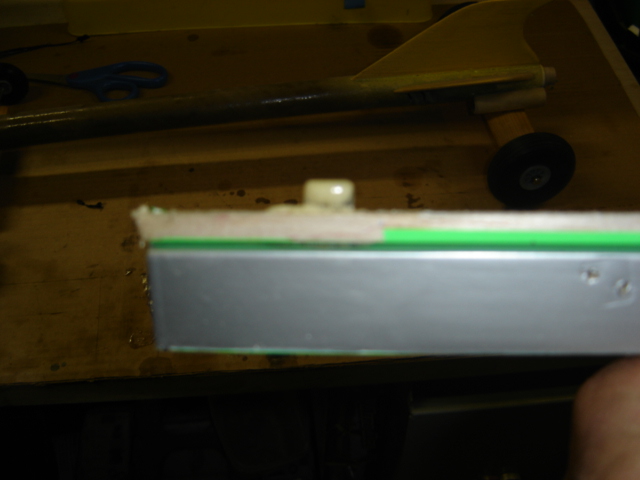

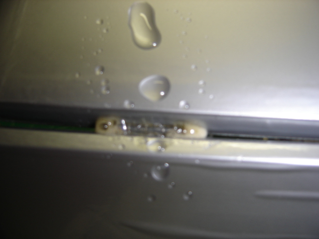

I use the dubro hinges mostly. I take a paper punch an put a large hole in the center that intersects with many of the smaller ones already there. Then fold the hinge in half to dip the actual pivot point in melted vaselene incase glue gets in there. The biggest diffrence is I use gorilla glue or similar for the hinge. When it kicks off it foams into the large hole forming a rivet and not requireing pinning.
Most of my planes are racers or for high speed. 160 hasn't hurt this type of hinge at all.
Covering for a hinge works fine on small models as already mentioned.

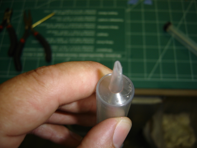

Alex,
I use a syringe. I heated the end to make it flat, then filed it down a bit to allow it to squeeze into the slot.
Clean-up is pretty simple wipe most of the unused glue from the body and put a small wire in the bottom followed by spritzing some water in there to make it kick. When it dries just snap it out.
The plunger needs to be wiped clean with paper towel. I've been using the same syringe for about two years or so.
The glue will foam out of the slot as it kicks off but won't stick to covering or the hinge with vaselene on it. I use pliers to snap off the big globs and a pointy awl to chip out the remainder leaving a nice clean hinge.

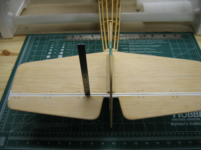

I made a jig that rides on the trailing edge. It's got a spacer and guide so the drill bit enters the trailing edge exactly in the middle. If you can use a pencil to mark the holes on the wing and aileron, you can't screw this up.
After all the holes are drilled, I also use a cone shaped dremel tool and run it in enough so the knuckle of the hinge has a place to sit. This is an important step if you don't want 1/4" wide hinge gaps.
I like to glue the hinges in AFTER it's covered. You ever tried to cover a wing with 2 ailerons flopping around? [:-] I usually just use an exacto to cut the holes after the parts are covered. The soldering gun works good too because it seals the edges as it melts the hole.
I glue one side at a time. I rarely try and glue the entire control surface onto the wing all at once. I usually glue the hinges into the wing first. Let them dry overnight and then put the ailerons the next day.
Alignment with Robarts is EASY. Put the glue in the holes on the wing. Slide all the hinges in. Set them at the right depth. I try and set the pivot point about 1/16" from the trailing edge of the wing. This gives a 1/8" hinge gap, which is fine for most 60-120 size birds. Slip the aileron on, but not all the way. Leave 1/4" or more in the hinge gap. Remember, you're only glueing the hinges to the WING right now. There shouldn't be any glue in the holes for the ailerons.
Here's the easy part:
Flex the aileron back and forth to full deflection a couple times. The Robart hinges will naturally swivel around and line up all by themselves. Nothing can bind up. Just flex the control surface a few times to full deflection and watch the Robarts turn to line up perfectly.
When it comes time to glue the aileron onto the hinges, Just drop some glue in the holes and slip it on. Flex to make sure there is no binding. If you did it right yesterday they will not bind. Slide the ailerons all the way onto the hinges and adjust your hinge gaps. Use blue masking tape to secure the control surfaces to the wings until the glue sets. Usually overnight. Next day, take the tape off and test them by flexing. Usually works pretty good.

Vicman, from the picture of the aileron the glued section is “beautiful” it makes the disadvantage of 1/4” TE into an advantage.
Maybe from the wing side you don’t need to secure it with toothpicks drilled through?

If you look at the pics I posted above you will see that I use a syringe and gorilla glue. Any polyurethane glue will work fine. I use gorilla glue since they have little bottles that seem to last longer than the big ones. I wrote a newsletter article detailing the whole process a little more but you should be able to get the idea from my previous post.
Alex, like I said most of my planes are for all out speed or pylon racing so they see some unique action and I haven't had any issues with this method. On most of my faster ships I seal the hinge with covering just for flutter insurance not so much for hinge integrity. I don't pin them either.
The CA hinges are a total pia and I never feel like I get the proper amount of glue on them. I've had them break over time and also seen many of them just plain old pull out, never a good thing.
I thought that pic would make a good point about how well it works. The glue does the same thing in a blind slot sometimes puffing up the aileron or whatever with the foaming action. You may want to use a credit card or something just to spread the glue around but it pretty much fills all the gaps.

Here are a couple of shots showing my hinging method. As you can see there is not much space within the hinge line...the 6" metal scale is held in place by the control surfaces. Have not had any come loose with this method.
EDIT: WOW!!!! My first photo uploads!!! It works....
