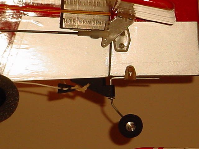

I'm building a Thunderbug 40 and converting it to a tail dragger. I'm using a halco gear for the mains and looking for different methods for the tail wheel. This will be my first tail wheel installation so should I use a free castoring assembly, use a more conventional assembly attached to the rudder like a sullivan or wire assembly glued straight to the rudder. Also will I need to increase the rudder size for this conversion, if so, how much?

Whatever system you decide, it's a good idea to make sure none of the loading from a heavy landing is transfered to the rudder. That is, don't support the wheel by attaching it to the rudder; just take a non-supporting wire, spring or cable from the rudder to provide the turning action.

Steve what you have is what I had in mind except clip the shaft right above the bearing, solder on a washer and let it free caster.

Steve I was a little worried about the tiller bar breaking out the rudder on those less than perfect landings. Maybe I'm just over stressing here! I think I'll just build it, fly it, repair it, and repeat as necessary! lol

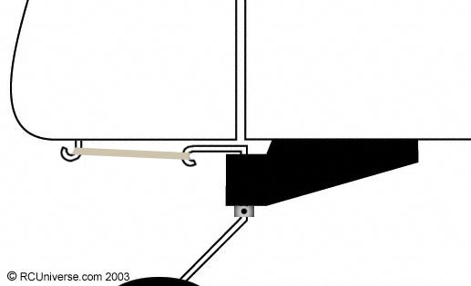

Here's a way, as long as you have a tail post that's substantial.
Drill a 1/8" hole, maybe 1.5" deep, from the bottom into the tail post, making sure it is parallel to the rudder line.
Fill the hole with thin CA. When it sets up, drill again. more thin CA, etc. You want to harden the tail post.
Then insert a piece of 1/8" brass tube in the hole and secure it with a drop of thin CA.
Make up a 3/32" music wire tail wheel wire that will slip into the brass tube. The wheel goes on the bent up end. Put a 3/32 wheel collar to act as a stop to keep the wire from going too far into the tube. Use a 4-40 bolt, maybe an inch long, instead of the set screw, pointing toward the rear.
The wire will now fall out, unless you take a section of fuel line, put one end over the bolt, now called a tiller bar, and fasten the other end to the bottom of the rudder with a pin or a screw. Keep the tubing a bit long to give some mechanical isolation between the rudder and the tail wheel. The wheel assembly will be held in place by the tubing and you have a steerable tail wheel!

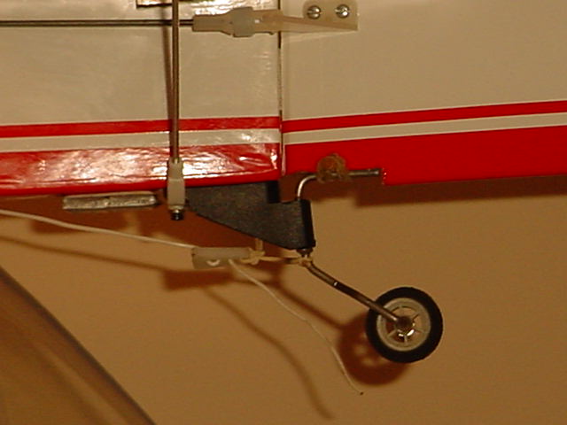

Tail Wheel Ideas
bearmech,
Take a closer look at those pix. There is a washer soldered on the strut that butts up against the bottom of the plastic bearing.
The washer takes all of the weight/impact loads and prevents it from being transferred to the rudder.
Dick's idea is neater and probably looks better; mine is the quick'n'dirty method...<G>
Steve
Steve

Tail Wheel Ideas
Steve
Here's what I have so far. I think the lower wheel collar will take the load. I plan to glass the doubler that the tail wheel bracket attaches to, and attach the tiller to the rudder like minnflyers pixs!

Tail Wheel Ideas
That tail wheel wire was salvaged from someone elses crash! The wire that came with the du-bro mount seemed to be to weak! It will get loktite on every thing at final assembly.
