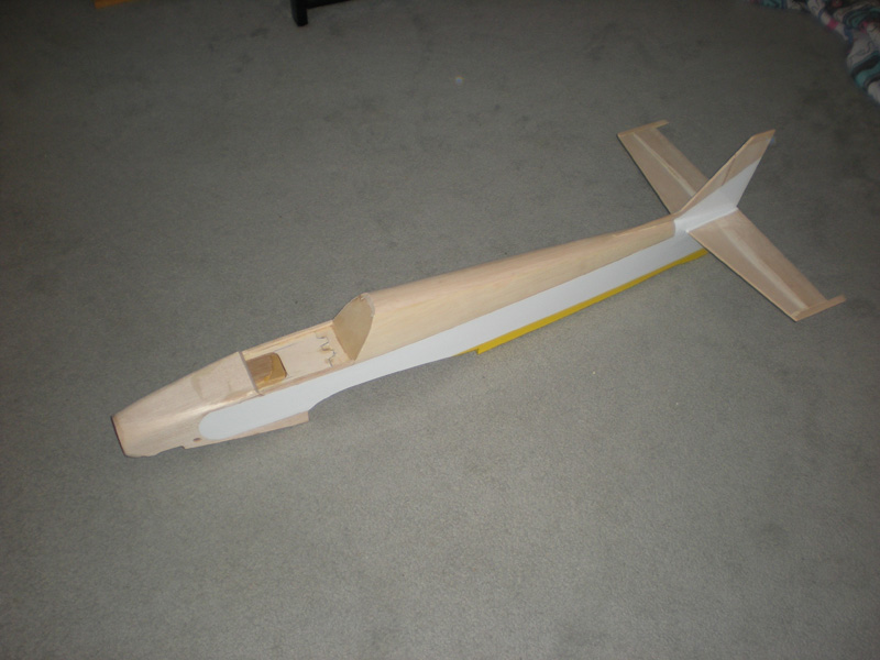

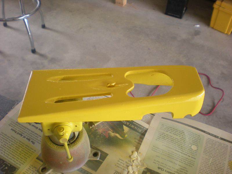

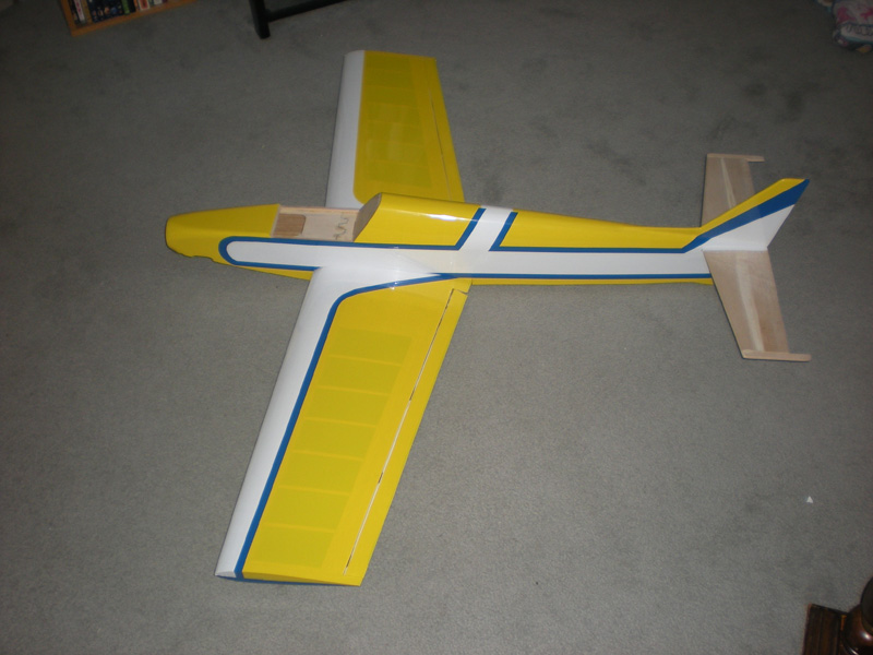

Cowl now has paint...... Came out pretty good I feel for never have using an airbrush before.....
Ready to cover now....

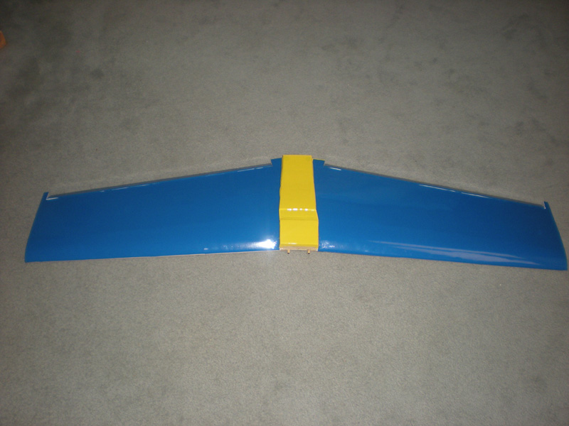

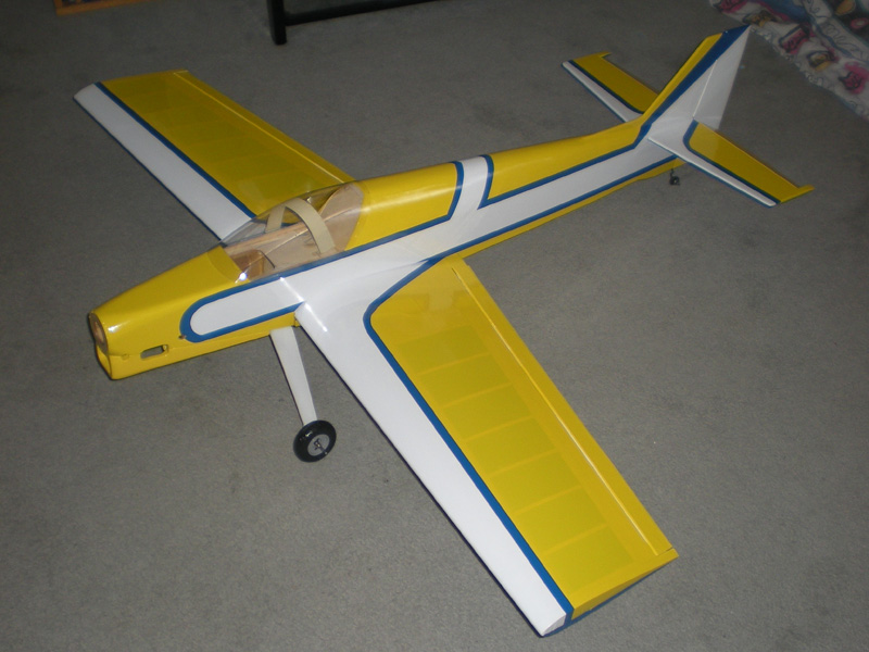

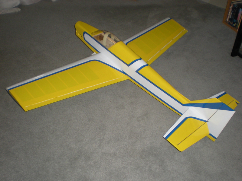

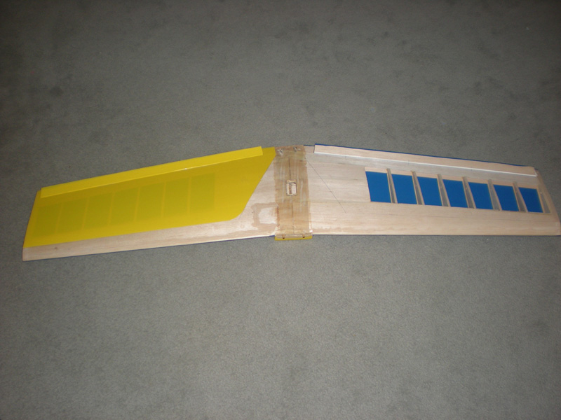

No updates for awhile as I've been covering it.
As this is an experimental type plane I didn't want to do anything too exciting for a scheme...... Well that got squashed in a hurry.
I'm really happy with the way it turned out though. I'm still deciding whether or not I whould put some epoxy on the edges of the covering to ensure it won't come off.
Just need to install the gear, rudder/elevator hinges, install cockpit and canopy then we should be good to go.

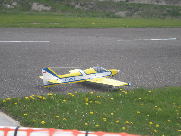

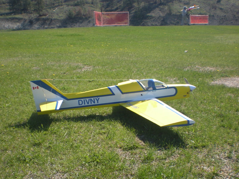

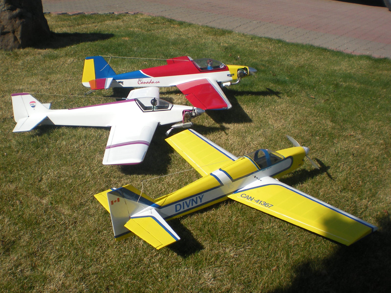

IT FLIES.....!!!! WooHoo...!!!!! [8D]
Took it to the field today with intentions of only running a couple of tanks through the engine. MVVS engines are known for long break-in time so I was quite surprised at the transition I was getting on only the second tank. Since there were only three of us there and the weather was pretty much perfect (light breeze - 15 degrees C) I couldn't resist.
I kept it to a very short flight (only about five circuits) so a full flight report will have to wait till I get some more time on it but I am VERY happy. That was easily my best landing so far this year. I couldn't be happier.

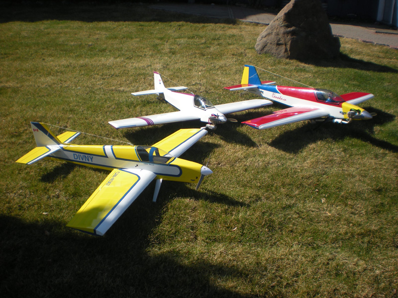

Couple pics at the field and a couple of my fleet of Ultrasports.

Great to hear...!
Congratulations!
Looks like a nice fleet you've got started there...
Hopefully your next flights will be just as rewarding.
Congratulations!

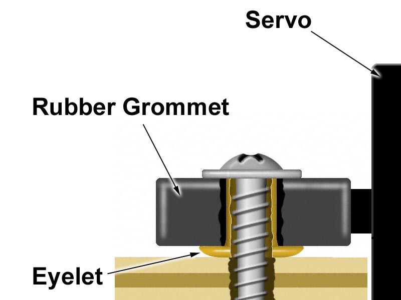

Hi Cdallas,
Great looking model you have there, and an interesting modification you have made.
In post #4 it looks like you may have the servo mounting eyelets upside down in two of the servos. My understanding is that the rounded side of the eyelet should be against the servo rail. This allows you to tighten the servo mounting screws without the eyelet biting into the wood and crushing the rubber grommets. If the grommets are crushed they cannot do their job of insulating the servo from vibration.
My apologies if all this is old news.
Happy flying,
Dave H
Happy flying,
Dave H

RE: Ultra Sport 40 Kit Bash
ORIGINAL: gerryndennis

My Feedback: (16)
Back in the 90's there was one manufacturer saying that the eyelet flange should be on top so the sharp end could dig into the servo tray and help lock the servo into position.
So my old ones are done that way and I have not changed them. I have never had any trouble with them.
However, in the last ten years I have been putting the eyelet flange on the bottom. No problem with that either.

I've done it that way for eons and never had a problem but if you look closely one of the other servos has them on the bottom. I don't think it really matters, what does matter though is they are not overtightened and squished. That would be bad.

Hi Cdallas,
Yep I did notice that one of the servos was the other way round. I think you hit the nail on the head, as long as there is no squishing you'll be fine.
W8ye, I remember a manufacturer having it the other way round as well. I could never work out how the sharp end digging in a bit would make the servo any more secure than having a great big screw through the eyelet would, so I just went with what the other manufacturers were saying.
Minnflyer, Thanks for the diagram, makes what I was saying more obvious. Thanks also for the great Ultra sport threads, you have inspired me to take the plunge. I have the RCM US 60 plan and Great Planes canopy to match.
Anyway I don't want to hijack the thread any further, Cdallas have you managed to do any more flying with the swept forward Ultra sport? Have you noticed any differences? Did you need much nose weight to balance with the changed CG? Is a Moistened Bint, lobbing a scimitar, a basis for a system of government?

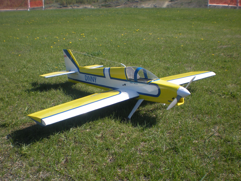

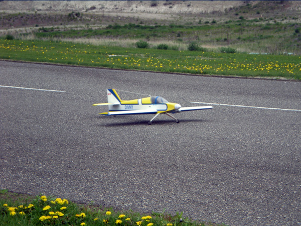

Updated flight testing......
Alls well and I couldn't be happier with the results. I had some issue with flutter on the 4th flight but afterwards was found to be my error (didn't pin the hinges) rather than the plane itself.
I now have 7 flights on it and I'm now going to go into a trimming program. I originally thought the CG was too far back but after further flights I've decided to leave it where it is. It requires very little down elevator while inverted.
It handles basic maneauvers with easy and suprisingly snaps and spins pretty well. Stall turns are very nice (that huge rudder sure helps) and I'm still very suprised at how easy it lands compared to my other Ultrasports. Was looking at it's slow flight charectristics today as well and I was very impressed. During stall it would just sort of mush down rather than having any kind of seperation.
My daughter took some flights pics today so I included some of them. It's only a Nikon point-n-shoot so it's hard to get much better than we did.
