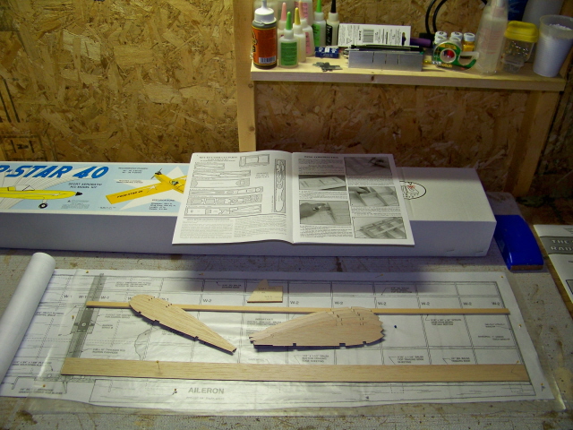

All,
I am starting yet another project plane. I have decided to build the classic Sig Four Star .40. I have an extra Super Tigre .40 motor in my shed almost brand new and beggin to fly. First I guess will that motor be enough to pull her around? Also please chime is whenever you want with suggestions and most importantly some pictures.
Thanks Mark
Thanks Mark

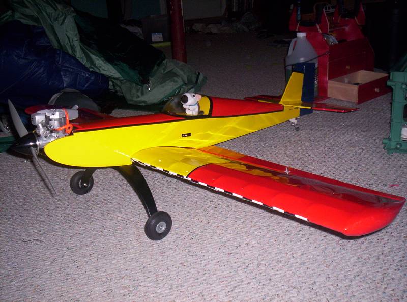

Hey Mark
I'm just finishing up mine. I did a cowl and enlarged the rudder. You can see my posts here
http://www.rcuniverse.com/forum/m_85...tm.htm#8614971
let me know if you have any questions. I may be able to help a little

Looks good! Making good progress. I doubt you will have to enlarge the elevator, but after having enlarged the rudder, the elevator looks a little small (if you look at the pics). I might have made it bigger just to match.
If I had one change to make in mine, I would do DUAL ailerson servos. Maybe mini's. It just doesn't seem like they are very free moving the way it's set up and probably just as much of a pain to do it the way the plans say, as it would be custom mod 2 servos (1 in each wing).
I sheeted the turtle deck and I think it makes it look much better. I would seriously consider sheeting at least the leading edges. the only problem is having it taper down to the ribs (the tough part, not sure how to do it), and the weight. Probably a copule ounces, so not too much consideration.
All this being said, the plane is supposed to fly great out of the box. You probably don't HAVE to change a thing, and it will be a very fun flying plane. BUt if you WANT to give it some personal touches, there's some ideas

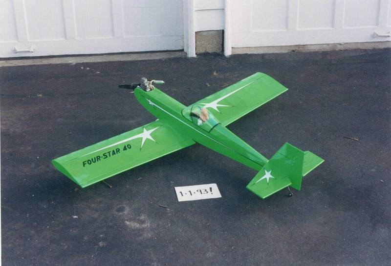

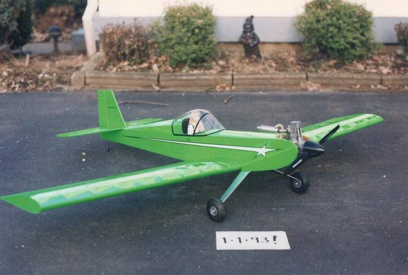

I built a Four Star .40 about 15 years ago. It was the most "perfect" plane I'd ever built. I had a week's vacation that my wife didn't have, and I spent every day in my workshop eating peanuts, drinking an occasional brewski and building! Great vacation...really!
I flew it for over a year and then allowed someone to talk me into fast charging my RX battery to fly one cold November day. On the second flight, the battery quit and I took it into the ground full speed.
I really liked that plane! OS .48 Surpass for power.

That thing DID look perfect. Looked like the box model! Nice work
Love the pilot! Was she a naughty nurse doll or what?

I originally built mine pretty much stock, with a .46LA, and it took a couple of ounces on the firewall to balance. I rebuilt it over the winter with larger control surfaces, sheeted turtle deck, balsa wingtips, heavy duty landing gear, and a .55AX, and it balanced with no lead and the battery behind the servo tray.
I was really worried that I was ruining a perfectly good plane with the mods I was making. I probably added about a half pound of weight and about 50% more power to it. I am really happy with the way it now flies, though. It holds a knife edge great, and it has unlimited vertical, but still lands nice and slow.
I thought I loved it when I first built it, but now I REALLY love it. It is just a great model no matter how you build it.

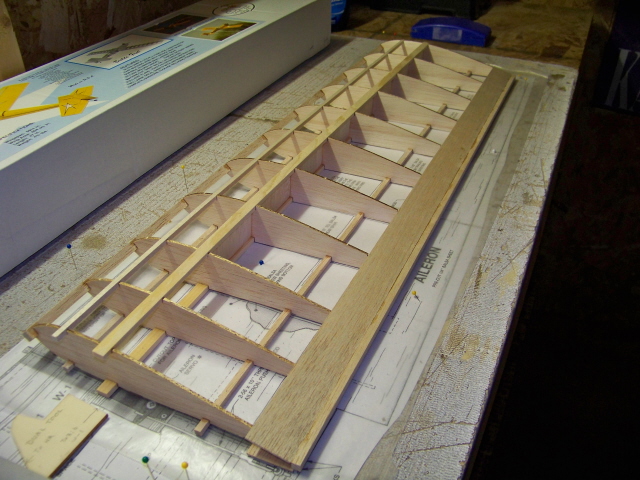

Hello All,
I have actually been working on my Four Star but I have been having a few cpu problems that seem to be fixed now. Anyways here is what I have gotten done the last couple weeks.
I was able to get the wing 100% minus covering. I decided not to go with the dual ailerons no reason just did not. Probably should have but I have no worries about the handling anways.
Anyways please stayed tuned for more progress.

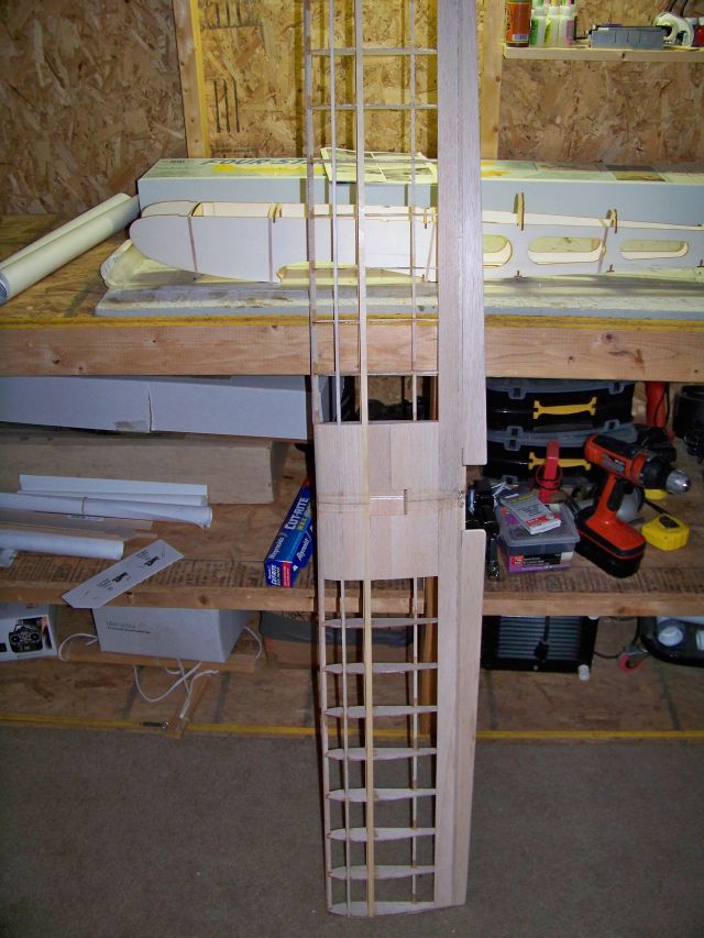

Me again,
I also started on the fuselage. Let me say that this probably the easiest kit I have seen ever. All the parts are laser cut and fit just like a puzzle.
Anyways here are a couple pics of what I have gotten so far. Any suggestions of ideas would be great.
Also by the way I am going really cheap on this plane but would a Super Tigre GS-40 for 49.99 be enough power for this plane. I know it will pull it but will I be wishing for more. I am not looking for 3d just normal roll ands loop are fine. After all the take offs and landings are the fun part anyways right.
Let me know what you think.
Mark
