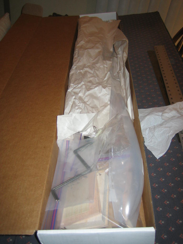

I recently recieved my kit from Bluejay Airplane Kits. I'm planning to build it to the instructions and install an OS61 FX. Other than that the details will evolve.

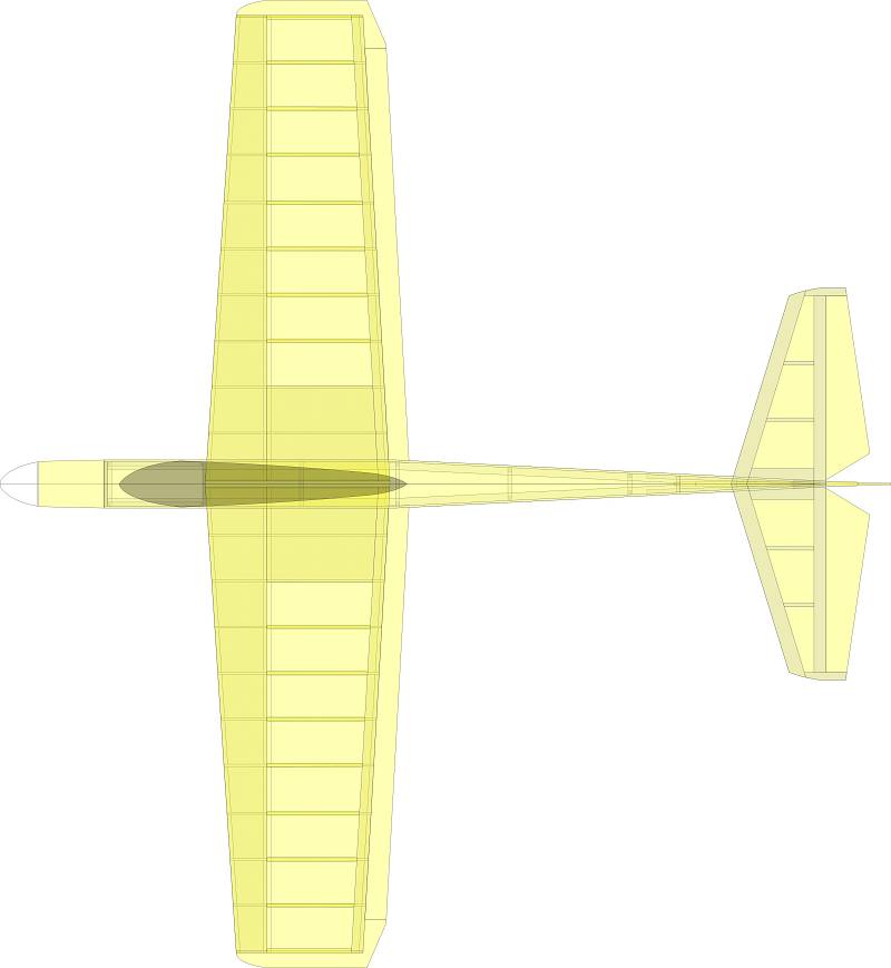

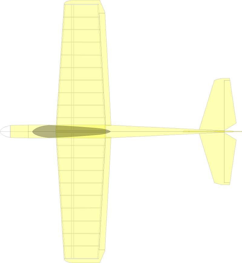

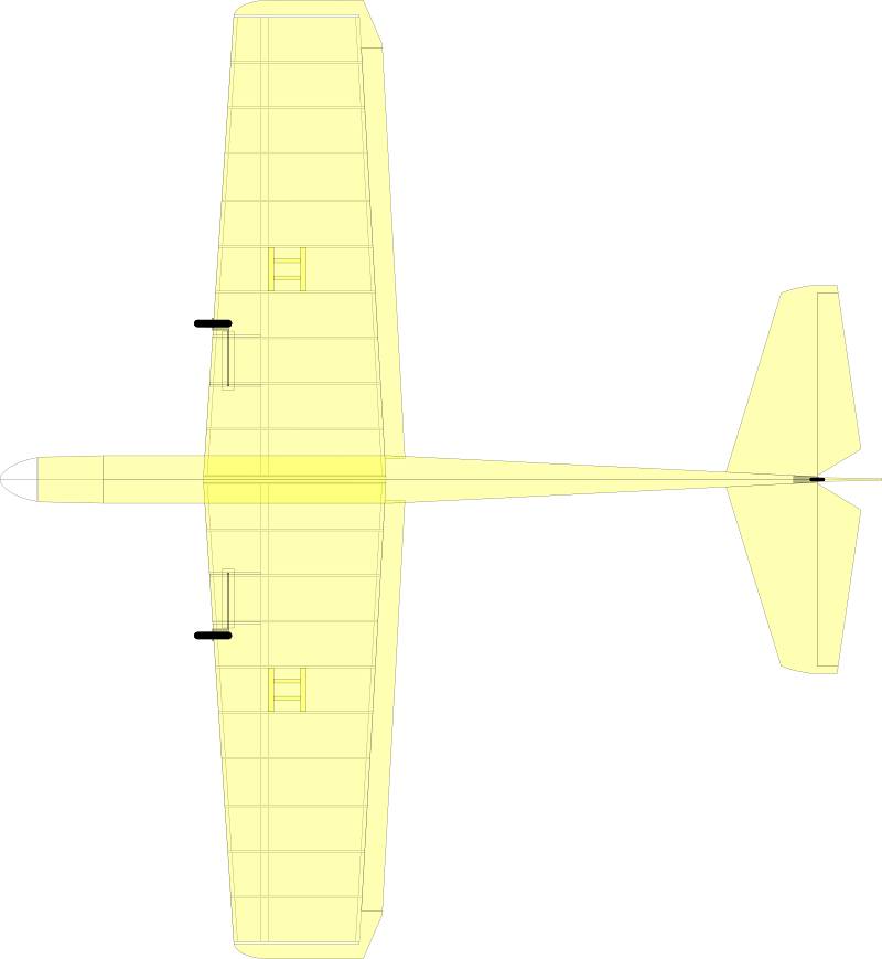

The attached pics are jpg files generated by Visio. As the instruction manual has no pictures and there a quite a few details missing from instruction manual I figured that by building a pretty detailed drawing in the Visio I would start developing a better understanding as to what it is I'm building. So here they are:
Btw, these structural pictures are withing 1/8" of actual plan dimensions &proportions.

I've wrapped up the structure diagrams of the Killer Chaos. I think that I now have a clue as to how this puppy is structured!

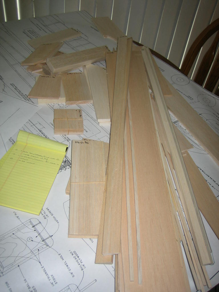

I'm in the middle of doing a parts inventory labeling all the wood to make it a bit easier (RCKen's contribution to my "best practices"). Figuring what gets tossed, what gets replaced and what wasn't included. So far there are maybe 3 pieces of long balsa stock that needs to be "reshaped". Pretty soft stock. Also, not sure where they go so assembly may just absorb the bends (at least they are 1-way bends, nothing with compounded twists).

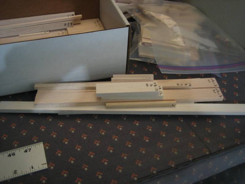

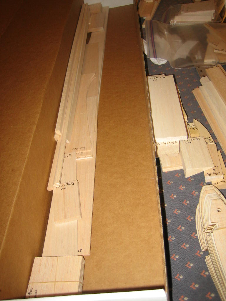

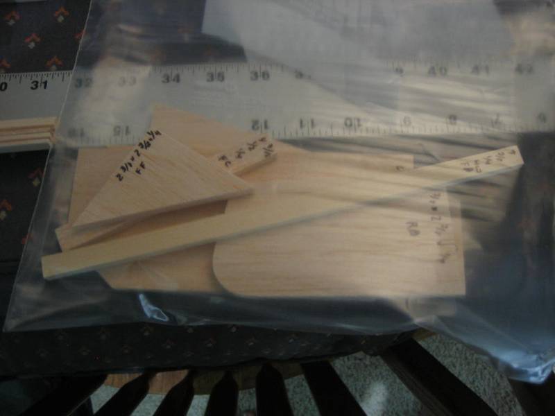

I've finished doing a physical inventory on the wood & accessories. Each stick / block of wood has its measurement and an acronym that ties it back to the instruction manual inventory list. The pieces were segregated into 5 groups: fuse, cowl, wing, horizontal (tail) & vertical (tail). Each was then repackaged into the box waiting for me to check out my glue inventory.

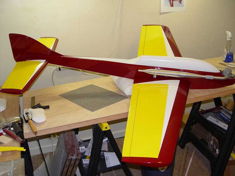

RE: Bridi Killer Chaos 60 Build Thread
Tim - I'm IN LUST!!!! Nice lookin' air-o-plane.
Truth be known, I got the idea from the XLT on Bluejay's site. Just wanted to walk before I tried to run. Didn't want to stumble into the retract world quite yet.
Who did the exhaust? When you say "I used an OS FX" I'm assuming the .61 (based on some displacement limit?).
Ok, I'm doing my homework. Macs Products header with a tuned pipe? Em, beginning to understand some of the comments that pattern planes can get to be pricey little pieces of art.
Join Date: Jul 2003
Location: SeaTac - Angle Lake, WA
Posts: 1,057
ORIGINAL: SeamusG
She moves pretty damn fast through the air and seems to have an unlimited verticle. OR it atleast feels that way. She'll run out of sight if I'd let it. IT does awesome 400'+ loops and tracks straight as an arrow. It makes me look good with the way she tracks through the air.
I'd build another one in an heartbeat but commited to building a new Ultra Sport 1000 that I recently purchased. Quiet a project but will be fun....

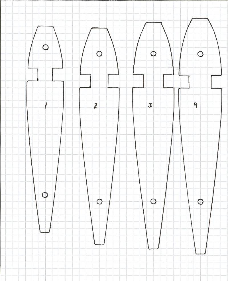

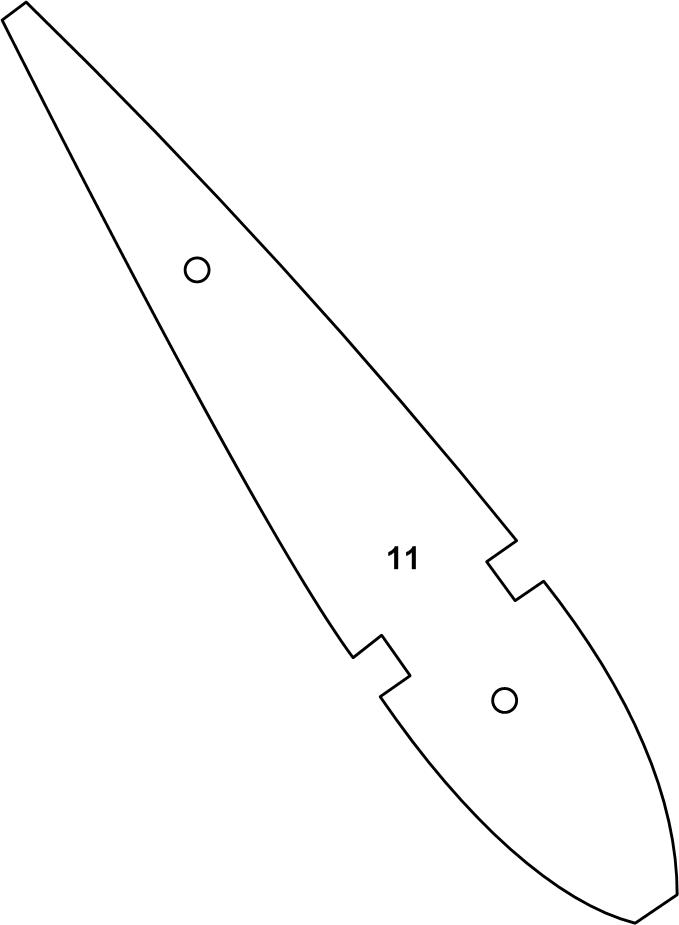

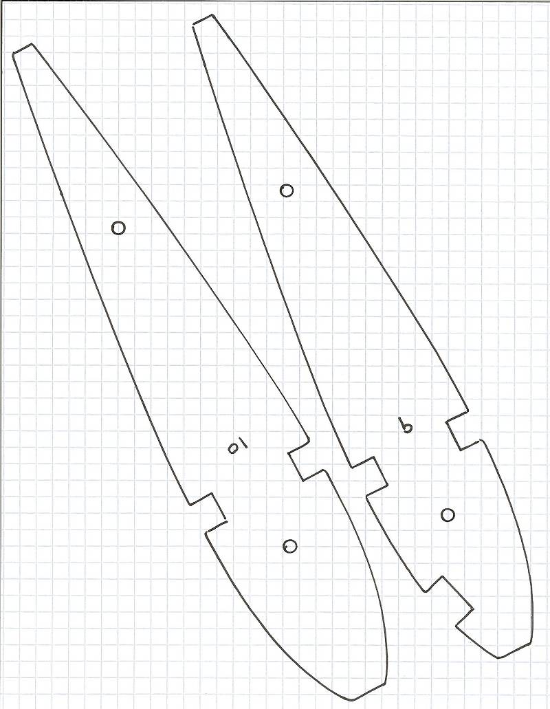

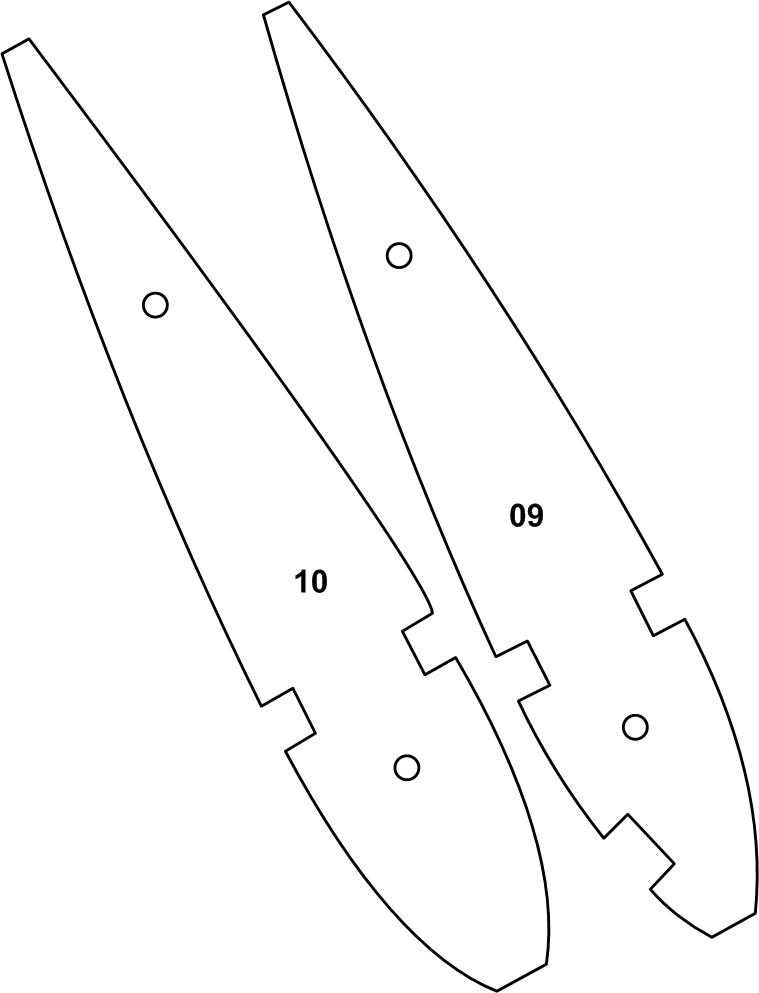

Hi Joe,

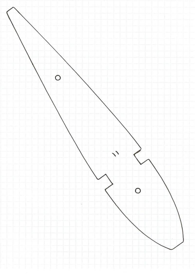

Here's the stuff ya asked for.
Firewall front surface to the leading edge of the rudder (or trailing edge of the fuse) is exactly 47"
Wing centerline to outside of tip rib is 30.5" (or outside dimension of L tip rib to R tip rib is 61")
Wing tip treatment is a carved block that is 1" wide.
pic 1 - ribs 1 thru 4 from tip
pic 2 - ribs 5 thru 8
pic 3 - ribs 9 and 10
pic 4 - rib 11 (root)
The first set is the traced images on graph paper. The second set is after importing to Visio & adjusting the perimeter lines "inside" the traced lines of the traced images.
Cool thing about Visio - it can calculate areas & perimeters at the touch of a button.
