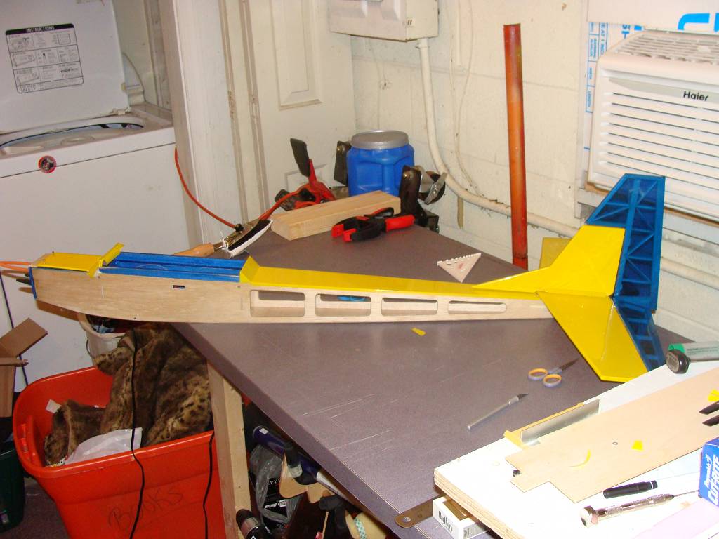

I have desided to go with bright yellow ultracote on top of fuse, tail and strips on under wing. Transparent blue ultracote on sides of fuse, elev. blue, rudder blue, bottom of fuse yellow and about 5in. yellow on wing tips.The wing will have yellow at the root ribs where sheeting is, then blue all the way till tip of wing where yellow is. Thought that might help make it easy on me with nice straight cuts. I think my son wants to add some army or navy sticker as well since it is his plane!
Old 10-01-2009, 12:16 AM
  #62
ejam
Join Date: Nov 2007
Location: Williamsburg, VA
Posts: 337
Default RE: Dynaflite Butterfly build

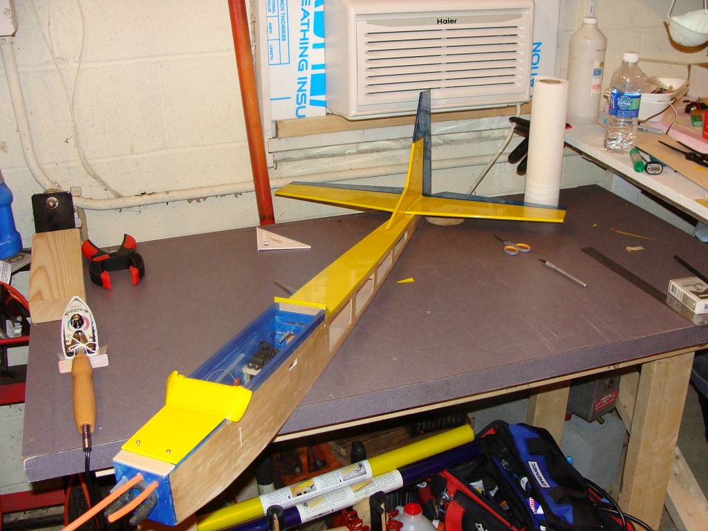

Here is a picture of it as of this past weekend. Tail is coverd and strating the fuse.

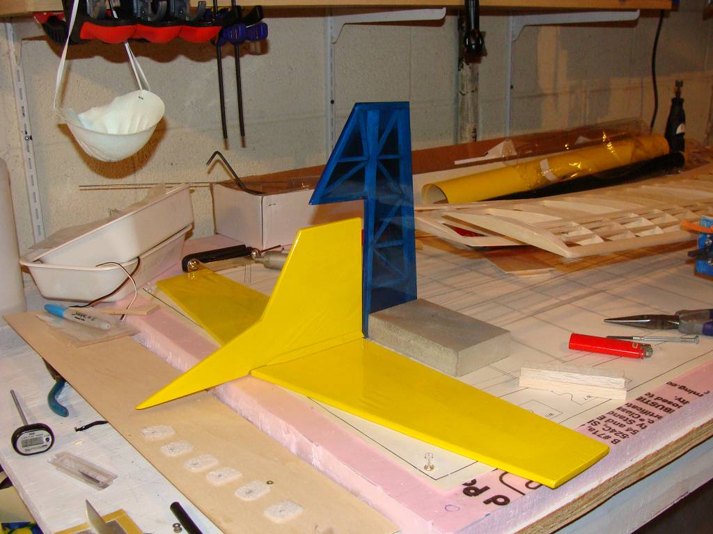

Picture update
ID:	1286633   Click image for larger version

Hey, thanks. Im getting a little better with covering as I go along. Yes temp is your friend. It is very important knowing what temp is. On my iron, there is no numbers, so I used my digt. therm. to find the right 220 for Ultracote. Then after it has all adheired to wood, set temp higher,about 235 and run over again to take wrinkles out.
My covering is not perfect, but is getting better!
I am thinking about adding some web pieces to the outer wing panel, and maybe sheet the two outer rib areas to make it easier to apply the yellow covering at the tip.
