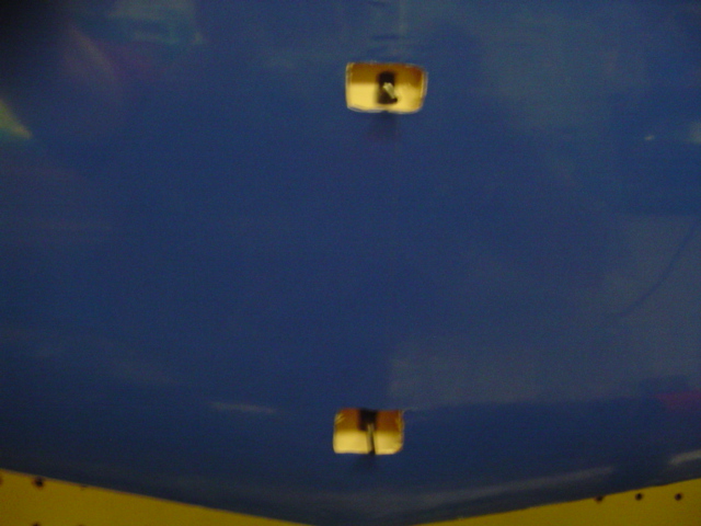

Tail mount servos are good for elevators. Go with hitorque mini servos though - my standard ones are overkill when you have 1 per elevator half.
I toyed with the higley top wing mounting mods - didn't bother apart from the guide tabs for the bracket that the top wing slides onto (a MUST DO). Properly done as higley suggests (like mine!) its robust. I don't use a rubber band I use electrical cable ties. Solid and will not break like a rubber band. They are so cheap you just cut it off when you need to remove the wing.

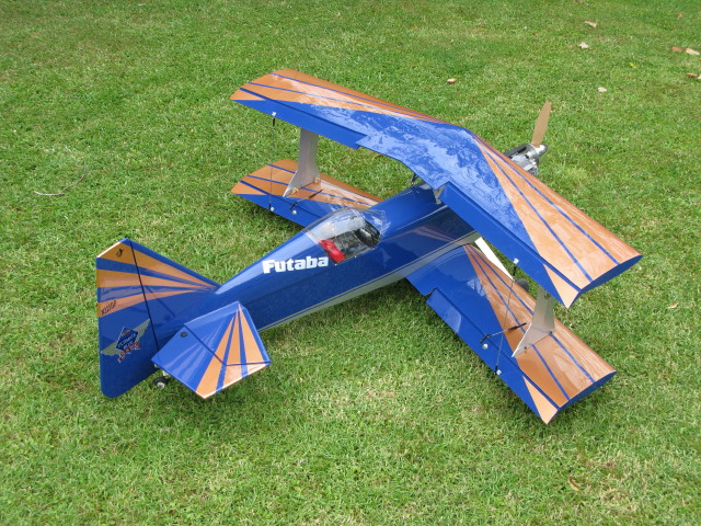

Nice plane fallingleaf....but why the paint stirrer for a prop when there are so many better, more efficient choices out there for equal money?

Chad that is one sweet Ult.

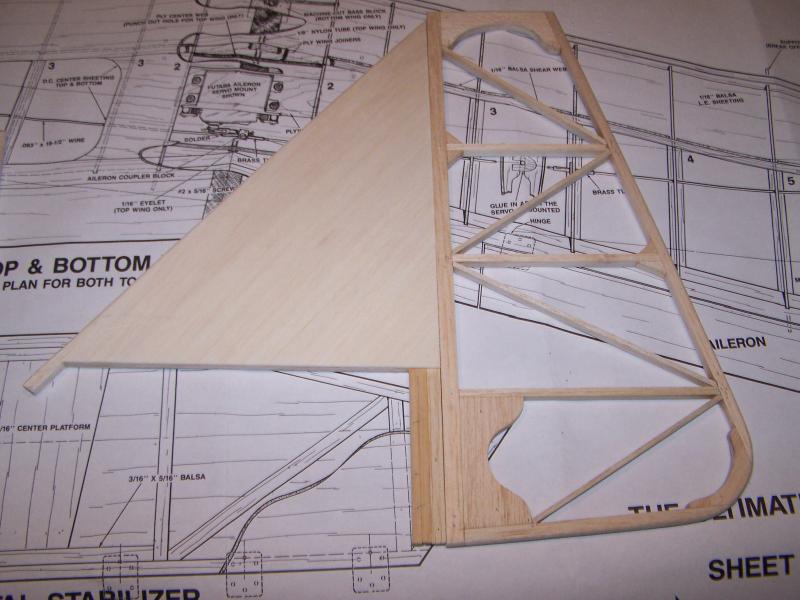

Some progress...
I went with the cf re-enforcement as I only used strips .007 thick by 1/4" sandwiched one on each side. the cf weighed about 3 grams total...
I lightend the stab where I could. I added a 3/16" square of bass wood on the trailing spar for added strength. The cf re-enforced stab is crazy strong. RevyMaxx can confirm how tough and the weight is only .3 oz more than his non-cf stab. Worth while I think...
With the fin I used the toughtest 3/16" * 5/16 from the kit laminated to 3/16" square bass to toughen it up more for the main spar. The rest is light soft stuff. The fin is tought like nails. Should stand up to massive abuse.
If any one is interested here is my final sanded weights:
I am using a digital food scale so it is quite acurate but the oz side only shows to the first digit after the decimal so...
Stab - 68 grams / 2.4 oz
Elevator Halves (both together) - 28 grams / .9 oz
Fin - 29 grams / 1.0 oz
Rudder - 26 grams / .9 oz

My buddy has a gb ulti and he found that over time the pin will wear through the mount, at least his did. He did the higgly cabane mod with much stronger aluminum and he STRONGLY suggested that I do it too with the way I fly. I'm just not hip with mounting the cabane outside the fusealage. I'm pretty sure I will reform new cabanes from thicker aluminum but I will mount them inside and just double up the fuse where they mount. I'm still not sure about going with the pin mount or a bolt mod.

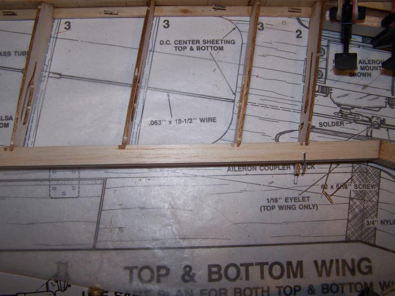

More progress... I beefed up the tabs on the plywood wing ribs as fallingleaf did. I did some lightening... The inital weight of the original plywood was 30 grams. The weight of the new 1/16 aircraft grade ply and cut out pieces was 80 grams not including epoxy, ya WOW & very noticable in the hands.
Final weight is 60 grams. It may only be 20 grams but it all adds up. With my gp extra 300s I manged to remove almost 1/2 lb from the airframe alone. I'm not going to worry too much about removing weight with this plane as the ultimate flies better with a bit of weight behind it. I'm hoping for 8lbs. My buddy in vernon has one at 8lbs with a [X(]YS140[X(] in it. It is awsome!

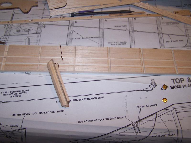

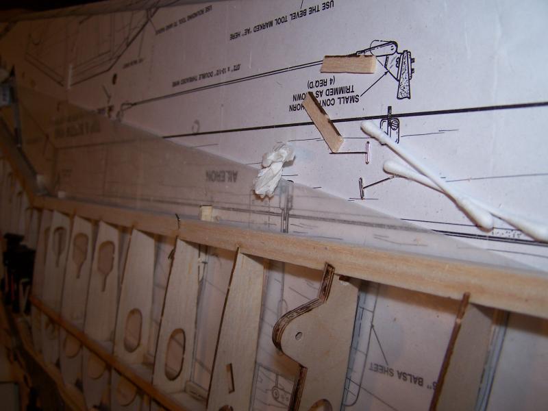

A quick update. I am much further along than this and i will get some more pics today and post them. I'm currently fitting the servos in via a plate as fallingleaf did. I'm a bit nervous with this method. I used basswood mounted on the end grain to the 1/16" aircraft grade plywood plates for the servo mount. I punched a bunch of holes halfway through the plywood and a good 1/16" in to the end grain of the mount and used some strong 30 min epoxy (warmed a bit to make it more runny to soak in to the hard plywood better) to attach. Punching a ton of little holes allows the epoxy to REALLY soak in and grab better. I hope it doesn't rip out in a hard blender or insane tumbles... I'm so use to hard mounting a servo to the surface of a wing rather than hiding it. I was just going to mount it this way but I wanted to try the plate idea for kicks.
Any how her are some preliminary pics of the wing construction. I moved the hinge line forward 5/16". I made a jig and pinned all the ribs together and removed the 5/16" from them all at the same time. They are all identical. This will give me a little more than 2" per aileron and should give that extra bite in a hover. I was going to cut the T.E stock down the 5/16" but I'm glad I didn't. The wing, even though is sheeted on the leading edge, is still somewhat flexible and I think that T.E. stock is adding to the strength of the wing. The weight of the bottom wing so far with all of the sheeting on and plywood plates in is 11 ounces. Still reasonable.
I noticed that the right side of the plan (on the wing) is actually 1/4" wider than the left side, lol. I wonder if the designer was drinking the day he drew these plans up. I had to re-cut the dados in the T.E. stock as they didn't line up to the plans. I pinned all 4 of them squared up (faster to do all 4 at once) and made a jig to do this with the correct angle for the ribs. You can see the sanding jig in the pic. This is when I noticed that the right side of the plan was way off. I corrected the placement of the ribs at the main spar so all will line up and is square. I will duplicate this for the top wing.
A bit of a bummer, the bottom wing has a slight warp. It sits up about 1/32" on the T.E. of the right side. I made damn sure all points were tightly secured when sheeting and I accounted for the removal of the 5/16 from the T.E. by putting a piece of that size back in so the sheeting jig would sit in the right place at the center of the wing. I'm not sure how it happened but I'm positive I can get it out when I cover the plane.
Sorry, I should add, I added 1/16" balsa to the top of the T.E. stock to bring it out to the height of the cut ribs and I will have to add 5/16" to the inner aileron stock that is glued to the wing. I don't have any 5/16 so I'll just laminate 1/16 & 1/4 to make it.

Not my best pics. I got in a hurry, but you get the idea. It's hard to tell how far in the ply goes. Visibility is limited. It could be one piece 2" wide front to back. I really cant see in there far enough to tell. First pic is bottom of top wing, then top of wing. Both have the bolts sticking through.
