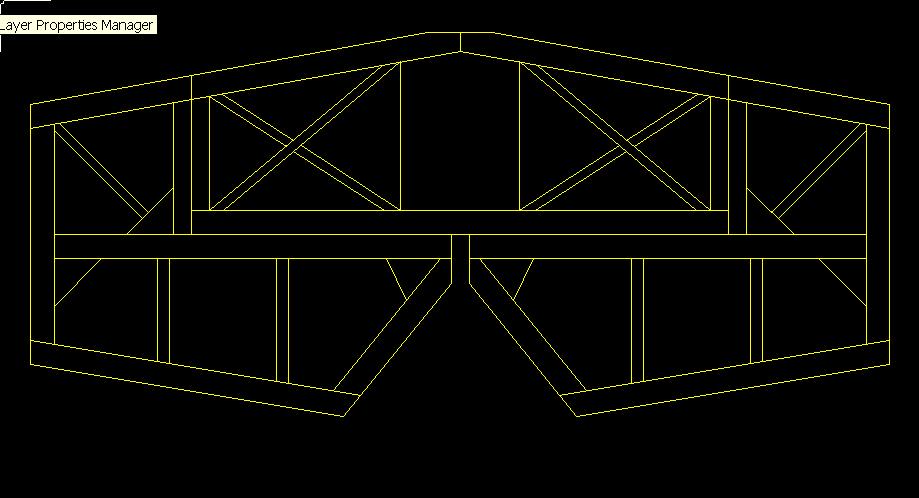

To kick things off here are a few pictures of the planned tail mods. In all of the pictures the light blue framework is the stock build. The yellow represents what I will build. The shape and proportions are close to a scaled down version of my Wild Stik 120 that is just a blast to fly. It's in the last half of the video linked above.
Notice in the drawing of the stab and elevator, I will be moving the hinge line as well as the leading edge of the stab forward about 7/8”. I am doing this to match (more or less) the proportions of the Wild Stik, plus it makes more room for rudder travel. There will be counterbalances added to the elevator as well.
For the rudder, I'll increase the height and length by about 5/8” while creating a significant counter balance. The trailing edge of the vertical stab (fin) will be extended down to replace the β€œshaped tail post” that goes between the fuse side. this is to increase strength of the vertical fin. In doing this the very end of the fuse will be about 3/16” wider than stock.

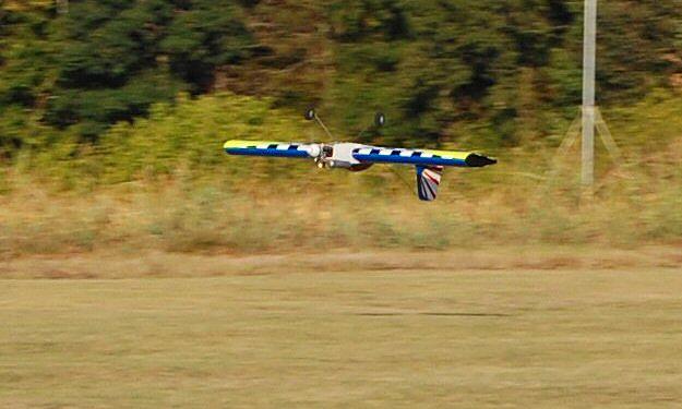

The Uproar is a fun plane and you're definitely on the right track to increase the elevator and rudder. Make them as big as feasable.
I had one with a GMS .40 and it was a rocket!

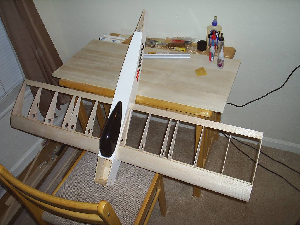

So yes, i got home tonight, and framed both wing panels in about 30minutes
Built the fues for this guy almost for years ago[X(]
Just need to finish up the wings once a few things dry up, frame the tail, and cover it!

Ya these kits build fast! Another 45 minutes of work i got the wings finished except for the front sheeting, my goal is to fly this thing on sunday maybe, week from today!

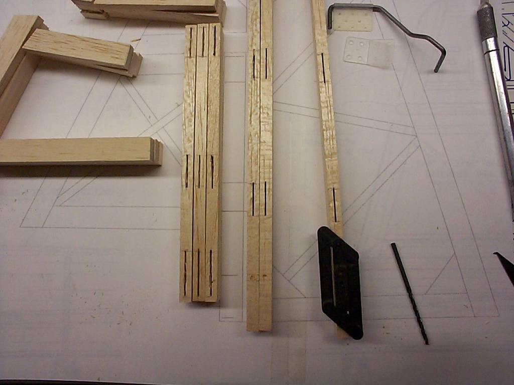

I finished cutting all the perimeter pieces for the tail as well as some for the ailerons. In picture two you can see the really blonde pieces of balsa at the outside edges of the stab and inside edges of the elevator counter balances. These parts I used some 1/4 X 3/8 from my stash.
I also started on the hinge slotting process. For me, it is a lot easier to slot the pieces at this point versus fooling with it when the stuff is already built.

Old 11-12-2009, 03:48 PM
prgonzalez
prgonzalez's Avatar
Join Date: Jun 2004
Location: KATY, TX
Posts: 868
Default RE: Tower Hobbies Uproar 40 build
ORIGINAL: RICKSTUBBZ
If I were to go with sheeting on all of the tail I would switch to 3/16” X 3/8” stock for the perimeter pieces. Maybe even 3/16” X 1/4” (doubled up at hinges only). Needless to say 3/16” X ?? for the internal bracing. This would give 5/16” instead of 1/4” for finished thickness after adding sheet. Could even use the 1/8” X ??, then you would finish out at 1/4” thick.
Yes, wood thickness compensation is need for this mod.
... PR, if you get the tail feathers to flex you have other problems. ...
In my case, what I found is that depending on how monokote shrinks, it can flex the stab. Monokote can make the same effect in some wing structures. And, we all know the end result when this happens.
There are many different combinations to shift weight to balance out a model to avoid adding dead weight. In my case, I opened a hatch in the fuse bottom half-tail and installed the battery there. Also, moved the engine as close as possible to the firewall, still have the servos per plan, and had to add 1/2-oz of lead to the tail for my flying like. I also replaced the wire LG with duraluminum LG. I love the solid feeling of these LG. With a 46-FX and 11x5 APC prop, I have unlimited vertical at almost 5-lbs.
Old 11-12-2009, 10:01 PM
Daddyo57
My Feedback: (15)
Daddyo57's Avatar
Join Date: Aug 2003
Location: Lancaster, CA
Posts: 485
I just recieved my new Uproar 40 kit from Tower, they just raised the price to 49.99 from 44.99 last week... I am watching this thread with interest because I also intend to increase the elevatore as well as rudder size roughly a 1/4 inch and put a small dorsal for looks. I really enjoy the Uproar i have and it is currently my favorite airplane. I am running a GMS .47 on it and it is a great combo with awesome vertical. I am going to do a similar covering job on my new one, I built the one in the pic about 5 years ago. I may scratchbuild a couple of these great flying birds in the near future. I have even toyed with the idea of making a twin using 2 fuselages like an F-82 Twin Mustang and thoughts?
