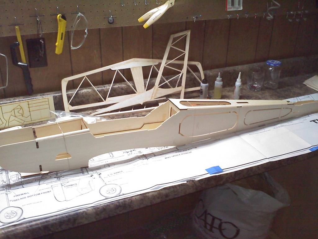

Build update: This morning I fit the formers in the fuse and rubberbanded it all together to check the fit. All looks well. I went ahead and epoxied formers A, B, and C. I will do the firewall after Christmas. So far this laser cut is going together very easy. I'm gettin closer and closer to decision time on the main gear.

The wing you see is only pinned together. I have not decided yet on mech or air retracts so I am just checking fit. Since I am 1.5 hours to the closest LHS I have to wait till the weekend to go buy the extra balsa stock I need to make a chin. I have the Tiger Delux wood kit on its way from Goldberg. I just ordered that this morning.

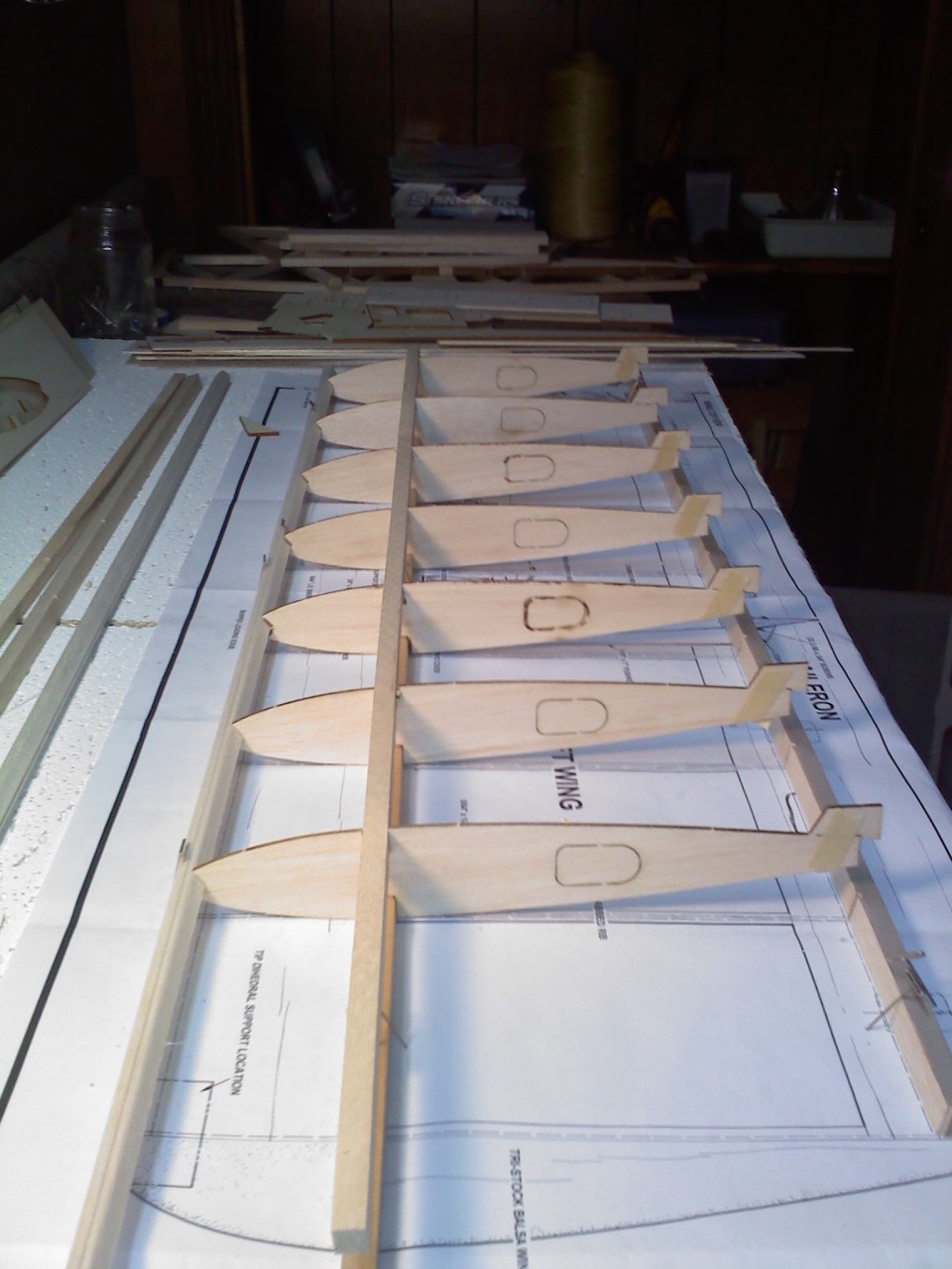

Steven, The pictures of the wing you say are just pinned to check the fit. I hope you realize that the ribs are upside down. The trailing edge does not get pinned to the building board, just the spar. Then the ribs go on the spar with the rear tabs down. This sets them level with the building board. Then the rear edge sits on top of the tabs. After the wing is further along in constuction, these tabs get cut off. If you already knew this, then I'm sorry for the butting in here, but if not, I would hate to see glueing take place & the problems that would transpire from doing so. I had a Goldberg "SKY TIGER" many years ago & I put flaps on it as a trail to see how well I liked them. Best plain I ever had short of an Ultra sport. Good luck with the build. Looks good so far. Bill

Yes it is still just pinned. And I did not think of it but it sounds like you are right. I will definatly change it when Iget home this evening. I'm a bit surprised Ididnt notice that. I do most of my work in the late evening so maybe I was too tired to see what must be obvious. Last night I put the plans for both wings together and pinned the spars to the board. I also put the ribs on (upside down).

Your build looks good, just a question did your wing ribs line up with the plan? Mine did not but they still are going to work.

And no...my ribs did not line up exactly. Ijust ran home to pick up an ohm meter to do a chore here at my store and I corrected the upside down ribs. Man Iwish Ihad a LHS closer than 1.5 hours away. Ineed balsa stock, a spinner, tailwheel assy, hinges, etc. etc.

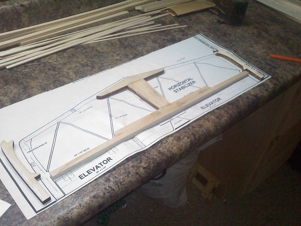

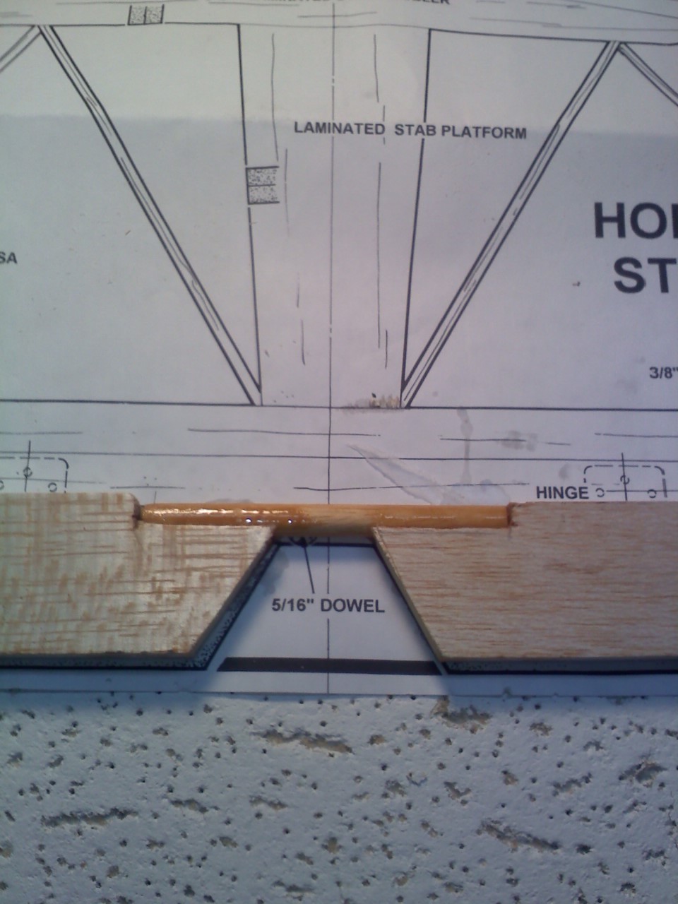

Looks like Imay be wrong about the strentgh of the tiger elevators. The epoxy set up overnight and it appears to have more strength than I anticipated. And obviously when I cover it with Koverall and polycrylic it will be even stronger. I must say I think I would have prefered a steel torque rod. Failure of this component would be bad....very bad. So if anyone has any ideas on how to strenghten this union i would love to hear it.

Don't worry about the strength of the dowel on the elevator. Think about the amount of load you will be exerting on the elevator. The balsa will fail before the hardwood dowel! I like the build, keep it comming!
