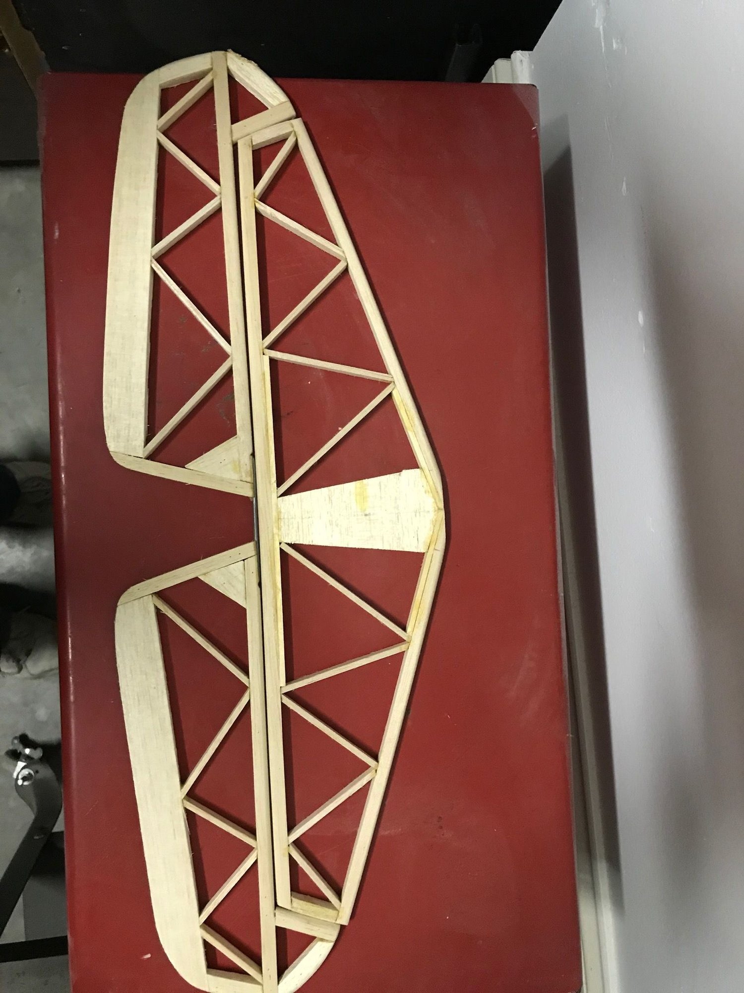

I finally think that I may have some time to work on the Citabria again! I’ve moved 4 times in the 5 years that have passed since I last worked on the model. In the meantime, I’ve been rethinking my plans for the Citabria. I am still very uncomfortable having the needle valve at bottom of the cowl. It will require the use of a lot of caution whenever it needs to be adjusted. I could rotate 180 to fix this, but then throttle linkage would be at bottom and the exhaust would be in an inconvenient location.Therefore, I have been considering converting this to an electric version. This would have several advantages for me in addition to removing the needle valve. First, I am not sure how often I will be able to fly any airplane. I don’t want to have a lot of glow fuel sitting around in the garage gradually going bad. I think it would be easier to handle batteries than glow fuel. Second, I won’t have to mess with tuning the engine every time I make one of those infrequent flights. Third, the cowl will look better without so many hole cut into it for the engine. Finally, I won’t have any exhaust residue to clean off the airplane after every trip to the airfield.There are two major cons to converting. First, I know very little about electric powered airplanes. Second, I will really miss the sound of a real engine!I have spent a bit of time looking for a motor, ESC, battery, and prop combo that would work for the Citabria.I saw a YouTube video where someone used this combo (Motor NTM 42-58 500kv, ESC Turnigy 85 A). The system seemed to work well, but the motor is no longer made. I found a report of someone using a Hacker A50 12L, on a 7S 4000 pack. Another person uses an Eflight Power 46 motor, CC Talon 90 esc, APC E 12x6 prop and runs on a 5S 4000mah battery. I found several other posts where people said that they recommended, or planned on using, a large variety of setups. Unfortunately, I was not able to learn if these were actually used or how well they worked.I would certainly appreciate any advice that would be offered!I need to spend some time thinking about the conversion and learning about the world of electric RC.Today, I put some filets (not sure if I got the term right) along the bottom of the fuselage. In addition, I looked at the stabilizer and elevator. They don’t match as well as I would like. In addition, there is not a gap between them that is large enough to allow the covering. I did a bit of sanding and they fit together better when clamped in position. However, I think that they may not line up when the hinges are installed. I need to think about this problem some more. Last, I was able to start putting the new cowling together. I will need a new cowl if I convert it to electric.
Filets
Stab and elevator before sanding
Stab and elevator clamped together after some sanding
Starting on the new cowling
