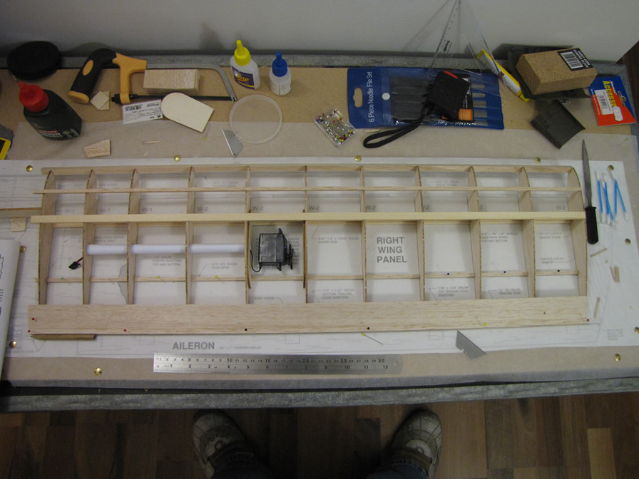

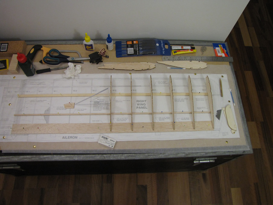

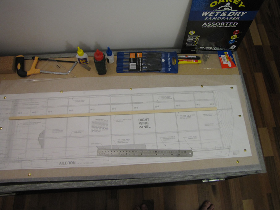

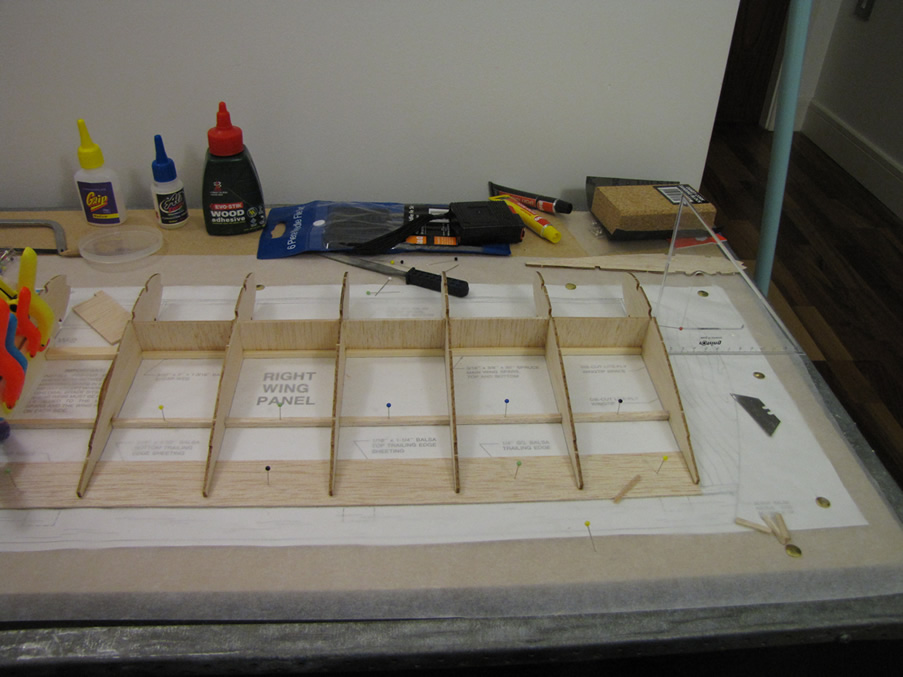

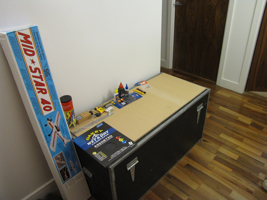

Here is a shot of my building environment.
Previously I had a full workshop with every tool under the sun – this time I’ll be working with a very basic setup and as we live in a small apartment I’m literally building in our hallway – isn’t the misses going to be pleased when she get’s home.
Aside from a drill and covering equipment this is more or less my complete workshop.

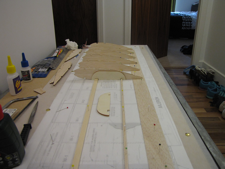

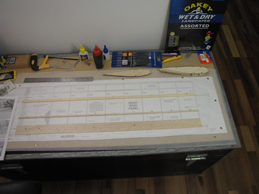

First time I've pinned a part in anger for four years. I'm using Bostik wood glue - the glue joint is stronger than the wood and the drying time allows for good progress to be made while still allowing time to position parts. Can't believe I used CA before.

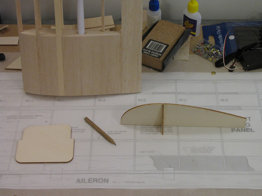

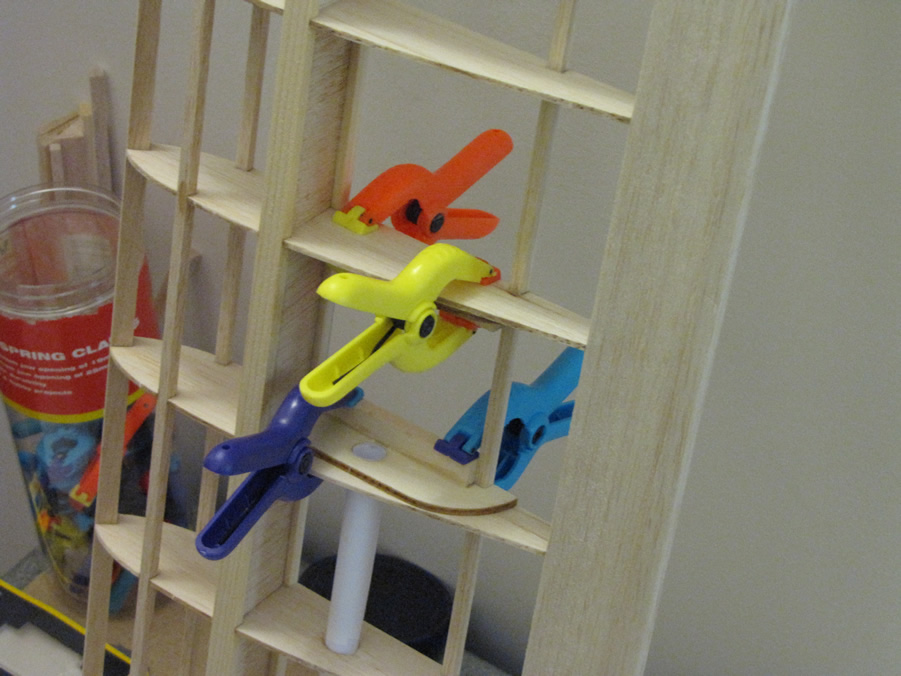

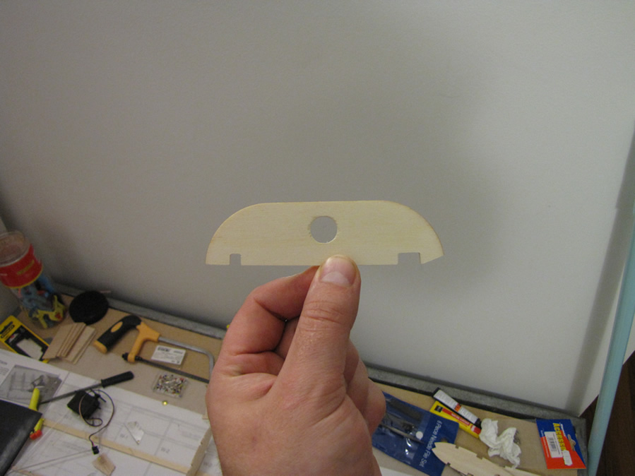

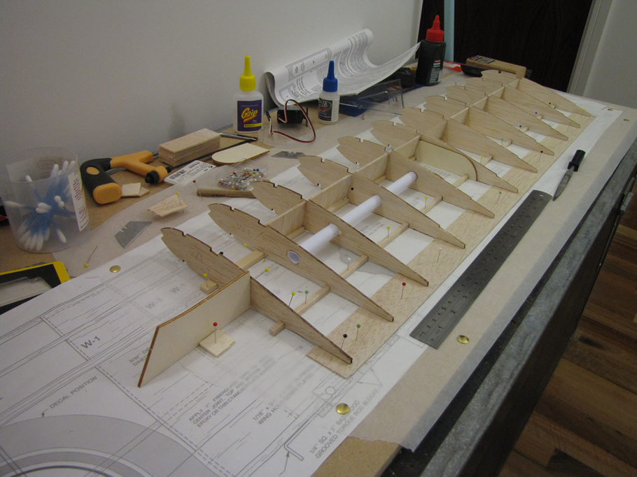

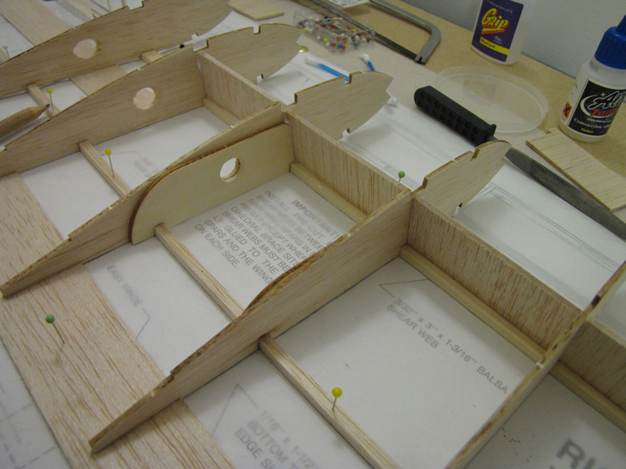

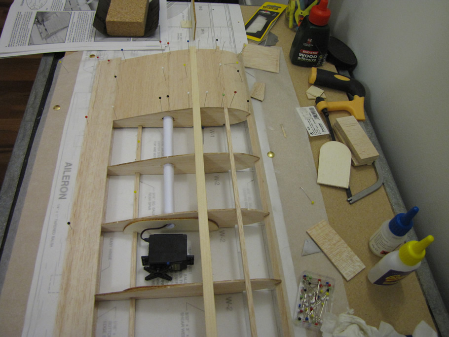

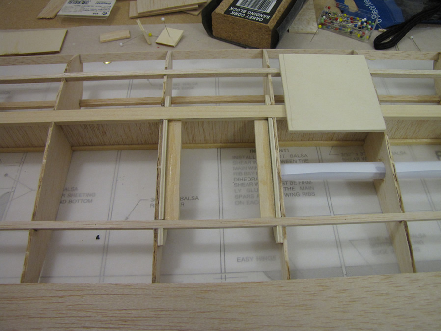

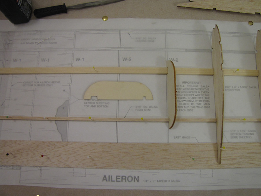

Some more progress –
I’m going to use the 5th wing bay from the centre for the aileron servos. I’m going to add a doubler to the wing rib either side of the servo bay – the last airframe I built with dual aileron servos was a 4 star 60 and I can’t remember what the structure looked like, but I feel with the rear spar being balsa I could do with a little extra strength in that area. Plus it’ll get me thinking about how this airplane may be built into a twin at some point.
The doublers (pictured) have been made form one of the scrap pieces of light ply from the punch outs in the fuse sides.
I realise these where removed in the first place to lighten the airplane – but I’m sure with the size of this wing and a .45 up front a few extra ounces across the whole dual aileron modification is going to make little difference to how it flys.
I’ve also started installing the shear webs.
(NB: I’m hoping around the build steps a little to be able to continue building while I wait for parts to dry – this is a bad practice if you’re contemplating your first build)

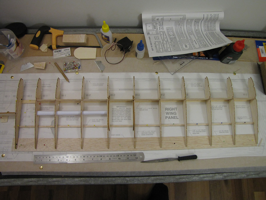

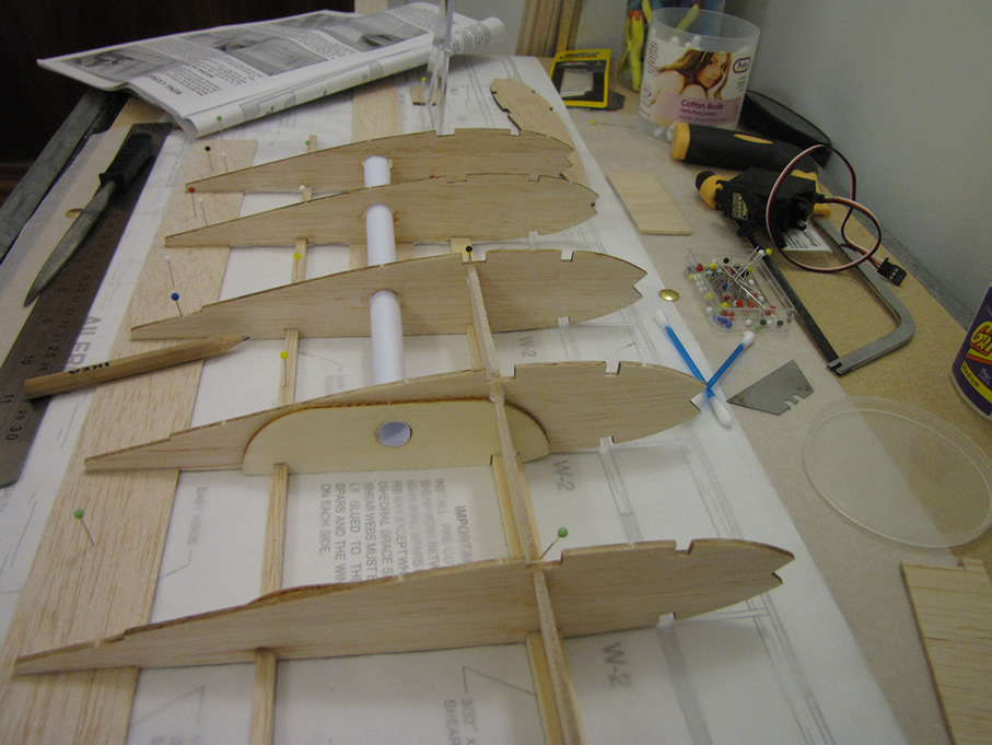

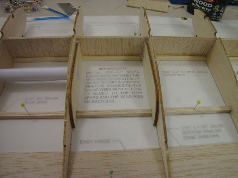

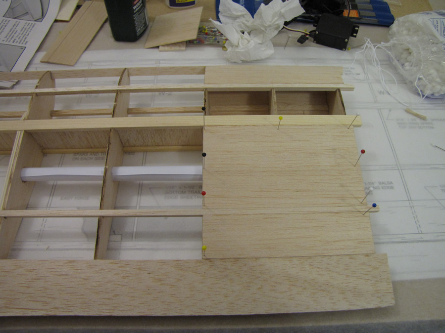

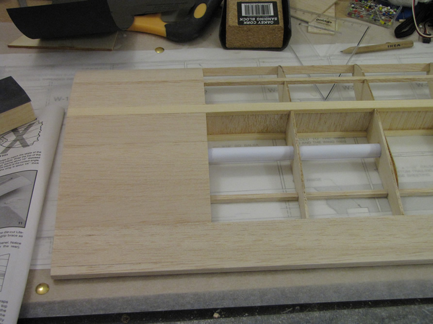

Finished installing all of the ribs for the first wing half including a paper tube for the aileron wire.
I made a bit of a mess of the holes in the ribs for the tube – I bought a brand new 12mm drill bit to make sure it was nice and sharp and tapped the ribs together for drilling. The two W2 ribs drilled out fine with a nice neat circle but the drill bit chewed into the W1 ribs causing the holes to be less than neat. No real damage but little imperfections annoy me.
I’ve since read a post where the builder used a piece of sharpened metal pipe with a right angle bend at the top for a handle to cut out perfect circles for this purpose – I’ll remember that one!
Also, was saved by the wood glue today (I’m sure it won’t be the last time). I glued the final inboard rib in without inserting the paper tube – there would have been no way of inserting this had the final wing rib been in place. I realised my mistake and was able to remove the rib before the glue dried!

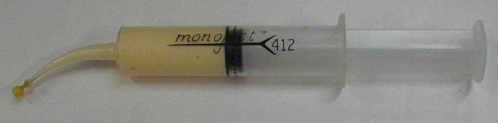

I couldn't agree more with the Monoject syringe for applying wood glue. Cheap from any medical or dental supply company. I've been tacking my planes together with medium CA and then running a bead of wood glue along any joint. I use epoxy for the firewall, wing, gear mount, and gluing the tail on. CA is too brittle for a long term plane. CA+Wood glue makes planes that will last 10+ years!

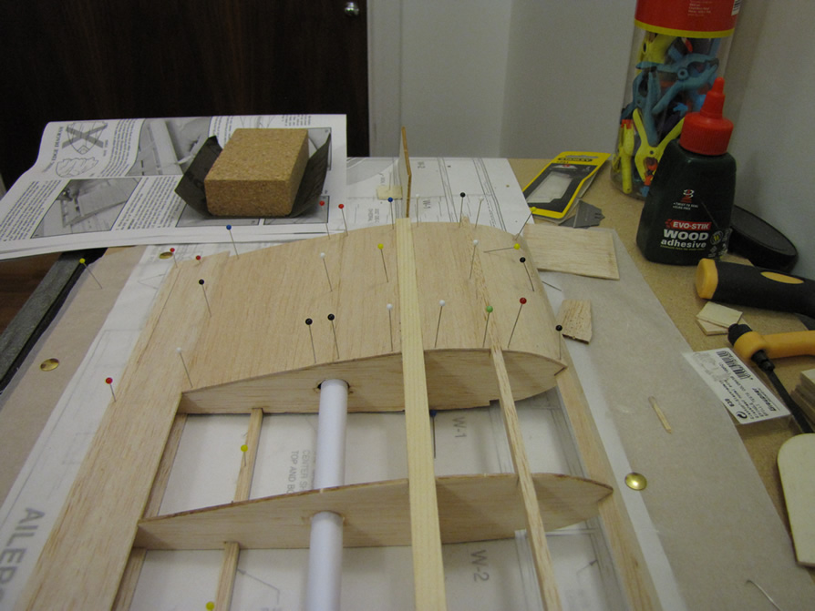

More progress,
Have installed the other spars and leading edge and completed the top and bottom sheeting - not sanded clearly.
This is a nice kit - if you where going for it you could probably knock out both wing halves in a day.

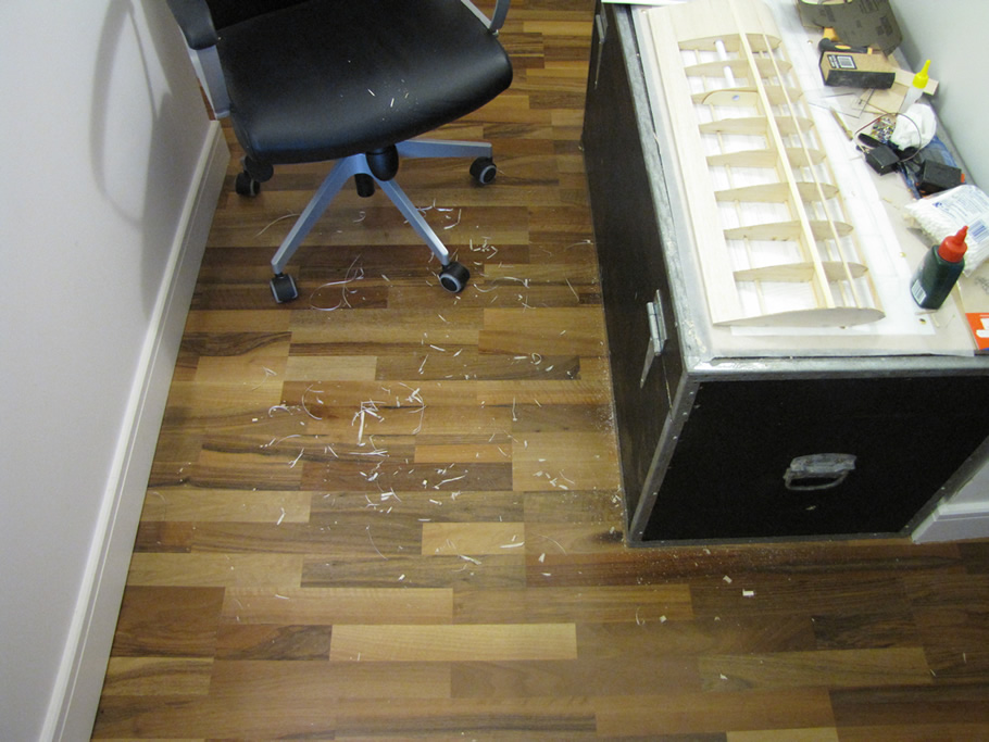

Further progress – began sanding...
I’m not sure how this is going to work out inside the house but I do know I’m going to be in trouble when the Mrs sees the below.

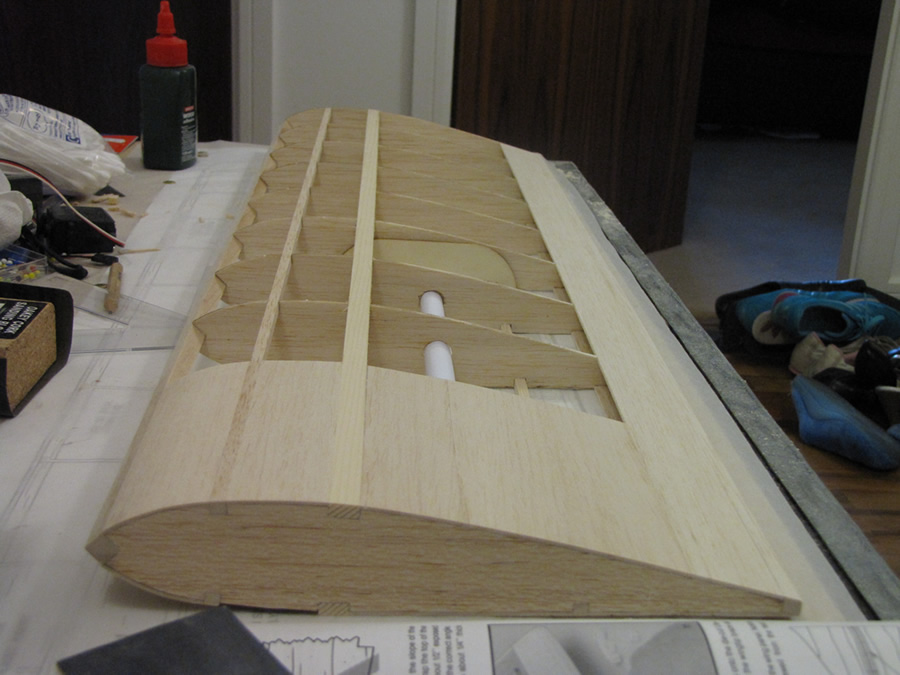

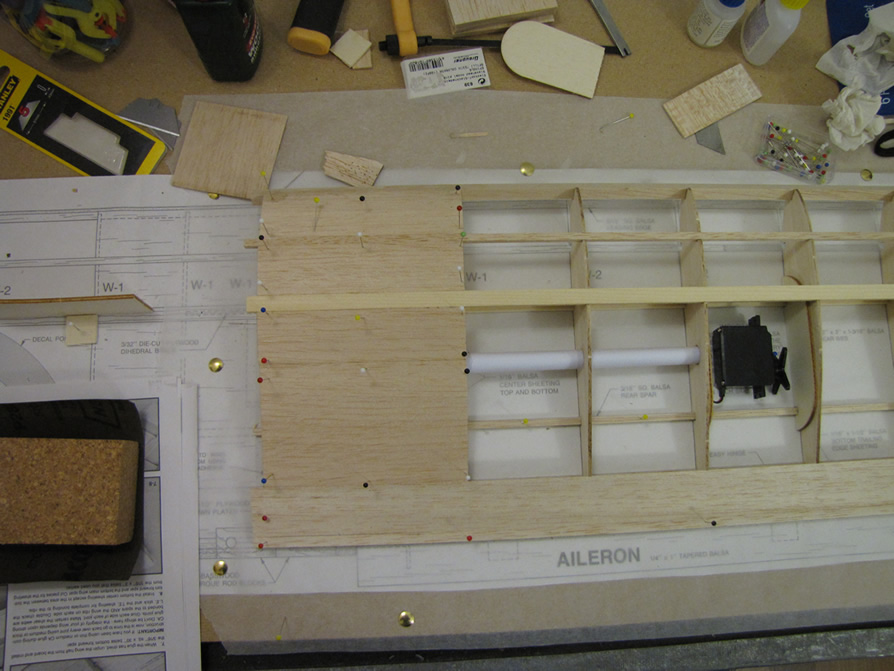

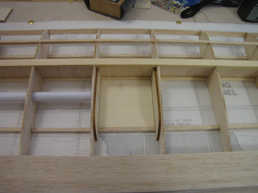

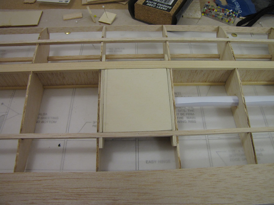

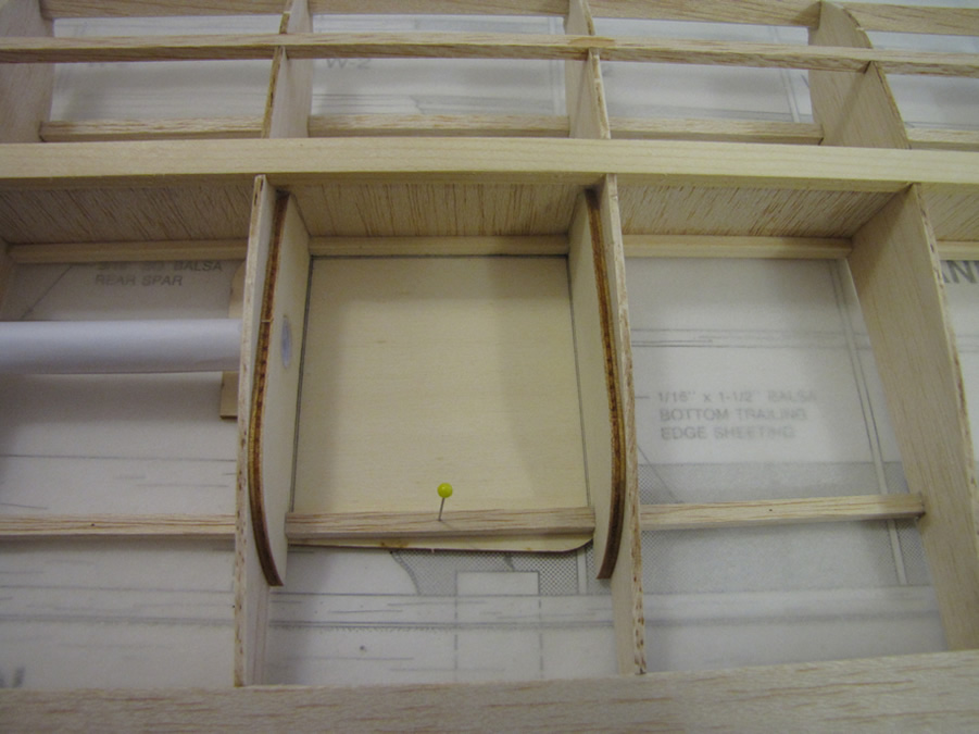

I got the first servo bay more or less built today.
It’s built similarly to the way you would do a 4 Star 60 wing. The cover has been fashioned from one of the pieces of light ply removed from the fuse sides.
Close to a complete wing half now – I can’t make up my mind whether or not to add the wing tip.
It’ll certainly make it more difficult to cover but will it add anything to the airplane?
