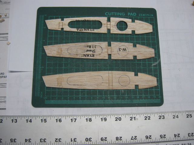

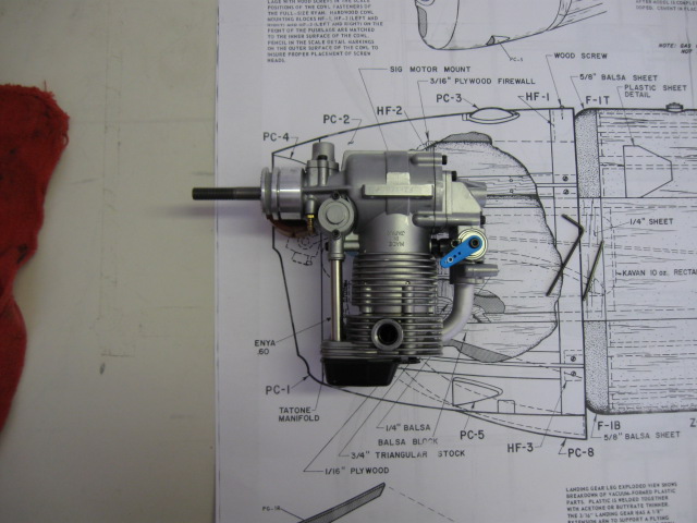

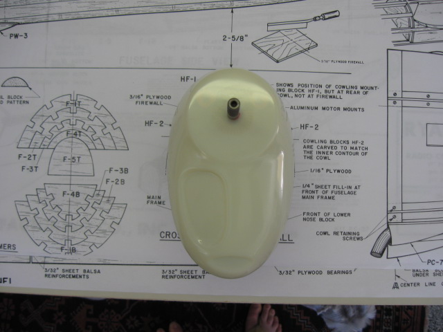

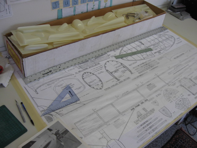

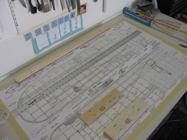

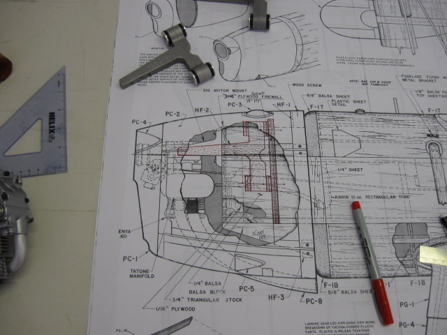

    After completing my latest project, I’m getting prepared to start and old classic builder’s kit by SIG. The Ryan STA special 200.
    I tried this kit many years ago when I was younger and bit off way more than I was able to chew, I soon gave up and handed
    this kit to someone I knew years ago and that was it. Fast forward to the internet several years ago and to my surprise I obtained
    2 kits for the price of one!
    I may do the same thing as before and scratch build this and use the kit as a template like I did with this project;
    http://www.rcuniverse.com/forum/m_8215532/tm.htm

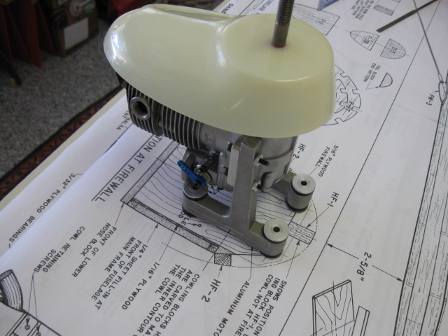

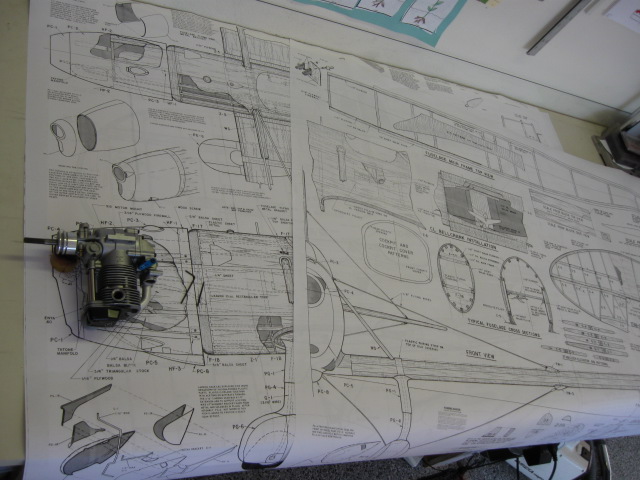

    I have already made copies of the plans to start; the motor for this is a Y.S. 140 Sport that belongs to my nephew so it’s going to
    be his plane. Due to the outrageous power there will definitely be some mods and new wood as the existing wood is near 40 years old!!!

    I also have the kit NIB and plan to build it.
    But a 1.40? it suits a 60 2s/90 4s at the most, doesn't it?
    I may build mine as the standard two seater with longer flaps and shorter ailerons.

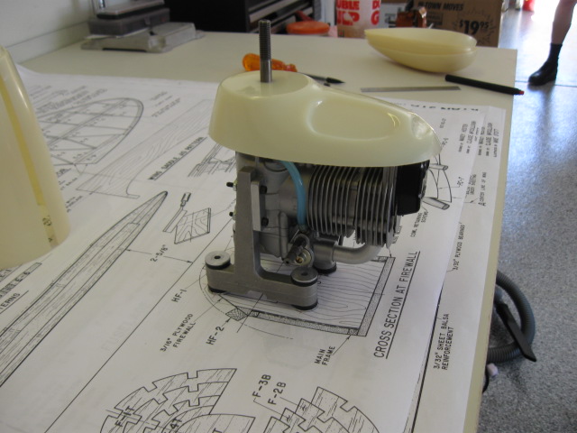

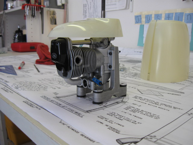

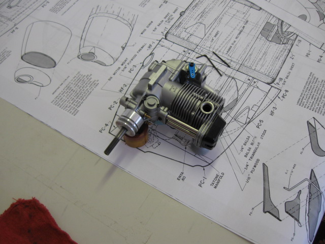

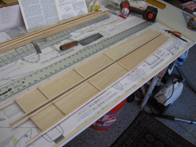

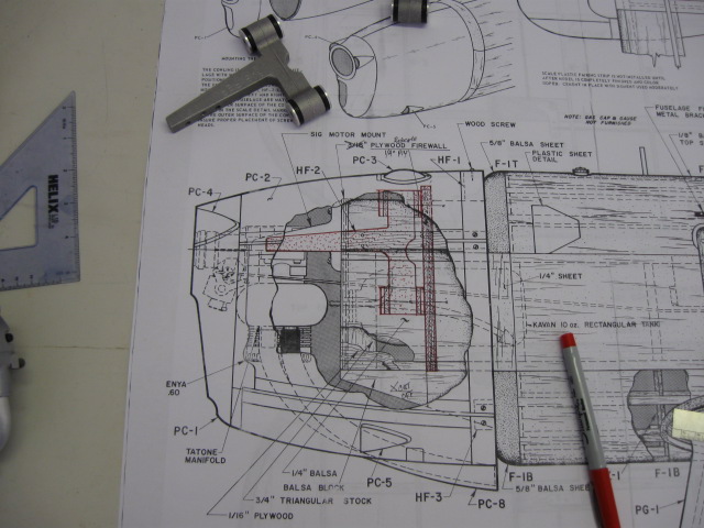

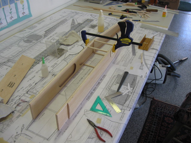

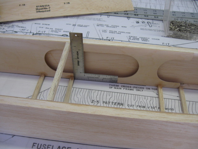

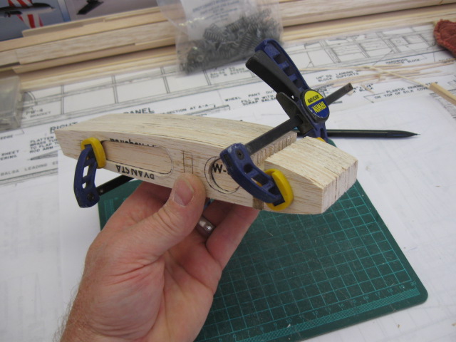

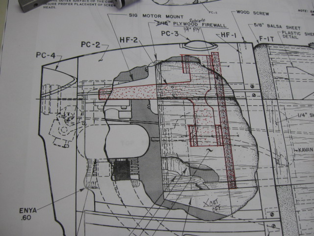

    I have started building and have considered maybe a smaller engine for this kit, I'm thinking of something like a Saito 1.00 or equivalent. The fuse sides have been shortened
    to accommodate a larger motor and vibration dampening mount. I plan to utilize a new type of aluminum solder to fabricate a custom exhaust manifold, we'll see.

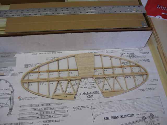

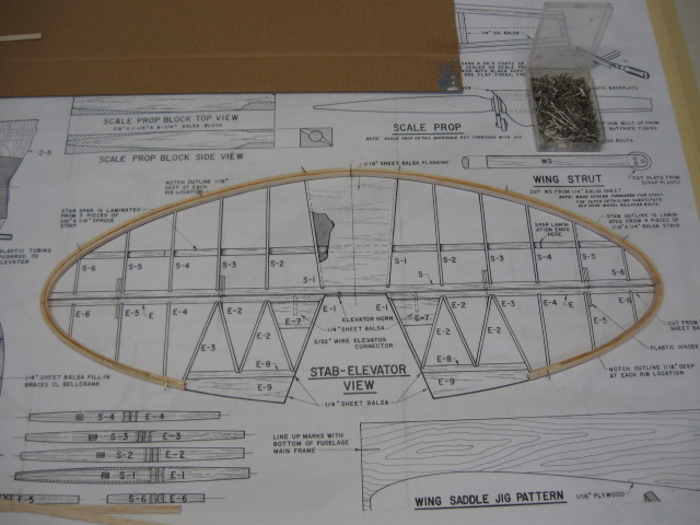

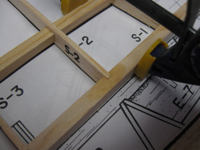

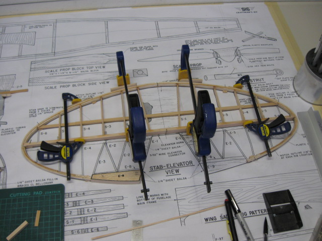

    The stabilizer and elevator are completed and I replaced the stabilizer trailing edge with spruce to compensate for strength if
    I do in fact use a larger motor, the guy wires will also be functional to help in holding things together. If I do go with overpowering this plane I may go with a theme for this
    and adopt a modern hi-perf clone aircraft idea. where the theme is that this is an experimental modern with a retro style, like auto manufacturers are doing today
    with cars... just a thought.

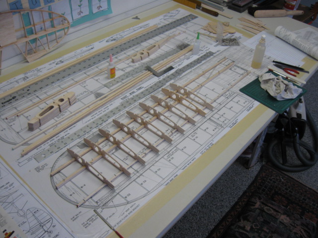

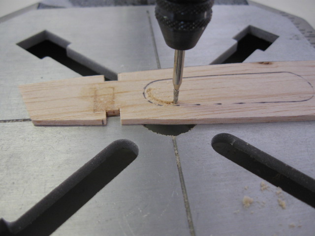

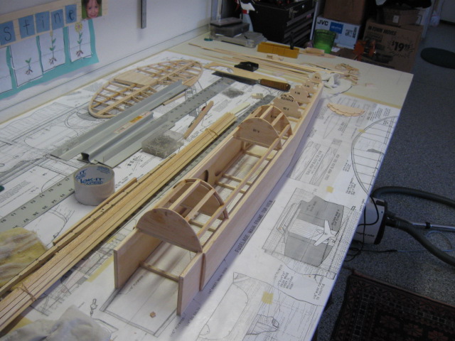

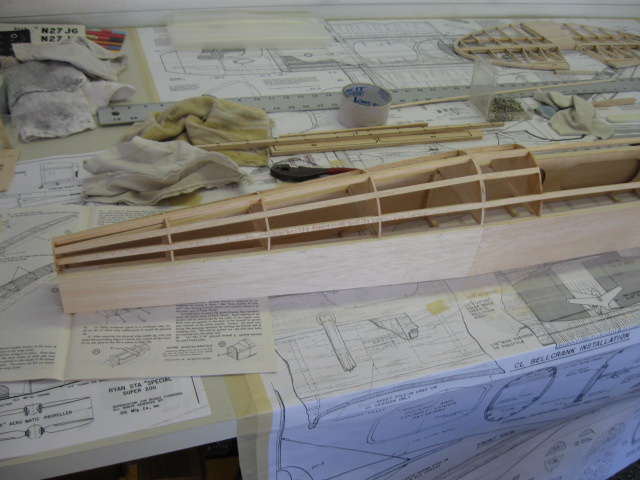

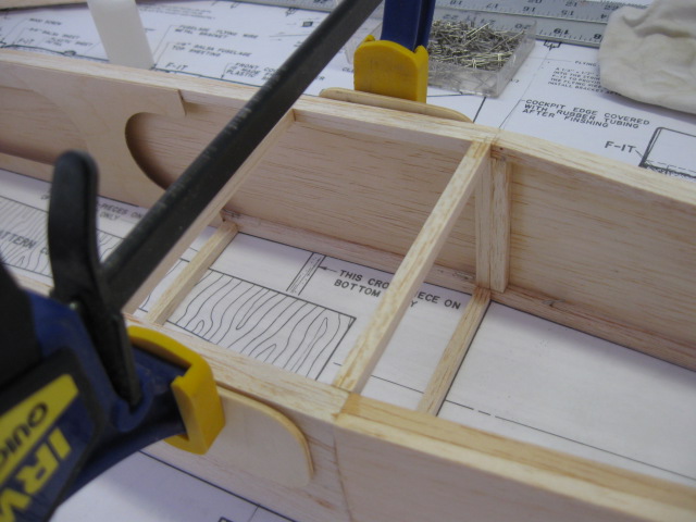

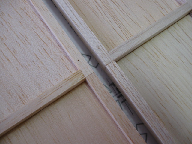

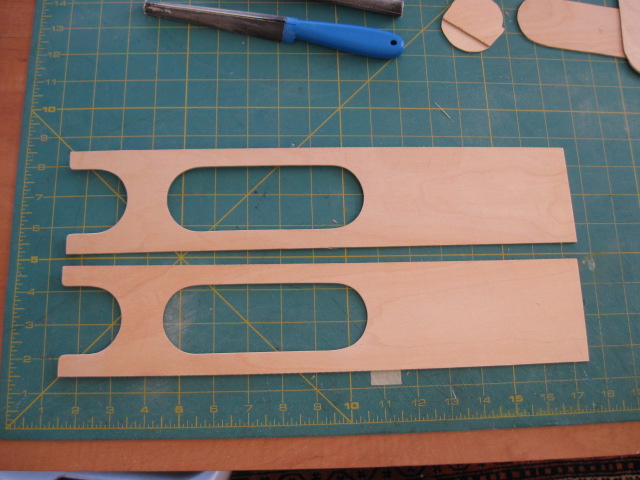

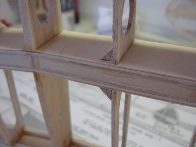

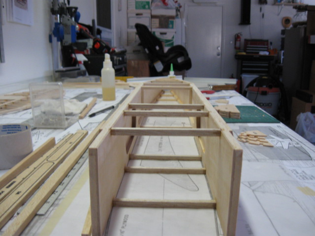

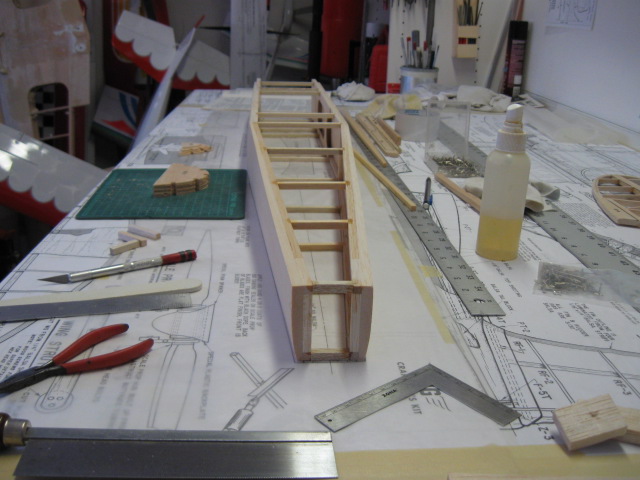

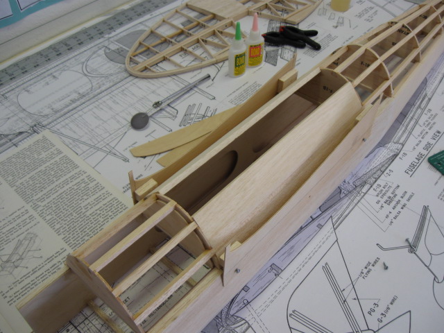

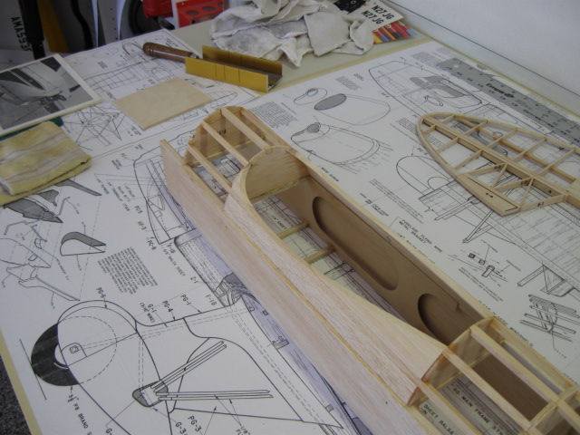

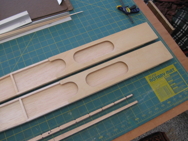

    Here are some photos revealing the work completed on the fuselage, I have halted work at this stage
    to build the wing. The wing is undergoing some serious reengineering. To cope with the power output
    of the larger engine (yup it looks like the Y.S. is going in) it’ll resemble a more modern wing configuration.

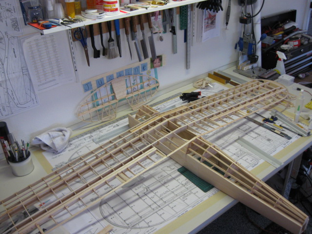

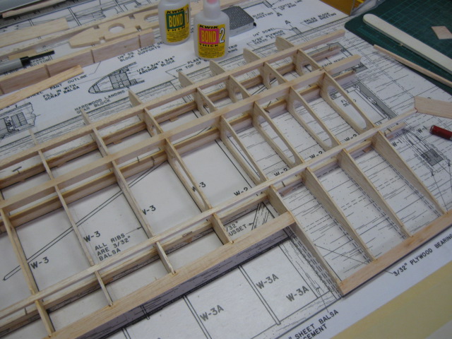

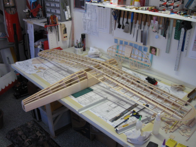

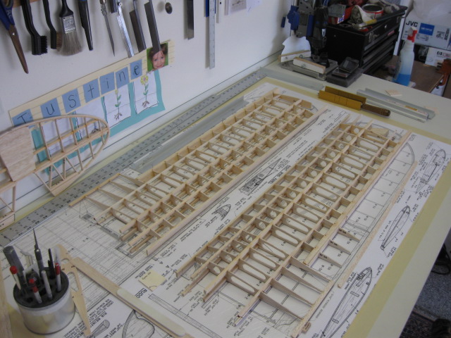

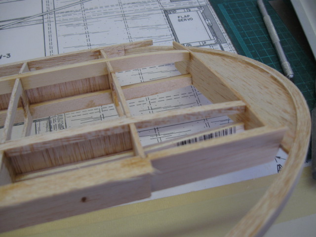

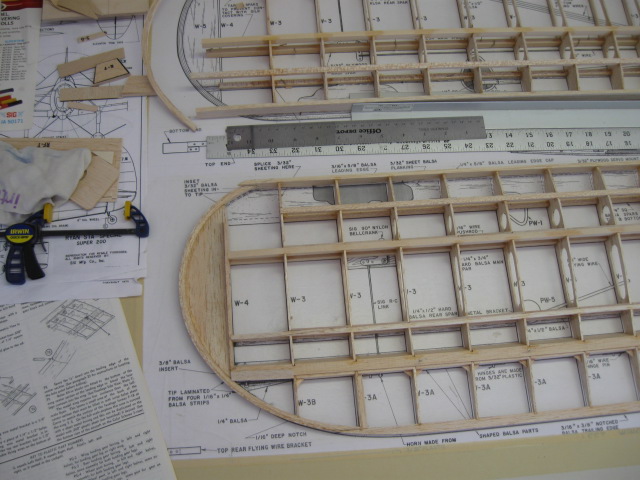

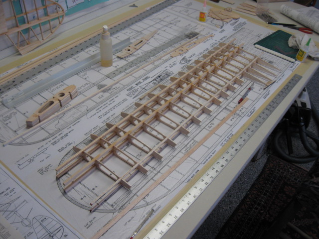

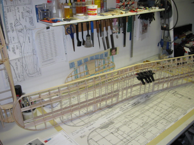

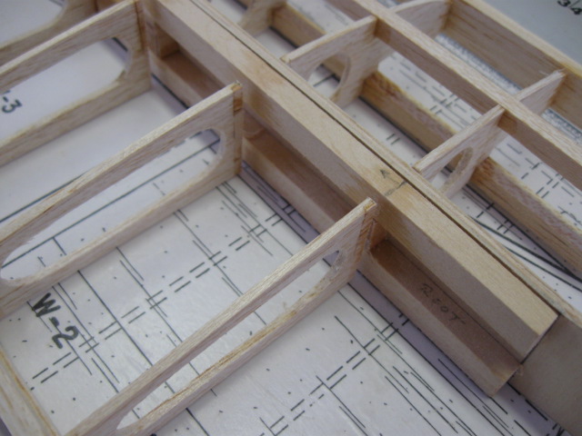

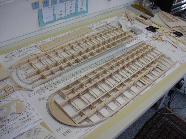

    Wing photos . . .

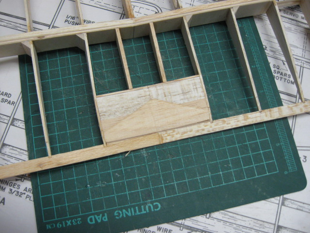

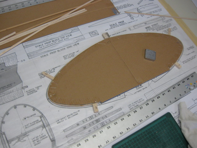

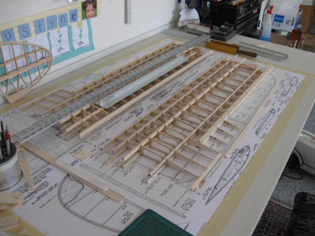

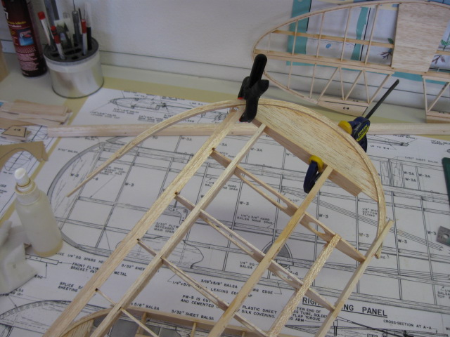

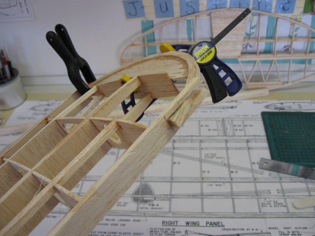

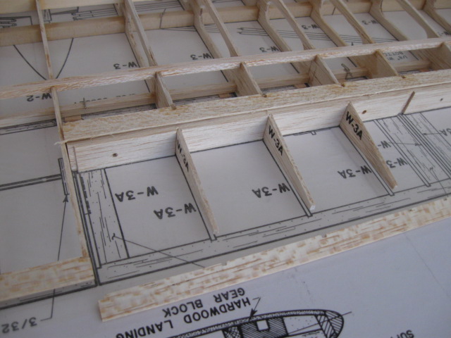

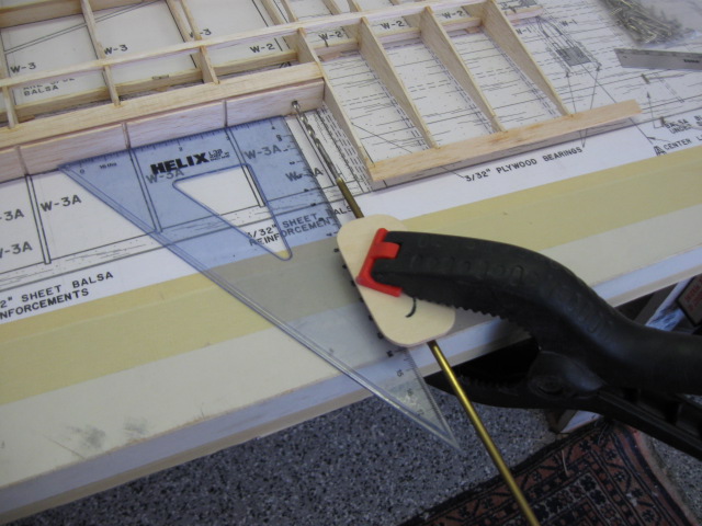

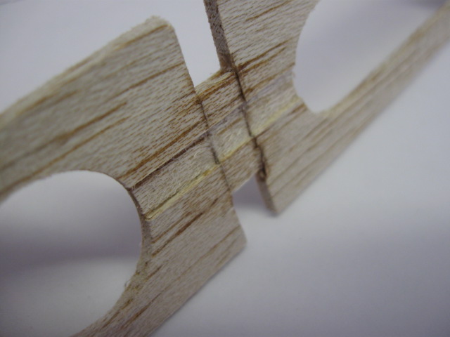

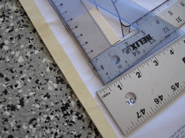

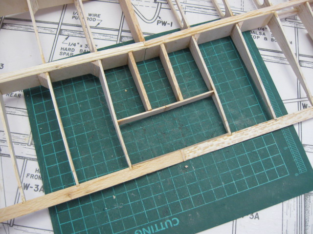

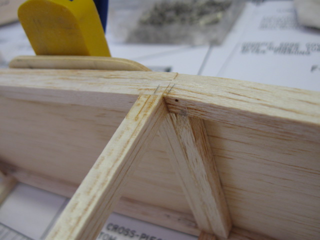

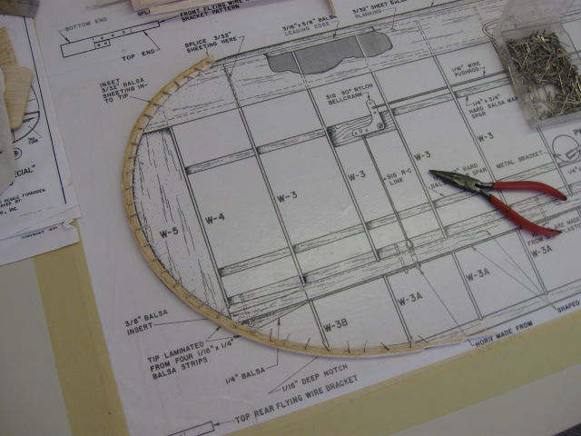

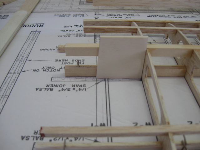

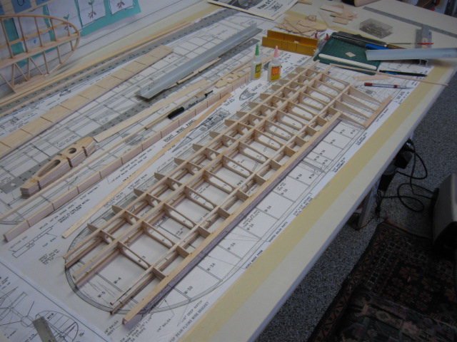

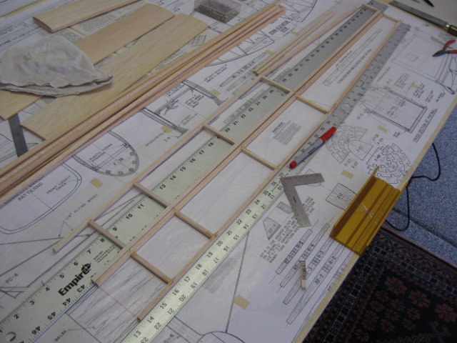

    I have started to work on the wing at this point in construction and the theme is going in the direction of restoring and modifying and old
    aircraft to perform a lot like a new high performance plane. I am toying with the idea of completing this in an unfinished polished aluminum
    fuse and aluminum colored wing and tail surfaces. This will require a serious amount of custom chrome plating to all the plastic which I
    am currently looking into, this is now possible these days so it might be worth the cost if it can be done well.
    The wing is going to look more like something from a newer build; I chose this to add rigidity and help alleviate the possibility of folding
    during high G maneuvers, the tail structures are going to get similar treatment with the increase in hard wood to help maintain the original
    appearance.

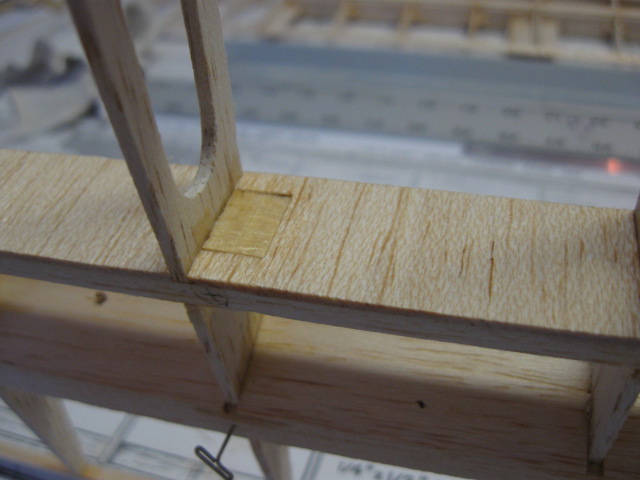

    How did you drill the holes for the hinge points? Did you solder a drill bit to the brass tube? Also what type of drill bit did you use to give such a neat hole in the balsa?
    I have not used Robart type hinges before but I have bought them for installing in a 1/4 Tiger Moth (currently on the table). I have bought the Robart drill jig but your method looks like it could be more precise and is done with the wing on the board - easier to drill parallel to building surface!
    For the aluminium finish would flite metal be appropriate, see link.
    Flite Metal Web Page

    The Flite Metal Looks good, I'm going to look into this method for sure. thanks for the heads up.
    Believe it or not the metal tube is 5/32 OD and an old as heck drill bit held in with nothing more
    than fitting in tight, just got luck I guess. For the clean hole what I did was start with very
    light pressure then let the bit do the cutting, what the pic doesn’t show is the exit, not as neat but it will
    have a scrap piece of balsa to enclose the hole.

    Here are some more photos of the wing constuction.
    Attached Thumbnails Attached Thumbnails Click image for larger version.
ID:	1510144   Click image for larger version.
ID:	1510145   Click image for larger version.
ID:	1510146   Click image for larger version.
ID:	1510147   Click image for larger version.
ID:	1510149   Click image for larger version.
ID:	1510150   Click image for larger version.
ID:	1510151   Click image for larger version.
ID:	1510140   Click image for larger version.
ID:	1510142   Click image for larger version.
ID:	1510152   Click image for larger version.
ID:	1510153   Click image for larger version.
ID:	1510154   Click image for larger version.
ID:	1510155   Click image for larger version.
ID:	1510157   Click image for larger version.
ID:	1510158   Click image for larger version.
ID:	1510159   Click image for larger version.
ID:	1510160   Click image for larger version.
ID:	1510162   Click image for larger version.
ID:	1510164   Click image for larger version.
ID:	1510165   Click image for larger version.
ID:	1510166   Click image for larger version.
ID:	1510167   Click image for larger version.
ID:	1510169   Click image for larger version.
ID:	1510170   Click image for larger version.
ID:	1510171   Click image for larger version.
ID:	1510172   Click image for larger version.
ID:	1510174   Click image for larger version.

    I have purchased from Fiberglass specialties before and they have good stuff.
    What I would like to do is create a cowl with opening panels to show off the O.S.
    120 Supercharged engine that may make its way into this model. Still have some
    time to ponder this...

    I recieved my sample frome FlightMetal and look foward to trying it out.
    Hopeing to use as much of the plastic as possible covered in this material.
    Another idea I'm thinking about is to have a light subframe under the cowl
    panels so that the engine can be showcased, the OS is probably going in this
    project so it will need to be cleaned and detailed.
