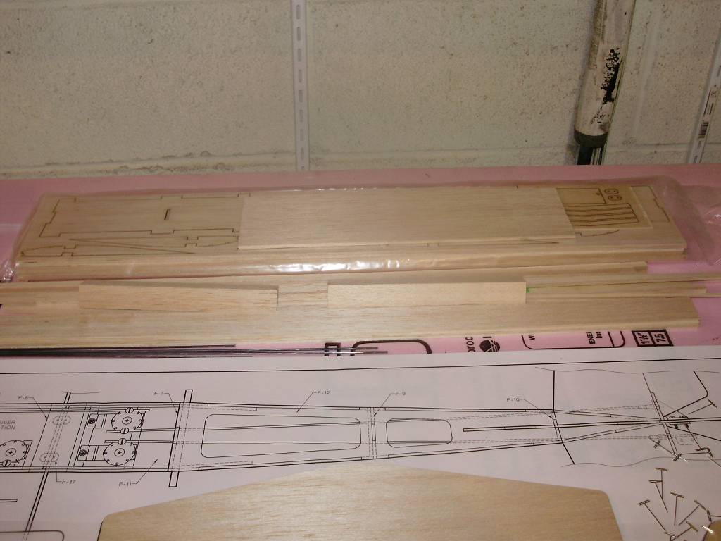

Hi everyone!
I just started the build on the star cruiser. The quality of the kit is outstanding! Was planning on my sons building this, but they are having too many questions, due to the lack of instructional pictures. For me, it is pretty straight forward. We are going to install a brushless motor in this one.
Will update with pictures as we start the fuse.

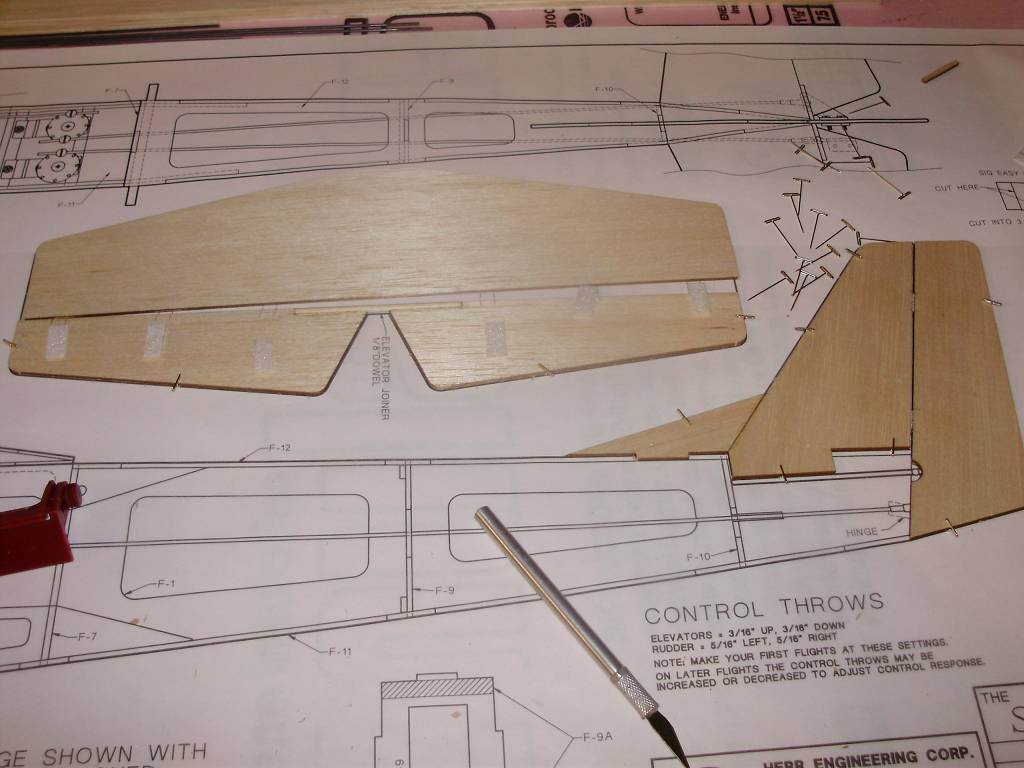

Ok, I have some pictures. I will try to be more detailed on this build, as for what problems I may find or just explaining the directions. I thought this would have been a real easy build for a kid to try. But there are no pictures in the build instructions. The first step is to put together the tail feathers. They are soild planks, so all you really need to do is knock them out and cut hinge slots.
The hinge slots were alittle hard to cut, I know my sons would have messed the wood up on this step. Next I will have my son lable the fuse and former parts and lay them out. I will then start the fuse build.

I've got a couple of small issues, but I am going at this as if I were a 11-12 year old. While building the fuse sides, the directions tell you to start with the left side. And that letter "L" should be facing on the inside. Well there isnt a layout on the plans for you to do this. A child would place the left side facing inward, and start building. But It also states that the L on the parts should face upward. Not a big deal, but like an idiot, I glued the fuse brace on the outer side, lol. I did catch it in time, and thank God I didnt us ca. I will be using wood glue unless stated otherwise in directions.
For a person with builds under thier belt, this would not be a problem. So far I like the ease of the parts " fallin out". And all parts have came together without any gaps so far.

RE: Herr Engineering Star Cruiser Build
Quigleywins,
I caught the tail of my Piece o cake in the first pic, just to see if you would catch it!
Its funny how each plane I choose to build, there isnt a lot of coverage on the net about them. That is why I am going to try to go in depth on this one and maybe help a newbe. From what I can find about this model, it seems that it is a very good smaller size trainer.

Good news, I got some pictures! I have failed on making this a detailed build, but All in all it has been real easy. You just have to remember that building is a fun part as well as flying it.
I have no pictures of the wing build, but they go together real quick. I still have to sand the fuse and of course install landing gear and electronics.

So what happened at F4 where the drawings are showing a sharp change in fuselage sides ?
I cannot tell by your pictures.
Zor

F4 is the front piece that makes the windshield. You may be talking about where the fuse starts to taper in running towards the rear? If so, there are doublers on each side. and at the point where the fuse sides begin to taper, the doublers have small cuts to be bent. The directions are a little unclear as what to do. I states to cut into the part at the dashed line, and glue. But what I did was left it unglued till the fuse was done, and then glued them( the small cut off part) in.
When I finish the wing covering, I will take a picture of the doublers to help explain.
