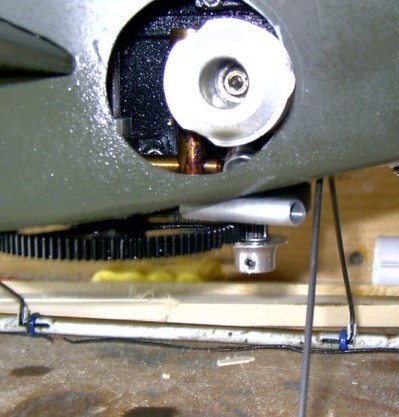

Heres my gearbox modification. This will allow me to make my tail fins removable and changable. Its overlayed with fiberglass cloth and resin. It will definitly out last the stock gearbox 50 to 1. I roughed the outter surface of the gearbox up with a dremel before applying resin and fiberglass.

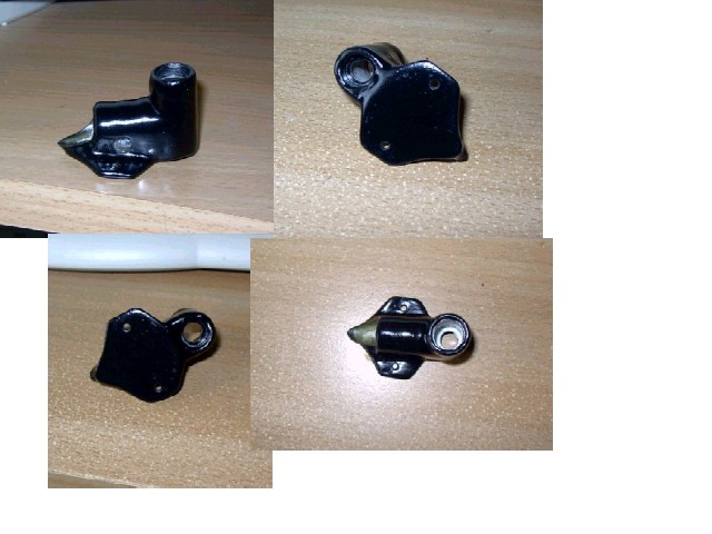

Fiber Glass Gear Box
Hey Darth,
I just got a new gear box and some fiberglass cloth, resin, and hardener from the hobby store. I would like to make a gearbox like you have, so I can bolt on different tail fins. I have never used fiberglass before… I was wondering if you could answer a few questions and give me a short step to step on how you did your gearbox.
1) Do I glue the small plywood piece onto the gearbox before fiber glassing? What kind of glue? Do you keep the small tailfin yaw angle molded into the gearbox, or sand that flat?
2) How did you keep all of the openings in the gearbox clear from the fiberglass?
3) How many layers of cloth did you use and in what orientations?
4) Do I apply the resin to the geabox first and then press the cloth into it?
5) How much resin should I be using / what should it look like when I am doing it?
6) How long does this stuff take to cure?
Sorry for the barrage of first timer questions, the instructions on the resin, hardner, and glass packages offer very little advice. The do recommend mixing the resin and hardner in a paper cup and not wax or plastic. They also recommend not using the resin over any CA glue. They never really say how to apply the resin or the cloth or in what order…

Heres what I did:
1.) Dont change anything on the angle of the fin mount on the gearbox. Just make sure the seam down the middle is smooth with the rest of the flat surface.
2.) make you a plate from 1/16 plywood. Make sure that its big enough so you can drill the tailfin mounting bolt holes in it(after its completed) without it interfering with the bolt that secures the gearbox to the shaft and make sure when you put the nuts on that they will clear the gearbox and the head of the tailrotor gearbox bolt.
3.)glue on your your ply tailfin mounting plate with CA glue
4.) take a dremel(or sandpaper by hand) and rough up the plastic gearbox casing .
Get an old tailboom or use the good one rub some candle wax on the end to keep the fiberglass resin from sticking You might want to rub a little wax in the other end where the bearing goes. Slide your gearbox on the boom you can hold the boom while working with on the gearbox.
5.)Cut your fiberglass in small pieces about 1/2" squares and some 1"x 1/2" youre going to layering and overlapping these pieces over your gearbox. (cut enough to do about two or three layers over your gearbox)
6.)Brush resin over your gearbox and plate.
Start layering the cloth over the gearbox(Its a messy job) dab the cloth down in the corners and around the edges with a stiff small bristle brush. keep working it until you cant anymore. Mix up a little more resin and repeat. After you get all your fiberglassing done and its cured, start shaping by sanding. Dont forget to remove the tailboom so you can shape that end also. Put boom back in Gearbox when applying more coats of resin. After getting close to to the final shape, mix some more resin and brush it over the gearbox (dont put anymore cloth on). let it set up and cure.
Sand some more until you are satisfied with how it looks. all thats left is drill out your tailfin mounting bolt holes and carefully redrill the hole that your T/R pitch change bellcrank bolt goes in. and open up the recessed nut socket on bottom of G/B (use a razor knife) and open bolt hole on top of G/B. If you get resin on the inside of gearbox where your gearbox bearings goes, it should chip out pretty easy. Do what you can to not let the resin build up in those places.
The last thing you should do before painting is drill your holes for the bolts that you will be using to secure your tailfins. Make sure your bolts and nuts wont interfere with the gearbox and bolt head
The process actually sounds harder than what it really is. It took me less that two hours to complete and thats including the waiting for the resin to harden.

Worked great. I think I will have to use a higher hardener to resin ratio, this stuff is taking forever to cure. Two general fiberglass questions:
