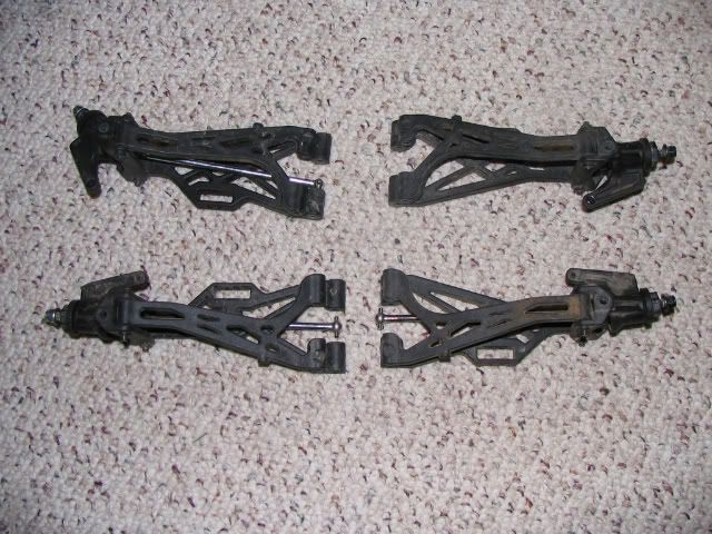

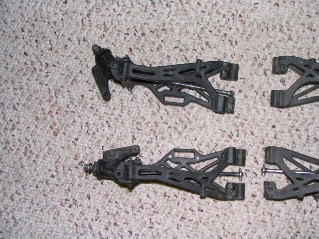

You can convert your XXL to rear steering, but you would have to switch the rear suspension arms and axles to LST1/Aftershock. It just so happens I still have my aftershock suspension from when I converted my AFT to LST2. On the AFT, there was a turnbuckle from the steering knuckle to the chassis somewhere. (I don't remember exactly where)
Closeup of one side:
Here's all 4 "wheels". Notice the black and silver wheel nuts? On an aftershock, the black nuts are left-hand threads and silver are right-hand. Hex size is 14mm.
The above setup is what you'd need to do rear steering. You would only need one set of two - you could keep your LST2/XXL front end as-is. I don't know what else would be involved to do it (linkage-wise) as I was advised to not do the conversion. Servo twitch could send the truck right into something it shouldnt if it were to happen.
