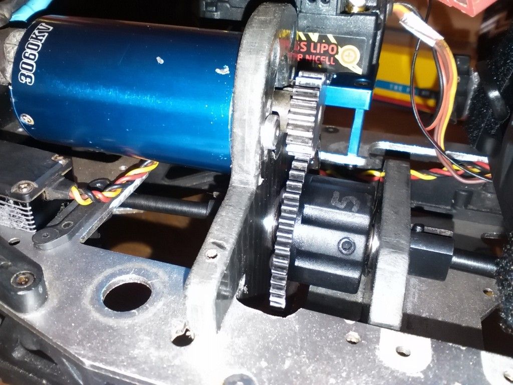

Hey guys I'm nit picking my build and since it's cold out I've decided to correct/ improve some things.
Losi lst first generation:
Castle mamba 2
Neewer 1700kv (it's ok)
Custom center diff/mount tower motor on top
48/14 gearing lowest in can go else motor hits servo
Hitec 7955 servo
Hpi gt2 wheels/tires
Axial battery tray and receiver box
Running on 4s 65c 5500Mah battery
Cooling fan on motor
Temps were 150-180 motor 90 on esc sometimes 110
12.8lbs fully dressed.
100k in front diff center diff 500k rear 10k
Complaints: like to lower temps a tad..but options are limited.
I need a 54t spur but don't think they make one?
Lower kv motor maybe? Will it offset temps?
Other get better wheels/tires that are lighter and not ballooning as much?
Rather convert hub/hexes to 17mm instead of 14mm
Instead of spending another $100 getting xxl arms carriers and 8 mm axle stubs and other needed gear I've been researching and it looks like traxxas Revo or xo1 17mm hex hubs Will work ??? I have extra 6mm stubs to make the thread ends right or left turn threads so not a big deal for those bushing inserts..
So this is what I got and like to get more input
Thanks art

Got any pics of the truck?
Motor will hit the servo? I'm guessing the motor is up front and the battery tray out back. Personally I'd reverse this so the battery will help keep the front end down. If the center diff is mounted to the center skid just rotate the whole skid 180 degrees. For the battery tray, use the stock throttle/brake and reverse servo mounts to get the battery tray up off the chassis. This will help clear the front chassis brace and servo wires just enough to get a tray in there. Yeah the battery will be higher but you'll notice the weight shift to the front more than the higher center of gravity.
What at center diff do you have? That'll tell us what spur gears are available without changing everything. I wouldn't get a lower Kv motor, you're on the low side for 4s already. Maybe a better quality motor, better yet a bigger better quality motor. Is your fan mounted on a heatsink? A fan just blowing on the motor is not going to be as effective as a heatsink/fan.
As as for converting to 17mm. The LST2 spec suspension used on the XXL2, XXL2e is the best way to go. The arms and knuckles are much stronger and pretty cheap from eBay chop shops. The cvd's are more pricey though. It's been awhile since I had the smaller stub axles but I did test fit Traxxas Revo/Maxx 17mm hubs on them. If I recall they fit the stub axle, the problem was the placement of the drive pin hole in the stub axle. On the LST/Aftershock the drive pin hole is further outboard than on the Traxxas. So with Traxxas 17mm adapters (or other aftermarket adapter for Traxxas Revo/Maxx) there is a space between the adapter and the knuckle that needs to be taken up with shims and washers. If you do this be careful to use a shims that are 8mm outer diameter by 6mm inner diameter. That size shim will only contact the inner race of the bearing (the right way to do it) so nothing will rub on the knuckle or the bearing shield.

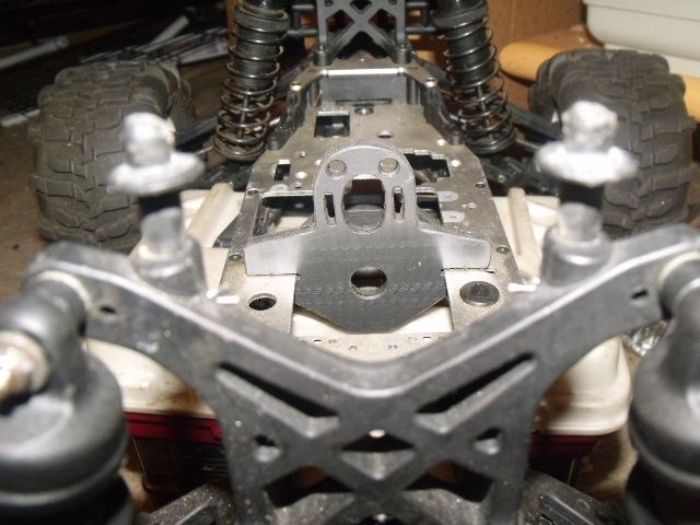

I deleted a lot of pics and that is all I can find that could give an idea in what I created.
Servo doesn't hit anymore but 13t is my max
My mounts are non reversible since I made it over the diff
The front end stays down and control is very stable other than some touchy braking with mmb2 set at 2%''
I ordered xo1 hubs and I shimmed on the stub going into the first bearing
I'm thinking getting a new set of better tires than the hpi hot air balloons
Trenchers X or sweep racing off road belted
The neewer motor isn't bad and yes fan is on heat sink of motor not heat sink/fan combo mounted on the motor..
I might put a tekin 1900 on it cause I'm not going over 4s
Thanks for some input ...I got all winter lol
grabbem88 is offline

Oh and my center diff is a hotbodies 48t I did find a team durango 60t that would help a lot but not sure..

Ahh, I see what you did now. Custom center diff mount, not a standard buggy/truggy mount bolted to the center skidplate like I assumed. Well I'm not that familiar Hot Bodies but the HPI Trophy truggy (which is based on the old Hot Bodies Lightning) uses the same diffs as the D8 and the Trophy has a 50t spur gear. A 60t spur is going to slow you down too much, plus I highly doubt a Durango spur is going to fit HPI/HB diff cup. Most 1/8 diffs are pretty darn close in length though, Losi 8ight has a 50t, Associated has up to 54t and would probably fit your mount with the right bearings.
Just did a search on Neewer, looks like the Turnigy Trackstar. The Trackstar is an inexpensive motor that's not really known for ice cold temps. The Tekin should run a bunch cooler even though it's a higher Kv just because it's more efficient.

I can put any 1/8 center diff in it and I had the HB in my parts bin so I used it.
My driving style is probably 99% the problem and these hpi wheels balloon to like 9 inches and heavy
My motor rpm is 25k and I'm at 11.35 on gearing on the calculator

Originally Posted by grabbem88 View Post
Update:
5s lipo
0 timing helped
Trencher x wheels/tires
Silly goofing around back and forth driving 141/150
Hitting short grass ramping wot burst runs
170/180
So either driving style or motor can't hang?
I see a 1717 castle big block in my near future
I'm having a hard time following what gearing and tires you're currently running so refresh my memory please.

Tires are trencher x taped
And gearing is 14/48
My truggy which is lighter obviously
Runs a 17/48
Tires are src terrain crushers and never gets to 130
With a tekin 2050 4030 motor
So the motor has to be my problem not being efficient
This thing does weight 15lbs though.

The motor has to be able to handle YOUR bash session, however hard or easy it might be. If it can't handle some grass and a few consecutive wot throttle passes then you gotta gear it down or replace it. I think 14/48 on Trenchers is too much for a cheap Chinese 4074, 12/50 on those tires would probably be a safe bet.
If you're going to replace the motor stay with 1700kv or preferably less to help with gearing options. The 1717's 1600kv will help a little but the motor's 50mm diameter won't. I can tell you from experience that the 1717 will be really close to the diff output with 12/50 gearing and you also have the steering servo to worry about hitting. If you don't want to rework the mount or chassis layout then maybe you should consider something like a Leopard 4092 instead.

I can get a 13t pinion but 12 will cause motor to be cocked.
I can add a spacer under diff mount I mean tooth mesh doesn't take much to get right or mess up.
An axial yeti xl uses a 2200kv motor and it's huge with a 13lb weight with 5th scale wheels
I know the transmission is different with a 80 spur and 12t pinion could be wrong but 50mph gearing can't be far from me with my diffs being different
After 25 minutes 3.71 on the cells and 171 isn't bad

The Yeti XL 2200kv is a Castle motor anodized gold instead of green. Yeah some of what you pay extra for is Castle's advertising and warrantee (Neewer and the clones have neither) but your also paying for a better motor. Magnet lamination thickness and the copper used are the big determining factors in cost and performance. Thinner laminations cost more but have more performance and greater efficiency, then there's the Nue/Castle design.
But I've already mentioned all that and I'm not going to argue it further. That's why I said whatever motor you choose to run has to hold up to YOUR bash session. If it's not working for you it's not working for you. It's my personal experience and others, that a higher quality 4074 motor (like a Castle 2200kv) should be geared for about 45mph in a vehicle like the LST. Some can away with gearing for about 50mph depending on exact weight and surfaces being run on but generally 50mph and above it's time to look into adding a fan. This is a generalization and is meant for a fairly safe setup where you don't have to be afraid of overheating if you use the throttle. It also assumes a variety of surfaces including grass and summer time ambient temps not cold winter ambient temps. You're nearing temp limits with a fan, in colder ambient temps on grass, draw your own conclusions. And the reason your motor cools down fairly quickly is the because of the fan and cold ambient temps.
Also don't forget you can increase the spur gear size as well. The 50t HPI Trophy truggy spur should fit your HB diff and it'll both give you some clearance and gear you down a little at the same time. A larger spur and/or shimming the diff up would likely be required if you went with a 1717. Awesome motor by the way, have one on my LST XXL feared for about 55mph on 6s, no fan, no temp issues ever. Good luck
