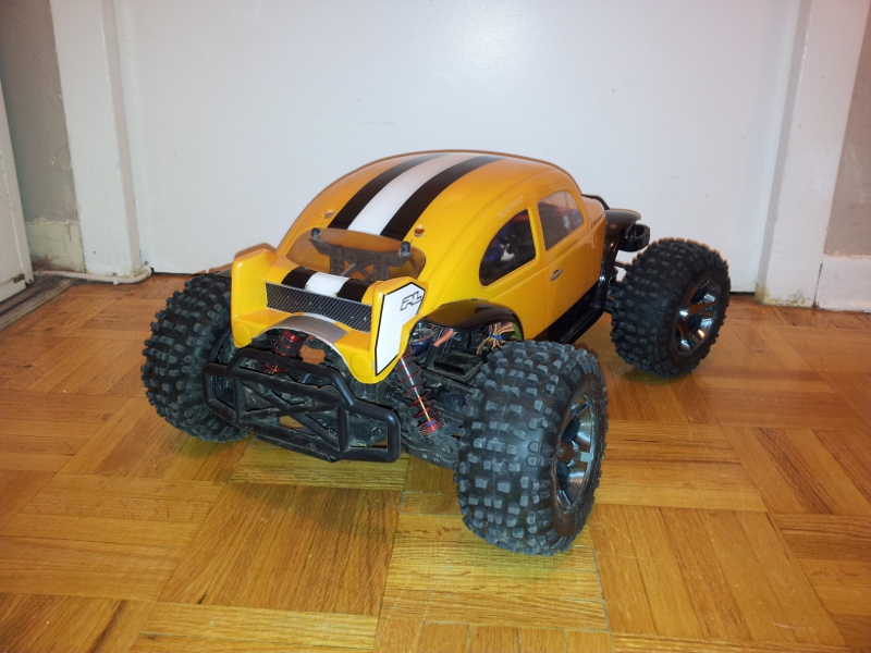

Baby update: I'm waiting on some Traxxas E-Revo springs to arrive (fit right on the Caldera shocks) and some higher body mounts... but I can still test-fit some changes to my SC 10E:
I had the body and tires on a Stampede 2wd (now sold): I have also ordered a new set of Stampede front rims since I need that slightly wider offset to clear the front hubs on the Caldera (the narrower rears fit, but there's not much room). I recycle bodies and tires forever, but if you wanted to make your own bug like this you would need:
2 x PRO117300 Pro-Line Badlands 2.8" (tires)
2 x TRA5576A Traxxas Front Rims
1 x PRO323862 Pro-Line Volkswagon body
1 x BS904-016 (or BS904-017) Redcat high body post set
(Yes, you could also put Pro-Line Badlands SC tires on the stock rims: I already had this set and wanted to keep the stock wheels+tires )
