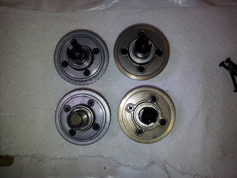

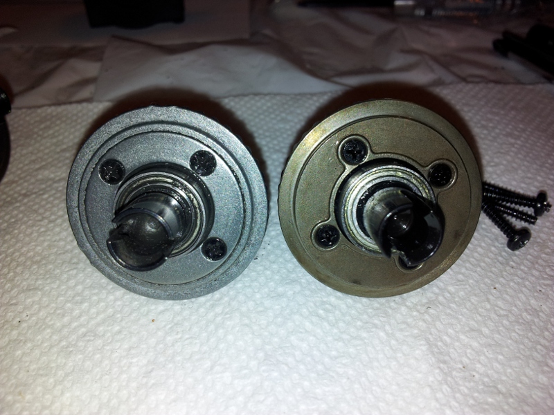

Public Service Announcement
After reading that the Caldera (1/10th scale) had different metal diff parts than the 1/8th and 1/6th BSD's over in the Sandstorm thread... I paid special attention when I opened up my front diff for the second time to fix it. I had spare diffs from my Shredder on hand to compare to...
... and there is a visible difference in the gears. The 1/10th part number (Caldera) is on the left, and the 1/8th / 1/6th part is on the right:
The stock Caldera ring gears that I keep stripping are a plain silver-grey colour, like the dull side of tinfoil, and their surface isn't smooth. The hardened parts on the right have a golden hue and are smoother and look more precise? (difference between injection/pressed parts and a machined part?). The upgraded gear also looks different: it only has a small raised edge tight around each screw hole (so it looks like a "+" from the top) while the stock silver part has that small edge as a flat circle that goes all the way around:
Both the stock parts on the left are stripped and I'll be putting in the hardened versions from now on. If you have diff issues in your Caldera, these are the better parts you'll want to buy:
Just Gears: BS803-027 (upgrade to BS903-105)
Diff Only: BS803-026 (upgrade to BS903-104)
Diff-with-Case: BS803-025A (upgrade to BS903-020)
Good luck!

This is good advice for anyone with a Caldera. My son's Caldera 10e would strip diff gears in a heartbeat. The Caldera parts page does not show a upgraded diff set so I ordered the upgrade diff set for the Earthquake. Just like you said the difference in the gears are noticible. Besides the type of metal being used, the teeth are even machined differently, they almost look a little thicker. I was replacing diff gears in his truck about every 6 weeks " mainly because he is 9 years old and drives it like he stole it". Once I put the Earthquake gears in "about 4 months ago" it's been great ever since.

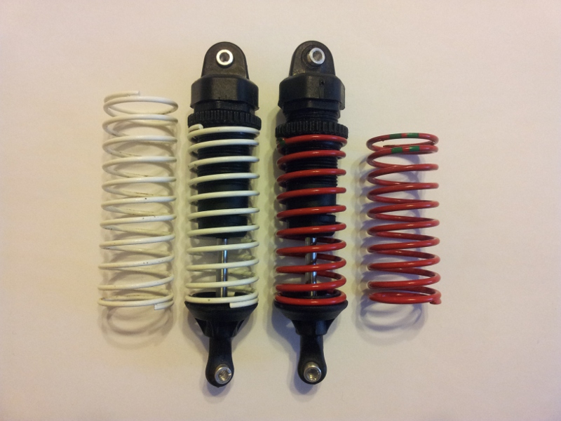

I'm also posting this to URC, but based on some info I saw on RCtech I tried Traxxas GTR springs and retainers on my Caldera, and they worked! Traxxas springs are very easy to find if you'd like to swap them on your Caldera (MT, SC and buggy all use the same shocks)
Stock Caldera shock on the left with stock white spring, and Caldera shock body on the right with red GTR spring (TRA5940) and GTR bottom spring retainer (TRA5465).
