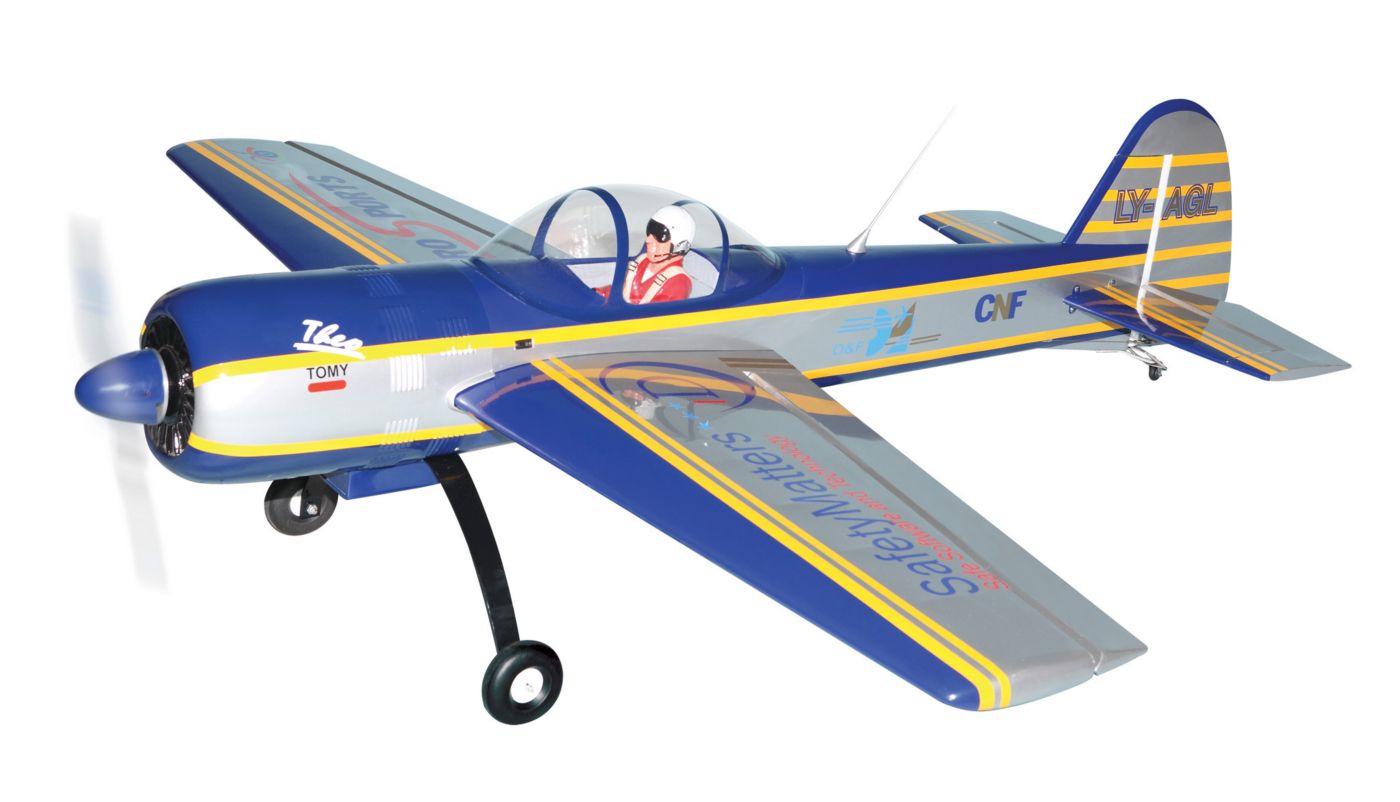

This looks like a good candidate for a DLE 20. But the specs on weight seem too heavy for 3d.

Nice looking Sukhoi. What's the wingspan and weight?

Seagull just came out with two planes. This is one of them.
http://www.horizonhobby.com/products/yak-55m-120-arf-SEA131

Windgap - I see that's a Yak 55, 69". Did you see the spec calling for a 30-35cc gasser? I'd say a DLE 30 would be a much better match than a DLE 20 for that plane. And the 30 is only $50 more. I always prefer better to have MORE power than less. I have a DLE 30 in my 73" Carl Goldberg Sukhoi - that thing is a rocket! Will pull vertical all day. Great engine.

I guess you can tie a rock to a dle XX, with enough power, it'll fly. Unbelievable. Definitely not a 3d bird if it'll require so much engine.

I'm not sure of your point? Even if you were able to keep this plane at it's minimum advertised weight (11.5lbs), it's never going to fly like most would expect a Yak to fly? Most WOULD expect decent 3D performance from a plane like that? I think the old "over powered" airframes are now the norm with these newer lighter gassers.
Still, if you were looking for something aerobatic with somewhat less than unlimited vertical, and only limited hovering, I'll bet the plane would be really fun to fly on a 20cc. Maybe you could even get it under 11.5 pounds?

ahicks - agreed. I'd think if you want 3D in that plane you'd need more than a DLE 20. But you can always try, I suppose...

anything more than 68" WS and 5 Kg in wt. will not 3D with a DLE20. This baby is above the threshold on both accounts and so a 30 it has to be.... See page no. 1 of the DLE20 thread.
I will recommend a DLE30 with an 18x8 or 18x10 for it.
