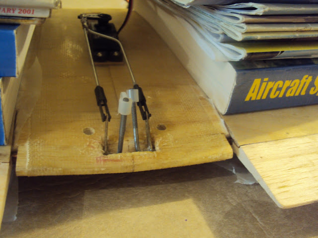

Working on the airbrakes:
Will continue...

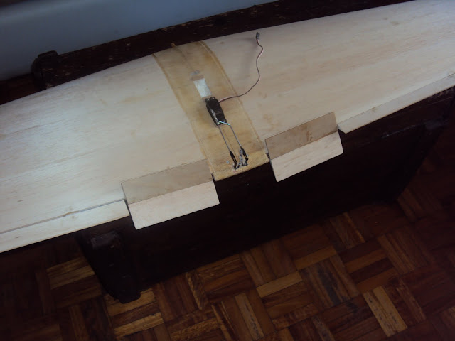

Working on the spoiler control system:
I´m planning to weld two pieces of brass strip (with holes in it like hinges) on the spoiler torque tube in order to get more glueing surface. What do you think? Does the weld will be affected by engine vibrations?
Will continue...

good to see you at it again. I think your flap/spoiler rig will work. The welding of the hinges is where the idea of JB Weld came into play. For whatever reason, that stuff will hold two parts together almost indestructibly. It is also less susceptible to vibration as it is an iron laced epoxy. Provided the surfaces are roughed up, you can "weld" them together and they will stay like that forever. It is also great stuff for welding copper couplers on to CF or steel pushrods. Much better than welding if you ask me.
For future reference and use if it comes in handy.

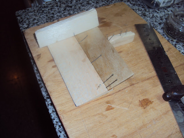

pimminz: too late! I have just glued the spoiler flaps with J-B Weld. Them look good, maybe all the stuff will be together, I hope...
Some photos of the process:
Now I´ve to adjust the travel and make them work properly.
Will continue...

Working on the ailerons actuators:
With the flaps-spoilers retracted you can see that they are aligned withr the ailerons. That´s good!
Will continue.
