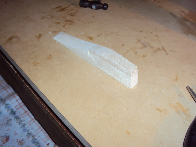

Tail skid.

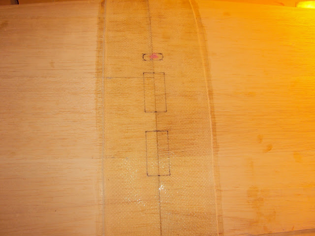

Aileron and spoiler-flaps servo instalation.

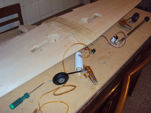

Working with the landing gear.

RE: Curare construction ARG - 9/14/2011 3:12 PM
vasek
Posts: 3642
Score: 147
Joined: 1/24/2002
Last Login: 5/23/2013
From: Prague, CZECH REPUBLIC
Status: offline
Hi chino, I like the speed of the retracts. Did you use just regular air restrictors?
Thanks,V.
_____________________________
Remember: Speed is life!
Hide Signatures
(in reply to chino_2005)
       Post #: 92
RE: Curare construction ARG - 9/14/2011 5:11 PM
chino_2005
Posts: 262
Score: 100
Joined: 6/17/2010
Last Login: 5/10/2013
From: Buenos Aires, ARGENTINA
Status: offline
Hi Vasek,
In this video I used two standard robart restrictors ( http://www.robart.com/products/air-line-restrictors).
Chino
I
Hide Signatures
(in reply to vasek)
       Post #: 93
