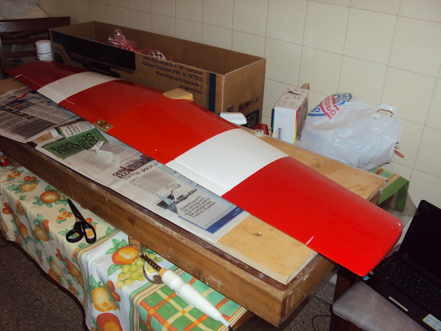

Covering the bottom wing and stab.
Will continue...

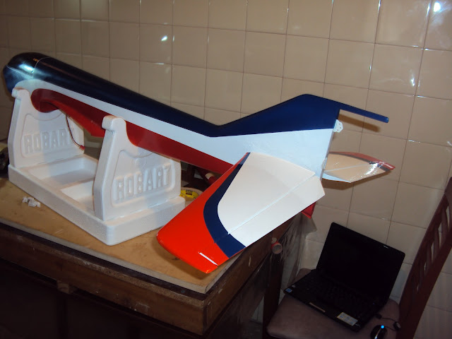

Here is how the Tipo will look from the bottom:

Cool!
How will it look from the top...?
BTW, it is probably an optical illusion but it looks like the main gear is ahead of the CG. I'm sure you installed it per plans.

Yes!!! I´ll check it, but the main LG is in line with the CG. I don´t know if this is correct....

Not inline, just aft. If you put her on her legs and pull the tail down to the ground, dry, it should stay there. Of course, it should also sit on all three's if just put down. When wet, she'll definitely pop back on to the nose gear if you pull the tail down.
The idea is that you can "flare" her on to the mains as she lands and will drop on to the nose gear even when she's empty.

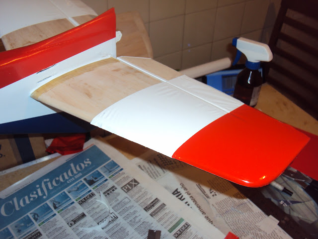

Finally... the rudder!
