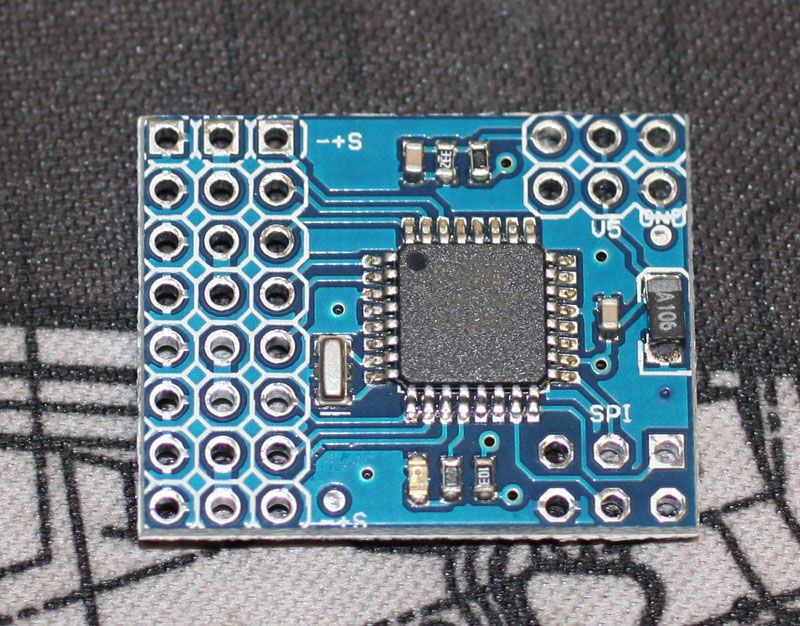

 I finally got my hands on one of the futaba 8 channel single stick transmitters from the late 80s and early 90s and decided to see what it would take to do a conversion to Spektrum DSM2.  From my web searching, there was basically one option due to the 8SSAP being PCM 512 only- Change the radio guts with a newer radio.  To me, that seemed expensive so I came up with a new plan.  My first thought was to make a PCM decoder with a PIC or similar processor but I quickly gave up on that.  So, after a couple days of pondering the problem and seraching for a futaba PCM512 decoder, I realized I already had one- the receiver!
I'll post pictures and go over the complete process once I am done with the image editing.  I can also answer any questions for others that want to do a similar conversion.  In total, I spent $75 plus the 8 Channel PCM512 receiver.
Okay, here are the parts:  THe blue circuit board is an 8 channel ppm encoder from DIYDrones

So here is the basic plan-
Since I have PCM 512 from the radio but no PPM, I had to figure somethign out for the conversion.  Having taken the r118gp receiver apart before, I noticed the RF and PCM boards are separate and thus the PCM board is easily removed and connected to the new PPM encoder.  So the "new" module connects DSC wire, the PCM board of the receiver connects to the PPM encoder, the PPM encoder then connects to the PPM pin of the DM8 module.  HIt the switch and you are transmitting on 2.4GHz with a PPM signal.

As you can see there are only a few wires connecting the PCM and and RF boards
  • White- PCM signal
  • Red- Batt+
  • Black- Batt-
  • Orange- B+
  • Yellow- DSC control
I delsoldered all wires from the PCM board as well as the servo connector board.
Then, connecting each of the servo outputs of the PCM board to the PPM board
Hide Signatures

 Here is the finished PCM/PPM transcoder
The yellow wire is the new PPM out  Connects to PPM pin of DM8
Red is battery +  6-15 volt
Black is -
White is PCM 512 input (this connects to the DSC wire of the transmitter)
Next is a picture of the test setup
Here is a picture of the PCM waveform (white wire of transcoder)
The PPM waveform being fed to the DM8
And finally one of the servo outputs from the DSM receiver
