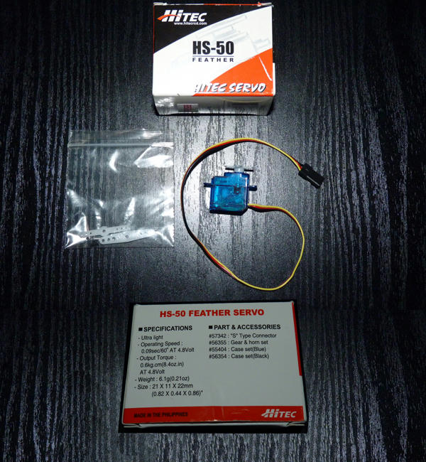

Looked really cool to me, the motion looks really nice do you have a picture of these servos, where you get them and the cost

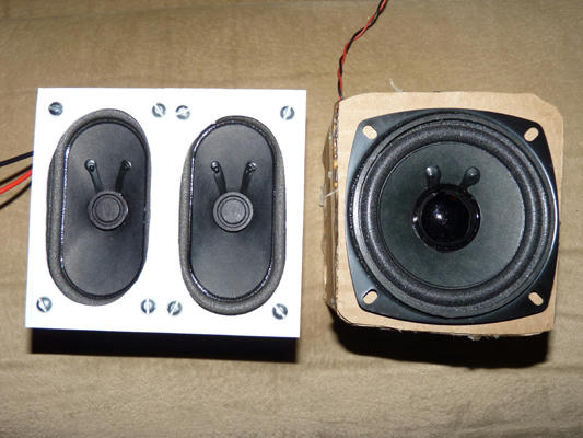

what kind of speaker are you using?

The servo I used was the Hitec HS-50:
The speaker I'm using is the Visaton FR8 - 8 OHM:
FR8
8 cm (3.3") fullrange speaker with good bass reproduction, balanced frequency response and high efficiency.
Especially suitable as built-in speaker for music reproduction and as driver for 100 V network column speakers.
Typical applications:
- Narrow network column speakers
- Control speaker for electronic devices
- Ceiling-mounted speakers in railway carriages and busses
- Electronic musical instruments
Attributes:
- Moisturised cone
- Metal basket
Technical Data
Rated power 10 W
Maximum power 15 W
Nominal impedance Z 8 Ohm
Frequency response 130–20000 Hz
~ Craig ~

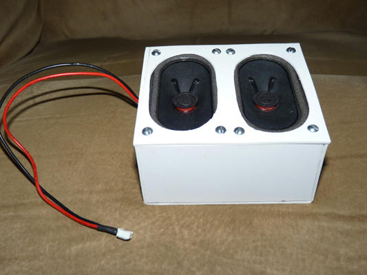

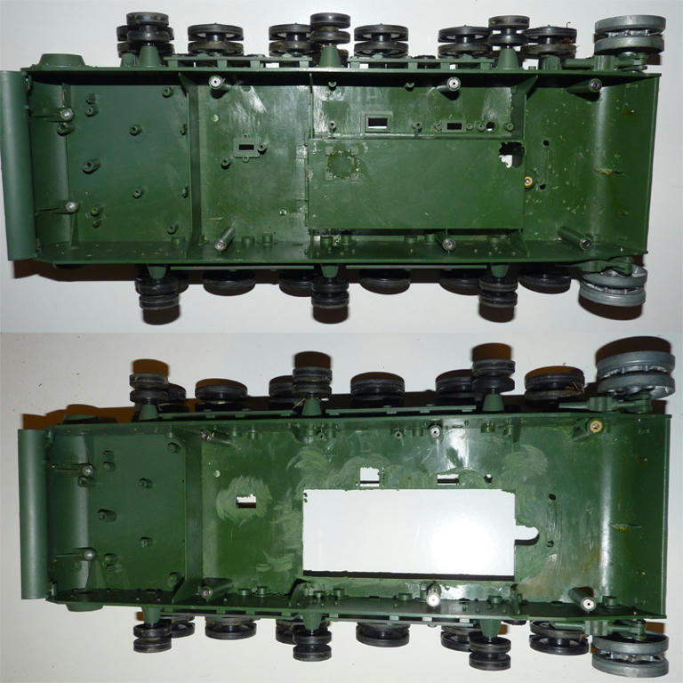

So I had done a little (very little ) work on the KV-1 hull to get it ready for all the new installing I'll have to do, like mounting the new Clark board, battery, new speaker system, new smoker .... here's just a simple compare shot of before / after of the lower hull with some of the interior plastic cut out . Now I need to glue in some heavy plasticard, in that whole area ... thinking about using 1.5mm or 2mm thickness. I'm also going to cut off all those plastic gearbox mounts on the far left side of the hull, then build that all up with plasticard too so the gearbox plates will mount more securely & flat instead of up on little pegs.
I also decided to try testing a dual speaker box setup, using twin Visaton SC5.9 8006 10W 8 Ohm speakers in parallel, making the impedance 4 Ohms total for the setup.

I made a new video recording comparing the TK20E-US board using my dual speaker setup & a single speaker setup. Audio was picked up very well at about a 60-65 foot range with my Panasonic Lumix FZ-35 camera's built-in microphone.
There was a TON of outside interference noise the entire time. I had planes pulling gliders up all day, flocks of geese going overhead, crows hanging around, & a neighbor decided it was a good day to use his heavy equipment doing some "light" yard work . I tried multiple times to get a clean recording .... but I just couldn't get anything to cooperate for a solid 5 minutes , so I was left settling for what I used.
Unfortunately the loudest & most background interference noise was when I was recording the dual speaker setup.
~ Craig ~

I would have expected the speakers being driven at 4 ohms to be loudest, so your test confirms that.
The secondary sounds when the engines were running were not bad at all except maybe the cannon firing. That is a trade off though. You can't have a booming cannon sound and expect to be able to hear the regular sounds at 65 ft.
Did you notice any heat build up in the amp running speakers at 4 ohms.?
Not much wrong with that board. It will be interesting to see how it battles with Tamiya tanks, I think it is fair to say the audio side of it checks out pretty good.
