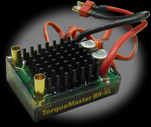

Assuming you drive your RC Boat using Brushed power, anyone out there have looked into these?
http://www.robotmarketplace.com/products/0-HH-TMBRXL.html
2s to 6s lipo input
onboard 6v 5a switchmode BEC
46x34x20mm
38 grams (with battery wires)
Brushed only
80a continuous, no single 540 motor limit
Reverse and brake adjustment
and......................................................
The following don't seem to have any reverse but, I was wondering if there is any device out there such as a Solid State Switch to be installed between the ESC and Motor and reverse the Polarity of the motor leads going to the ESC? Hum.....

Hi Carlos,
Most if not all of the high amp ESC's today do not have reverse. I think they stop around 40-50 amps max then it is all forward only. Hopefully someday this will change but as of now reverse is limited to low amp applications (below 40ish).

Rich,
I must agree with your views as I found this threat discussing pretty much the same thing:
http://www.rcgroups.com/forums/showthread.php?t=928926
However, How about the TorqueMaster BR-XL as it comes with stock with Auto lipo LVC, Full drag brake, instant reverse, and 100% reverse throttle settings, onboard 6v 5a switchmode BEC, 80a continuous, Fully Computer programmable via Castle Creations Castle Link with instant firmware upgrades, and most importantly, Designed and made in the USA! ???
