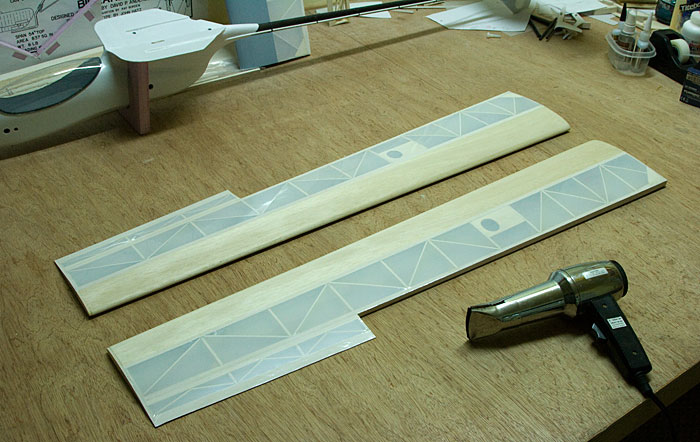

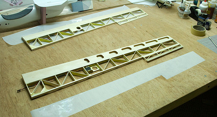

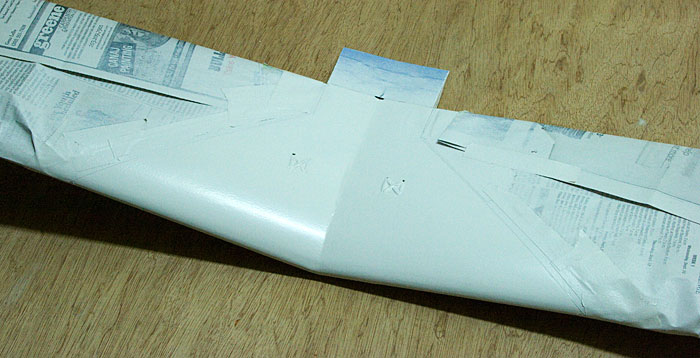

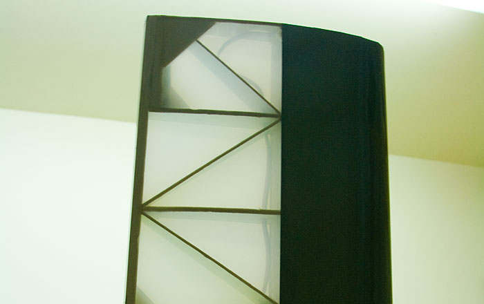

Wrapping up the wing (again)

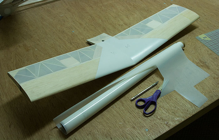

Apparently Untracote doesn't stick well to spackling. So I decided to re-mask the wing & paint the fiber-glassed center area...
Usual thing, took 20 minutes to mask her, 30 seconds to apply the paint...
Next I set about applying the covering...
Transparent white on the open structure, gray on the sheeted sections...
Love the way the light shines through the wing, that should look real nice overhead...
Well that's enough for today...

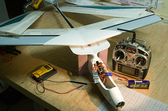

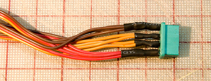

The wires don't reach
I've never been one to use pre-made servo extensions as it's not that difficult to solder together a custom length of wire if need be. Here's a great tip I picked up watching Bruce from xjet & rcmodelreviews on YouTube.
First I cut off the servo plug & find myself a spare length of servo wire...
Next I stagger-cut the wires so the connections aren't all in the same spot...
Bare the ends...
Twist them together...
Add a smidgen of solder to each...
Bend em over...
Slip a length of heat-shrink over the whole thing...
And we're good to go. I like this technique, no need to fiddle about insulating each wire separately. Thanks Bruce...

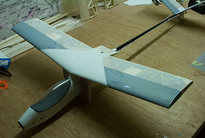

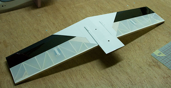

Back to the covering
I added the black visibility panels...
Started work on the outboard panels...
That'll do for now, more soon...

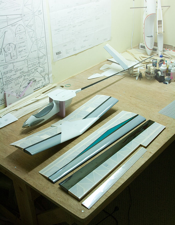

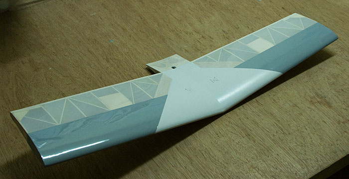

Got-ya Covered!

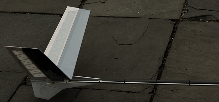

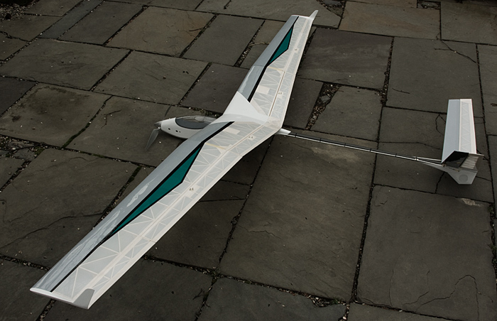

Finally finished up the covering today...
I know you probably want to see how she looks assembled but I'm an evil bugger, you'll have to wait until she's complete. We're getting real close though :-)

It looks decidedly "bird-like", especially that fuselage! One thing that caught my interest is how much that transparent white covering looks like fabric- kinda retro in appearance.

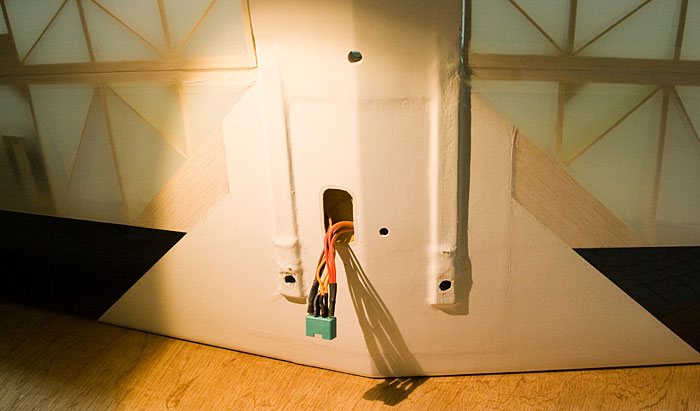

I picked up this nifty six pin connector to power the wing...
I wanted to avoid having four connectors, one for each of the wing's servos. The red positive wires connect to one pin, the brown ground wires connect to another pin. Then each of the four orange signal wires goes to its own pin...
I'm still deciding if I should glue this in solid or leaving it loose...
Here's the other end exiting the bottom of the wing...

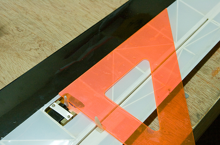

Shockingly, everything seems to be working. That never happens! *grin*...
Now that the servos have power I can proceed with installing the flaps & aileron linkages.

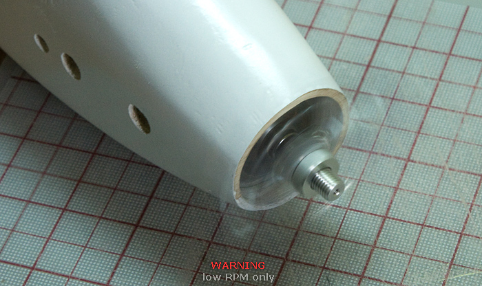

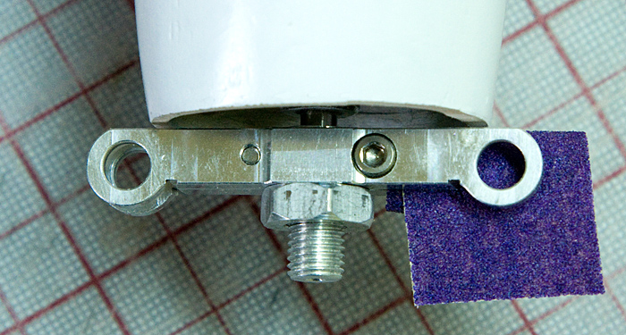

WARNING: The following technique has the potential to go horribly wrong in all sorts of unexpected ways. If you try this take extreme care.

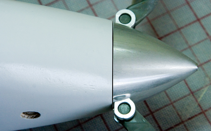

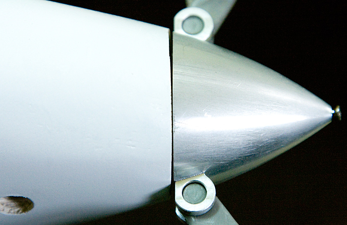

Although pretty close, I noticed the gap between the fuselage & spinner was pretty uneven...
Then I had an idea how to even that up. I slipped a piece of sandpaper onto the folder's hub...
Then I powered up the motor to around 10% & let the sandpaper do its thing...
That worked pretty well, nice even gap...

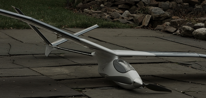

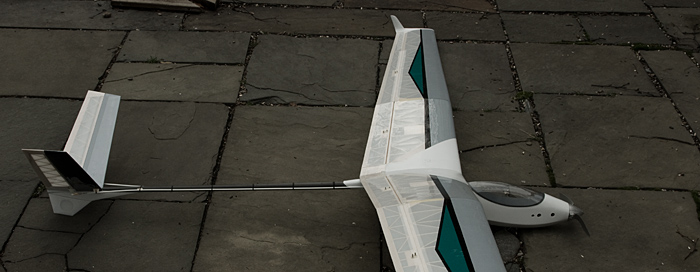

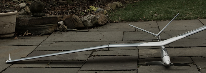

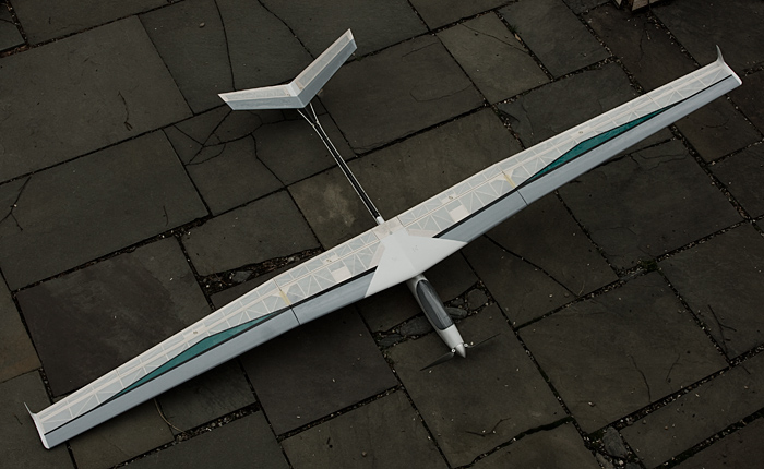

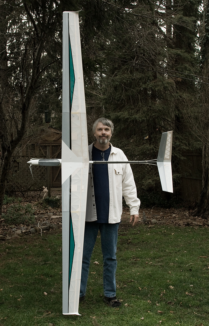

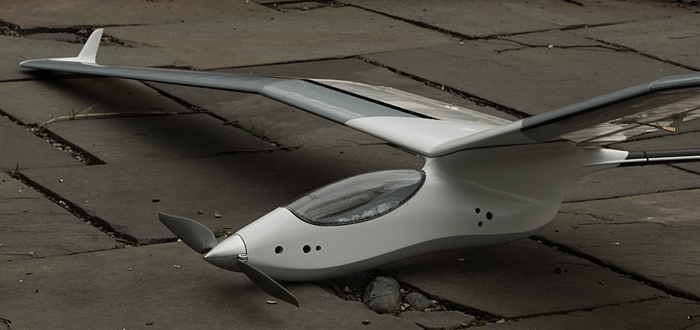

And then I realized there was nothing further to do...
COMPLETE!
Seven months in the making, she's finally ready to fly, woohoo!
No matter what happens from here on out, that was a great build. I've learned so much, couldn't have done it with out you folks here online. A heart-felt thanks to everyone who contributed.
wingspan: 105" (2667mm)
weight: 69 oz (1956 g)
wing loading: 12 oz/sq.ft (38 g/sq.dm)
cubic loading: 5.21 oz/cubic.ft
stall speed: 17 mph (28 km/h)
I was hoping to maiden her this Wednesday but the forecast is for rain/snow. I'll keep you posted. And yes there will be video, flight reports & all that good stuff. Thanks again everyone.

Gorgeous! I am sure you mentioned this earlier in the thread, but what CAD software are you using? The early renderings look great.

RE: Scratch Designed/Built Sailplane Fuselage - 1/16/2013 2:40 AM
Nodd
Posts: 336
Score: 115
Joined: 2/1/2012
Last Login: 5/17/2013
From: Fairfield, CT, USA
Status: offline
Thanks guys. Yeah I'm pretty pleased with her.
quote:
ORIGINAL: thailazer
I use a combination of software...
3D Studio MAX
I use this for modeling my designs in 3D. It's total overkill for our hobby but I use it for my graphics business & it's what I know. There's plenty of free/cheap CAD software out there that'll do the basics.
CorelDRAW
I have a really old version of this from the '90s. I use that as my 2D vector editor. It's great for drawing shapes & printing plans. Again this is what I know so it's what I use. These days Adobe Illustrator seems to be the vector editor of choice. In my opinion that's become bloatware though. I like my simple uncluttered CorelDRAW, gets the job done without any fuss.
PhotoShop
Used for manipulating photos & other rasta based graphics. This is usually the final step in creating my graphics. It's where everything comes together & gets pretty.
quote:
ORIGINAL: longsoar
Nodd,
Looks great! Congrats!
I have one question - with full down flaps and ailerons is there still a gap between them? Looking at the pictures it seems they may touch. Not a good thing in the air.
Looking forward for great flight videos!
Maybe some day we can fly together - I am like 2 hours away in PA.
cheers
Mark
I'll be at most of the New England RC events again this year. Chances are we'll bump into each other. Just look for the guy in the goofy hat & amber sunglasses *grin*
Yeap it seems I have an issue with control surface binding just as you predicted. I want to include my fix in this build log but it's something better suited to video rather than still photos. So here's a short video illustrating the issue & what I did to fix it...
Click here to view the YouTube Video
_____________________________
Nodd
Check out my YouTube videos: http://www.youtube.com/user/noddscipie
Hide Signatures
(in reply to iron eagel)
       Post #: 121
