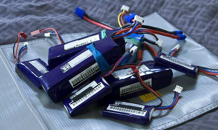

I'm likely dragging up an old topic here so my apologies if so. I'm looking for current advice on current tech (most relevant threads I found were several years old).
I'm trying to get a feel for how most folks maintain their LiPo batteries. We all know its bad to keep them fully charged between flying sessions. We're supposed to maintain them at "storage voltage" (approximately 3.8v per cell) while they're not in use. I have a couple of problems with this though...
  • I fly several times a week. That's a lot of work to charge/discharge all my batteries between flying sessions. Time consuming & labor intensive.
  • Keeping the batteries at storage voltage means I can't go fly at the drop of a hat. I have to plan ahead if I want to fly.
So like many, I've been abusing my LiPos by keeping them fully charged, all the time. Most have started to puff & now fail to balance properly. As a result I'm also seeing greatly reduced flight times, not good. So what to do?..
First off, I've invested in some new batteries. I'm considering buying a "quad charger" that can deal with as many as four batteries at once. There's several fairly cheap four-in-one chargers I'm looking at (I'm between jobs so need to do things on the cheap). My current plan is to do one of the following...
Pre-Charge
The night before I fly I'll bring all my batteries up from storage voltage to full. That way when I get to the field the next morning I'm ready to roll.
Charge-on-demand
The problem with pre-charging is I don't necessarily use all my batteries when I fly. So some inevitably end up being unnecessarily cycled. So maybe I should charge my packs at the field, only as required? My new nano-tech LiPos can be charged at a high C rating, so theoretically once I get to the field, I can decide what I want to fly then fast-charge up a pack or two & start flying.
So I think for either of these methods to work efficiently, I'm going to need the ability to charge multiple packs at once. My question is, what do you folks do?

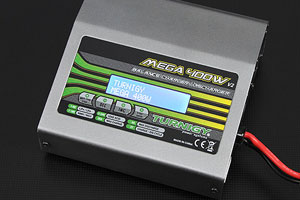

Turnigy MEGA 400W V2
Price $71.73
1 x 400w
Parallel fast charge four 2200mah 3S LiPos at around 4C in approximately 18 minutes.
Great price, lots of power, fully featured.

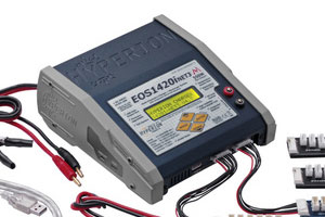

Hyperion EOS 1420i NET3
Price $129.95
1 x 550w
Parallel fast charge four 2200mah 3S LiPos at around 5C in approximately 14 minutes.
Quite a bit more money but lots of power. Quality brand, comes highly recommended from clubmates.

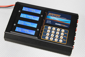

HobbyKing 4B6
Price $77.29
4 x 50w
Fast charge four 2200mah 3S LiPos at around 2C in approximately 36 minutes.

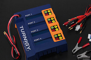

Turnigy 4x6S 400W
Price $116.99
4 x 100w
Fast charge four 2200mah 3S LiPos at around 4C in approximately 18 minutes.
Good power per port, fully featured.

The top two will not do the job you've described. They will both be limited to 20 amps and will do an equal job since it is this 20 amp max that will be found first. The bottom one will do the job the fastest. Sorry I can;t answer your question though. (lot of help, right?)
I like your idea, buy the 4 port now and then buy the top one later.

I like my 306B and leave it set to 30 amps all the time. I've also had my eye on the 100x4 since it's the biggestbest 4 port charger, 10 amps and 100 watts isn't too shabby for most 3sx2.2 packs. I've also had my eye on the HK 380 wattx20 amp charger.
I don't quite think we will see a higher power 4 port charger very soon , but there are a number of much higher 2 port ones. I've been wanting for a long time for a charger that can "share" the power between 4 ports. Inotherwords 500 watts and 20 amps max would be a nice spec , but with the ability to share that 400 watts between ports. Using all of it on one port if desired.
I think what's import for you to make the decision whether to parallel or to use multi-port charger is this: Are most/all of your packs 3sx2.2 ? and will you be charging them all at the same time? If both answers are yes, the parallel is a good idea. If you needed to place a pack on at different times because someone just got done flying it then the multi-port would probably be best. (starting at different times)
