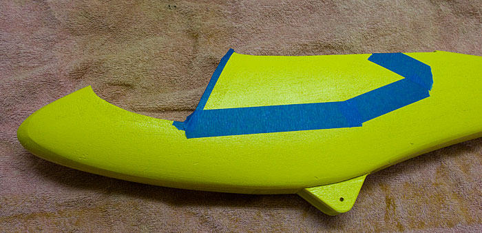

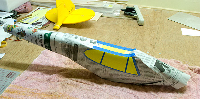

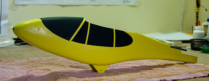

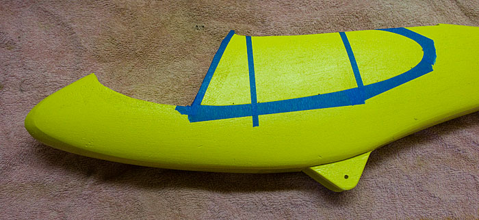

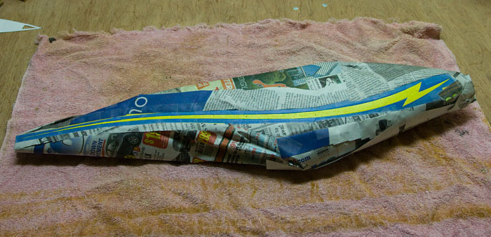

Ahh okay yeah I was looking at the reflection in the tail & thinking how the heck did he get a showroom like shine on a foamie *smile*

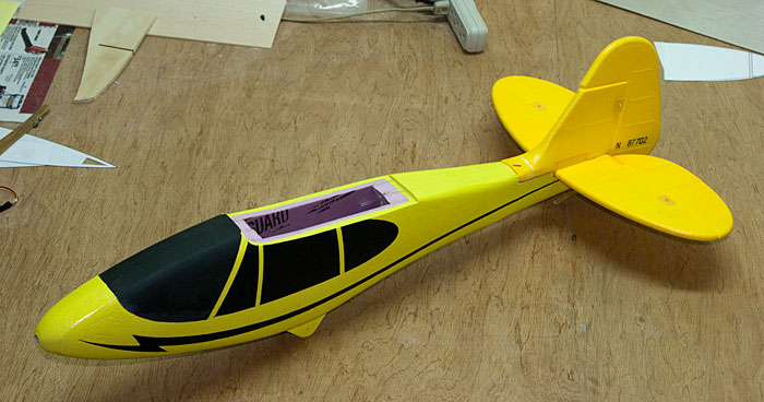

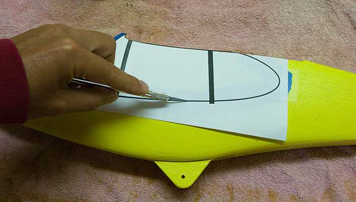

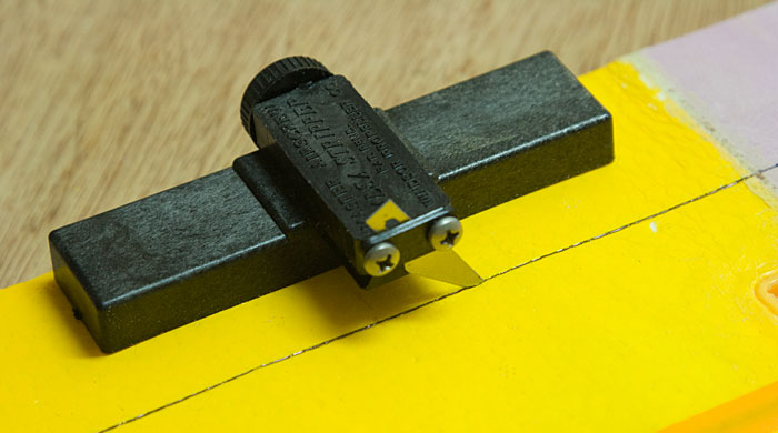

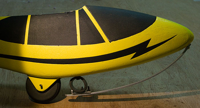

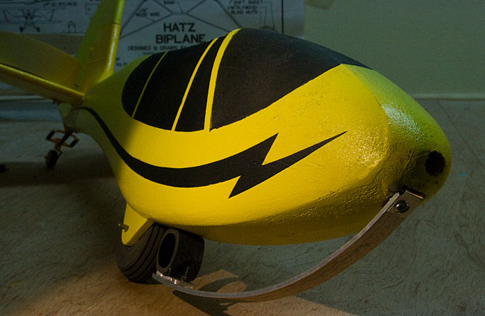

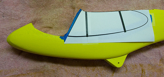

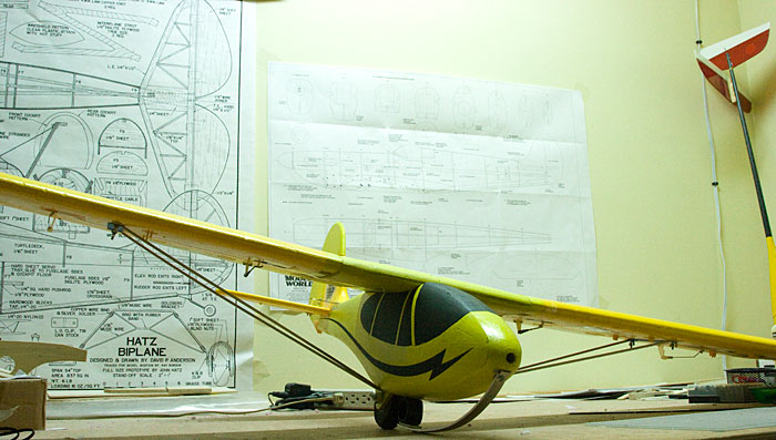

Graphics
The funny thing about spray painting is you spending hours on end masking & then about 30 seconds spraying...
Yet another template, aren't computers great?..

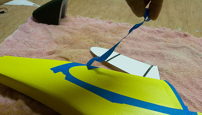

The idea here is to carefully cut through both the template & the masking tape below...
Peal away the excess tape...
Add the window lines...

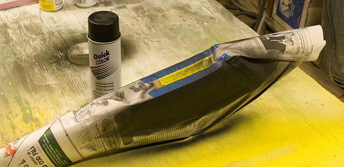

Then wrap her up like a last minute birthday present...
20 seconds of spraying...
And we have windows!..

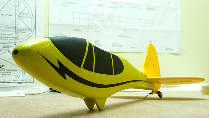

We're not done yet though. Next is the signature Cub, Flash Gordon lightning bolt...
There we have it (the yellow doesn't quite match but what can ya do?)...
Looking pretty snazzy in a Cub sorta way...

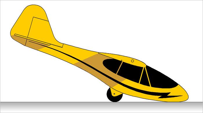

Your concerns are valid there Mark, this is a very short-coupled design. I'm going for a comical, almost cartoonish, look. I'll need to watch the CG & trim carefully but she flies well on my simulator, if not a tad pitch sensitive. Hopefully a little expo on the elevator will tame that. Kinda funny a guy named longsoar has issues with my shortsoar sailplane :-P

Your "Cub Glider" is looking awesome.  Personally, I don't think that the short coupled tail will be too much of an issue.......providing the CG is correct and the throws are correct (ie: I would suspect that you will not want a lot of throw on the elevator).  After all, My Sig Wonder is even more short coupled than the Cub glider, and it flies great.  The Wonder just has a really small elevator with very little throw, and it has lots of authority.
Based on my experience, I would say that all you will need to do is take care to get the CG in the right place, maybe even a touch forward for the first flights, and then tune the CG and elevator throws to get the flight characteristics you want.

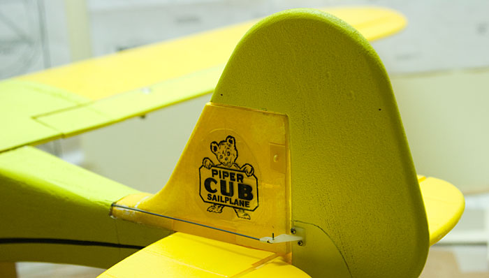

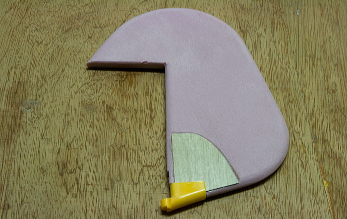

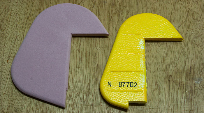

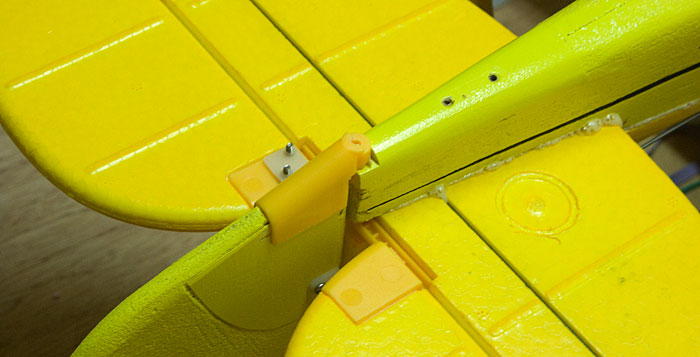

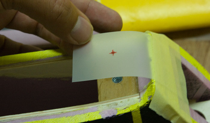

The Tail

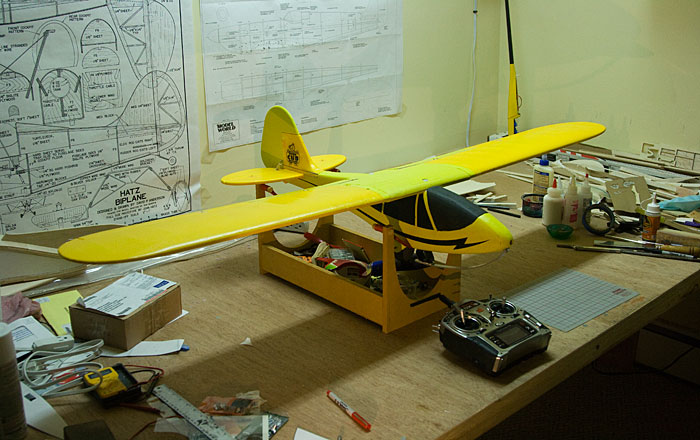

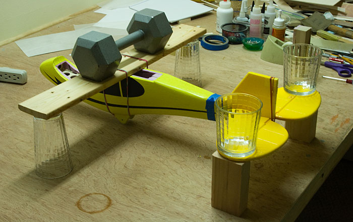

After a little head-scratching I came up with an effective way of squaring up the fuselage to my workbench before attaching the tail...
This should result in a nice level tail that should align with the wing once that's done (waiting on a longer CF wing-rod to arrive)...
The rudder hinge was damaged in a nose-over a while back. I removed it so I could make a proper repair but having it off of there got me to thinking, maybe I should take this opportunity to enlarge the rudder a little...
A fat bulbous nose section, a short-coupled tail-moment & an extended wing are all conspiring to make this puppy a little lacking in yaw authority. More rudder area can only help. So I think that's what I'm going to do, make a slightly larger rudder...

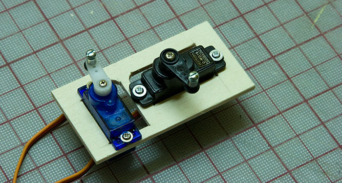

Now that the tail's on I can move ahead & get the rudder & elevator servos mounted & functional. That'll have to wait for the glue to dry though, not sure I'll get to that tonight. We'll have to see.

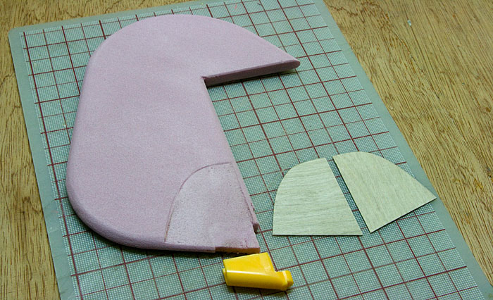

BIG Rudder
Well I got a little more done tonight after all. Here's the new enlarged rudder...
Figuring a larger surface area will translate into more stress I'm reinforcing the control-horn/tail-wheel area...
Reinforcing glued in place...
Test fit...
I think that should help her track nicely while maintaining the scale tail's looks...
I'll put a few coats of paint on her (won't bore you folks with that process) & that'll do for today.

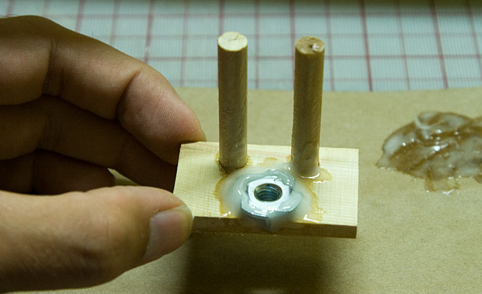

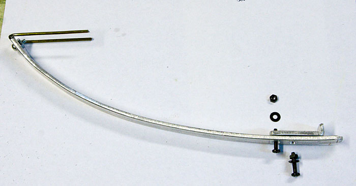

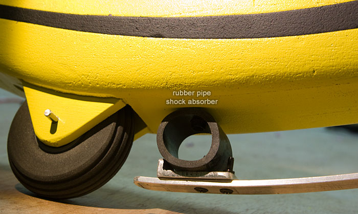

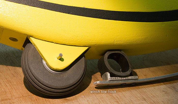

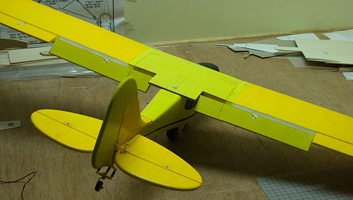

Got the tail-wheel installed...

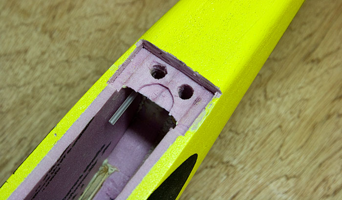

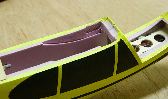

Wing Bolts

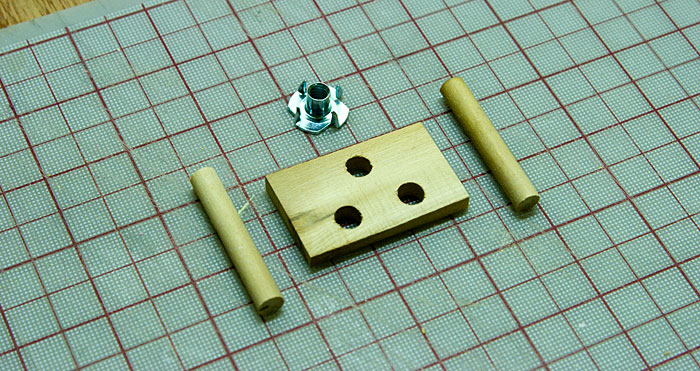

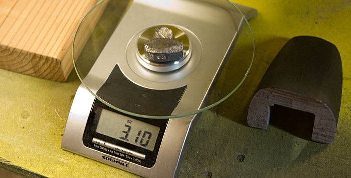

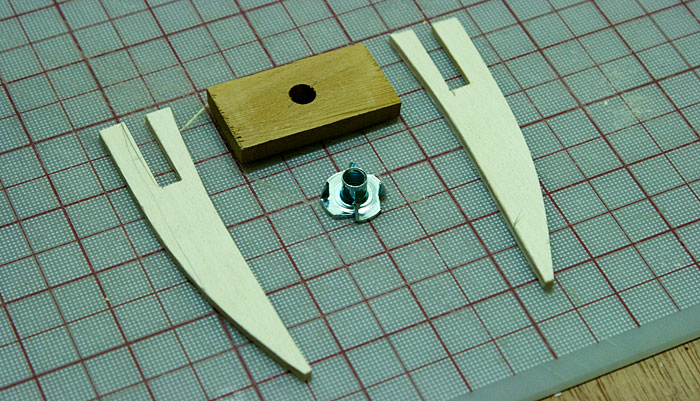

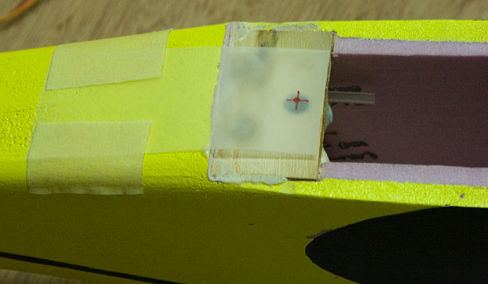

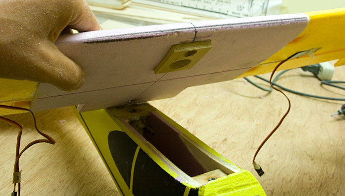

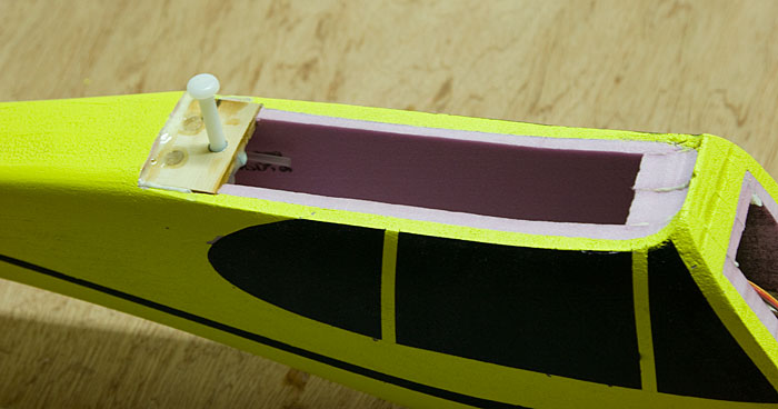

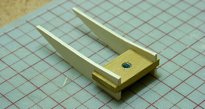

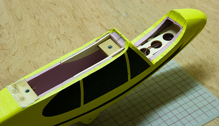

I used rubber bands to hold the wings on for my last scratch build. I'm still getting grief from my subscribers for that decision. So you'll be happy to hear I'm going with nylon wing bolts this time.
Here's a mounting block I came up with for the rear mount...
The two dowels will be inserted into holes drilled deep into the fuselage. Its my hope this'll securely affix the block to the fuselage...
Here's the cutouts in the fuselage, ready to receive the block...
Secured with ample amounts of Gorilla Glue...

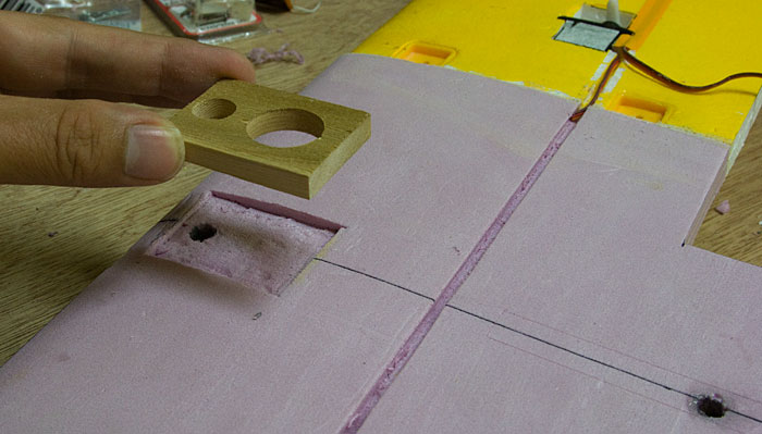

I considered using the peg method for the front but decided instead to just go with a second nylon blot. There's not enough "meat" around the front location to use the same dowel setup as the rear so I came up with this interlocking design...
As you can see the two pointy pieces of ply hold the block in place...
I made some cutouts in the fuselage...
And in she goes...
Its movie night tonight, gonna watch the Avengers with a few friends on my home theater. So that's all for now.

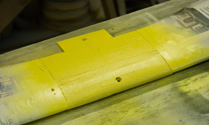

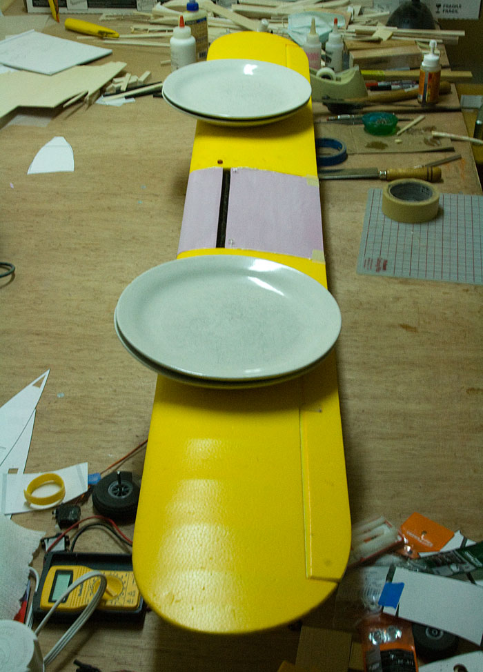

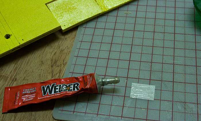

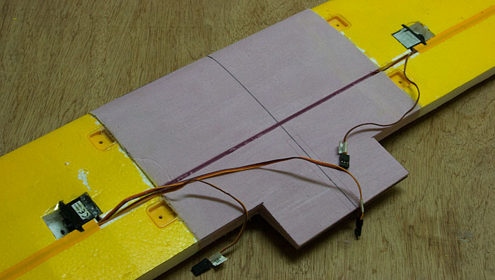

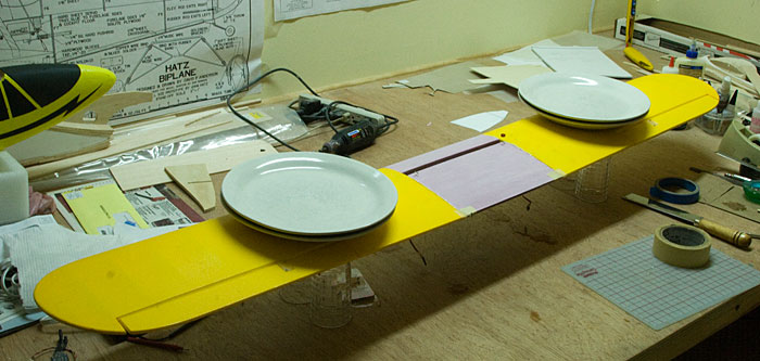

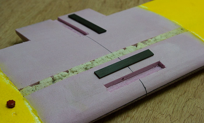

The Wing

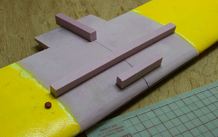

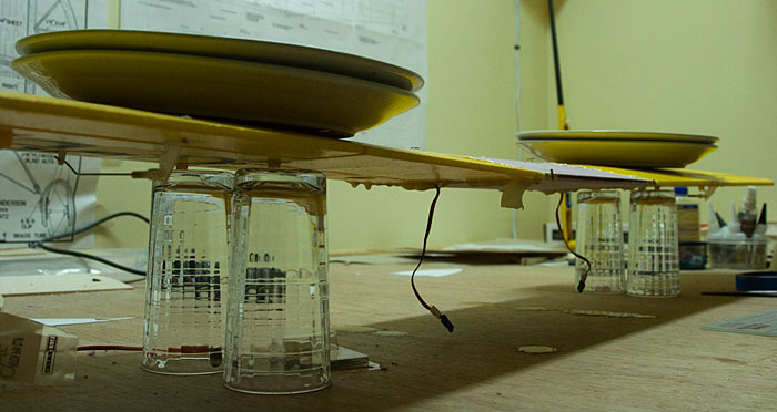

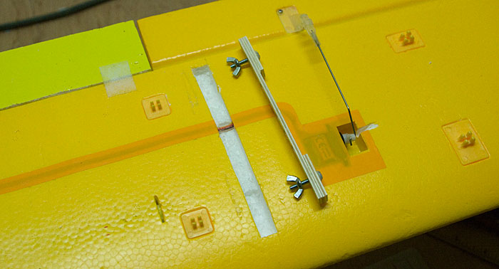

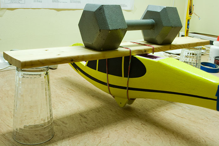

A lot of running out & doing chores today so I didn't get much time to play in the workshop. I did want to get the wing together though as my new, longer wing-rod has arrived from rcfoam.com...
Once again I raided the kitchen cabinets, used these glasses to support the wing, plates on top to weight it down...
I used Gorilla Glue once again. Not only is it seriously strong glue, it has the added bonus of expanding as it cures. That takes care of what to do about the wing-rod slot...
Once that's dry I'll sand the foaming glue flush with the wing. So I'm going to let this sit overnight & let the glue do its thing...
Spending 10 minutes to clear the clutter from my work-bench wouldn't hurt too *grin*

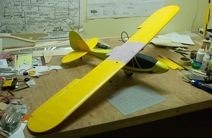

Status: offline

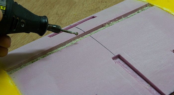

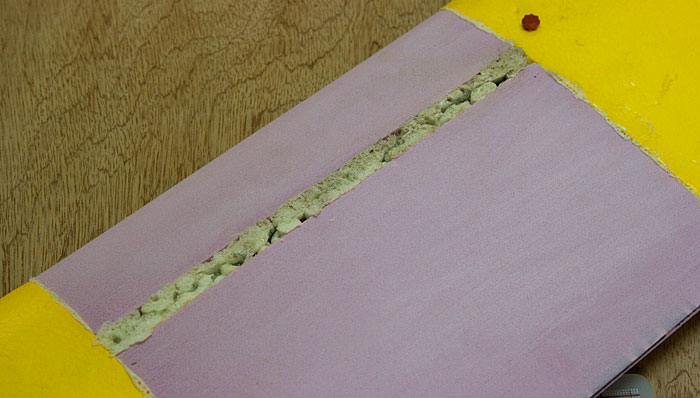

Fun, fun, fun is right, I'm having a blast with this build. A nice low stress, not too serious project to while away the time. Just what I needed.
She's starting to look like an airplane.
Well the Gorilla Glue filled the wing-rod slot alright but geesh does that ever looks ugly...
We'll address that shortly.

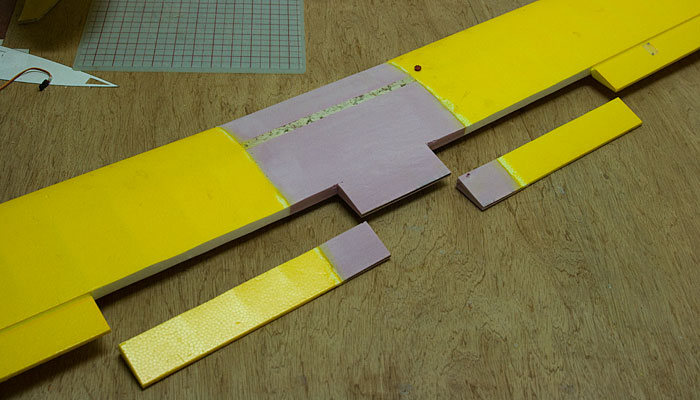

Flaps?
Well this glider already has everything but the kitchen sink, so why not flaps too? I marked out where I figured they might go...

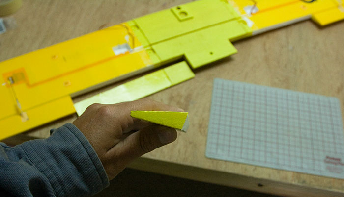

I picked up this nifty tool for cutting strips of balsa but discovered it's also pretty handy for making nice 90° cuts in foam...

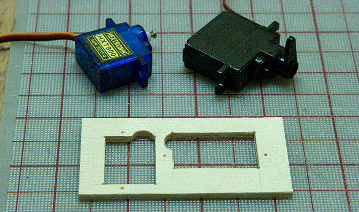

So here's our flaps. They should come in handy for making precision landings & because this puppy is going to be so incredibly good at thermalling, they'll be essential for getting down out of boomers ;-P

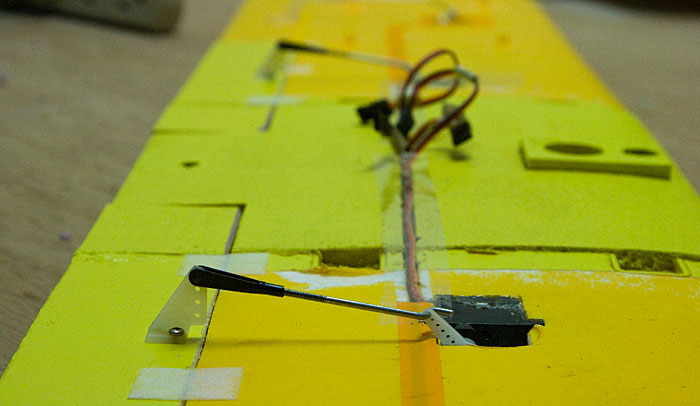

Test fitting the two flap servos...
That brings us up to seven servos in this dinky plane. She's a lean mean full-house machine!
Wing meet fuselage, fuselage meet wing
Time to get this wing mounted up. I needed something more than just Home Depot foam to keep the nylon wing-bolts from ripping through the wing. I cut some scrap carbon fiber into short lengths & cut recessed slots in the wing...
While I had the Dremal tool out I also cleaned out some of that yucky looking Gorilla Glue from the wing-rod slot...
Glued the carbon fiber into their slots...

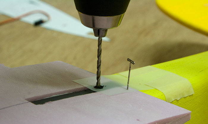

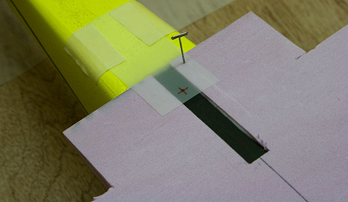

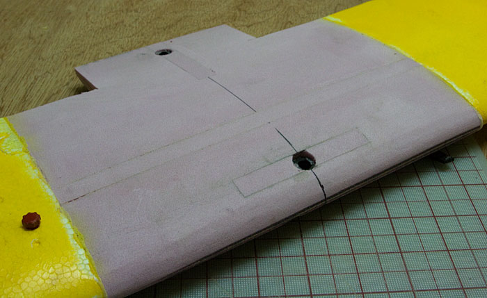

Next I needed to drill holes for the nylon wing-bolts but where exactly should the holes go? Here's a neat trick I learned. Tape some Mylar or something similar to the fuselage & mark the wing-bolt location with a marker...
Do the same for the forward location...
Flip the Mylar back & install the wing. Measure everything so the wing is exactly centered & square to the fuselage...
X marks the spot. Drill away...
I probably don't have to mention that carbon fiber dust is nasty stuff. I use a mask & clean up the work area with a damp paper towel immediately afterwards.

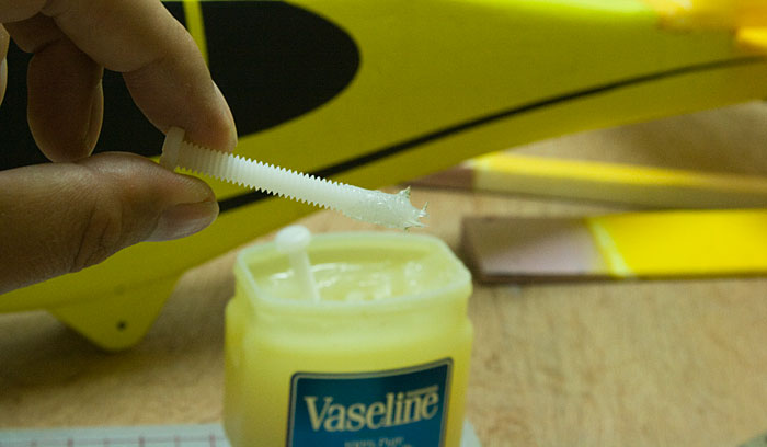

Lubricating the nylon bolts (mind out of the gutter gentlemen)...
I wanted a way to locate the wing on the fuselage so that lining up the wing-bolts would be a snap. The solution was to add a small block that'd index the fuselage...
I glued that to the wing then gave her a test fit...

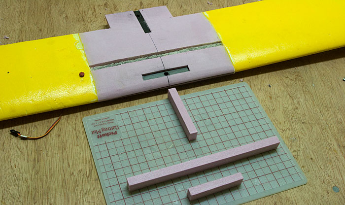

Slots, slots & more slots.
Time to do something about those rather un-aerodynamic slots in the top of my wing...
Glued scrap foam into the slots...
A little sanding & we're looking good...
Pretty pleased with that session, got a fair amount accomplished...
Oh yeah she's starting to look like an airplane alright...
A cute goofy airplane that is.

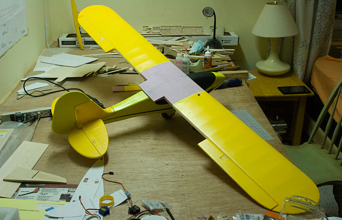

Painting the wing center section...

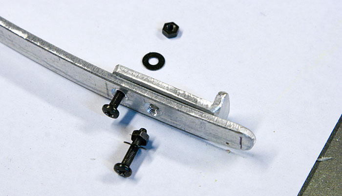

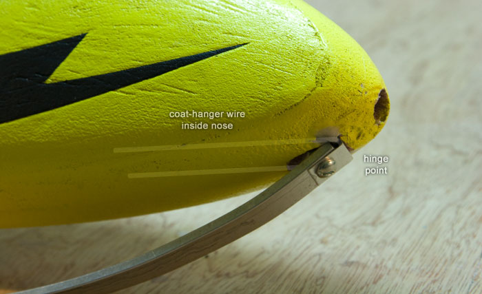

This is no way to start an aerotow.

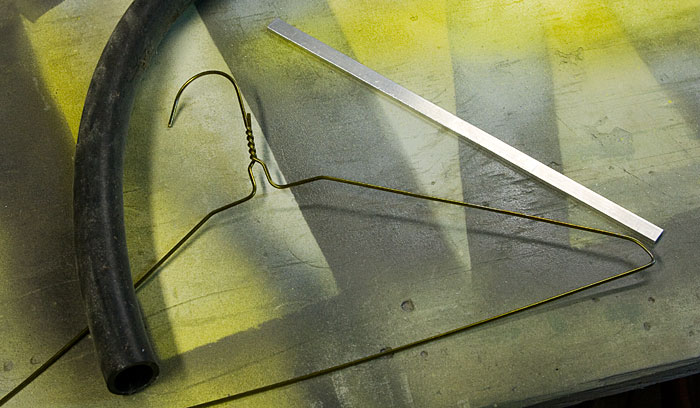

With the wheel more or less at the CG I expect she'll flop forward like this during landings & tows. Not good...

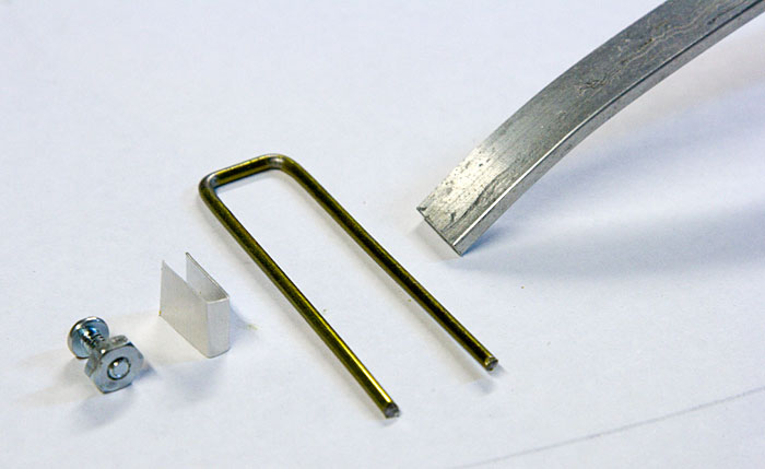

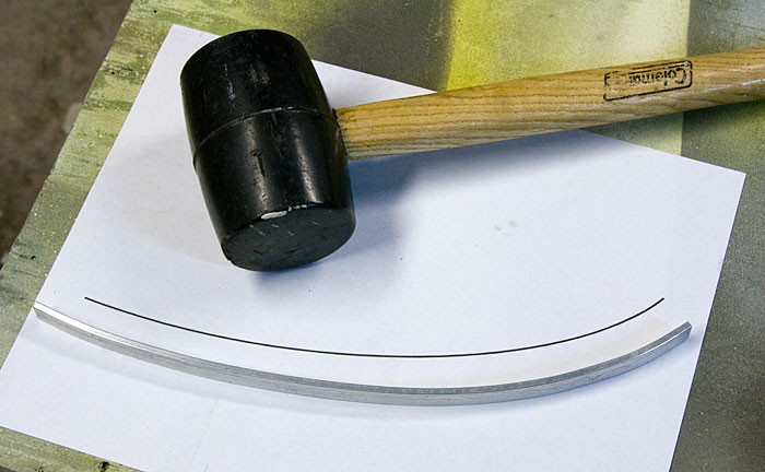

So naturally the solution is an aluminum bar, a coat-hanger & a piece of old rubber piping...
If you've not guessed yet, yeap I'm making a nose skid...
The coat-hanger I bent into a U shape, that'll be inserted into the nose & act as an anchor for the front of the skid. The other hardware will attach the skid to the anchor...
On the rear of the skid I'm bolting this L shaped piece of scrap aluminum...
Here's the skid partially assembled...
The coat-hanger wires are glued deep into the nose...
The rear is bolted to a piece of rubber hose...
The L shaped piece of aluminum is to allow a winch line to be slipped over the end of the skid without getting stuck under the rubber pipe...
Well that should help with ground handling, no sticking her nose in the dirt...
I think it looks pretty cool too, something you don't see every day...
Next I hope to get the flaps & tail-feathers hooked up & functioning. Will post more soon.

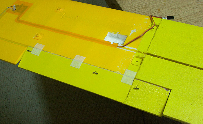

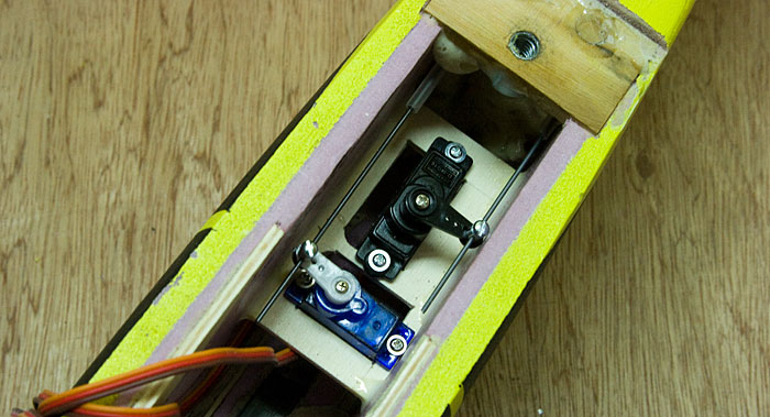

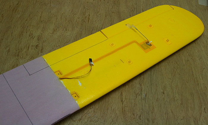

Flaps
I've always wanted inboard flaperons (the flaps also move with the ailerons). So basically I have full-span ailerons with the inboard section pulling double duty as flaps. To achieve this I needed to bevel the flaps a tad so that they could move upwards as well as down...
I'm trying something a little different here by sticking CA hinges directly to the bottom of the wing instead of into a slot. I'm not using CA glue either as for this application, I need something less brittle. This Welder glue is awesome stuff, its kinda like industrial strength contact cement...
With the hinges on the bottom of the wing the flaps have unlimited downward travel. And due to the slight bevel they can also move upwards a few degrees...
Hooked up the two flap servos...
I still need to mess with the mixing but the wing's four control surfaces are all working...
This should be a fun wing, lots of opportunity to mess with flight modes, flaps, crow & other unnecessarily complicated stuff...

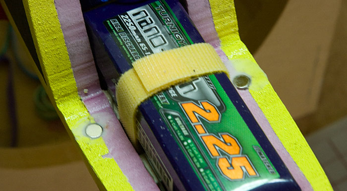

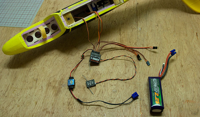

While that's generally true, wrapping up the last odds & ends went smoothly today. The first order of business was to install the radio spaghetti...

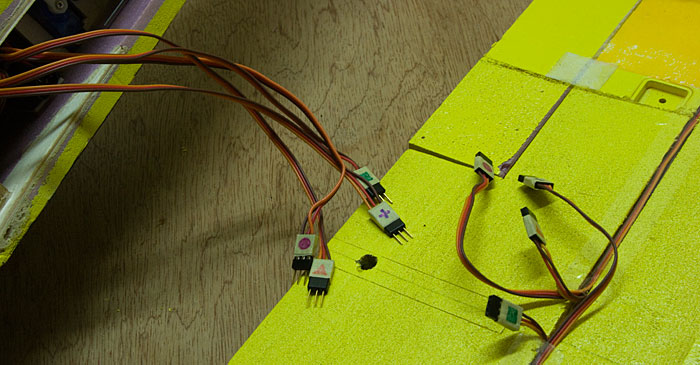

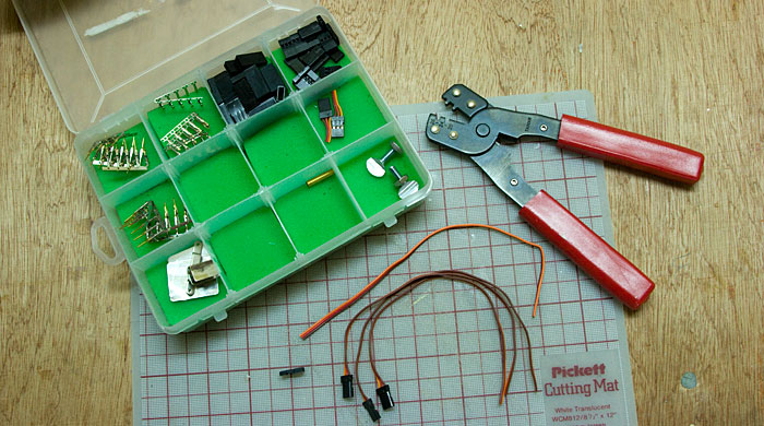

I hate disturbing the receiver by plugging/un-plugging wires when removing the wing, so I made a bunch of servo extensions. This allows me to plug the wing into those instead of messing with the receiver each time...
With all these wires I color coded everything so I don't have to think at the field. We should all avoid thinking whenever possible...
A couple of rare-earth magnets hold the battery hatch in place...

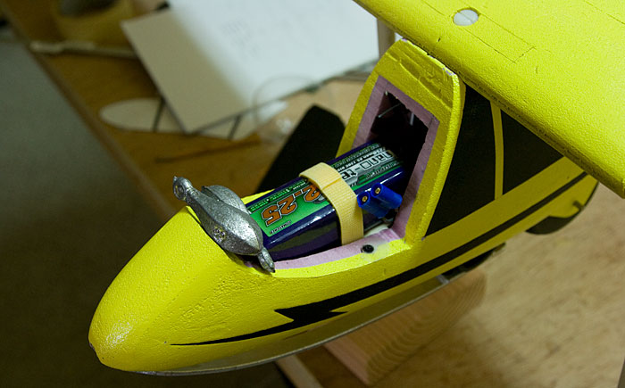

She was tail heavy when I first stuck her up on the balance stand, needing 6oz to level her out at 10% static margin...
To better help balance her I removed the nifty steerable tail wheel. It was useless anyway as the plane rests on the nose skid, with the tail up in the air...
That translated into a few less ounces needed in the nose. I also moved the CG back to 5% static margin & she balanced with just 3 ounces. Much better...
Added a custom Cub logo to the tail...
Well she's all ready to go. Maiden flight time tomorrow, woohoo! Wish me luck.

Struts

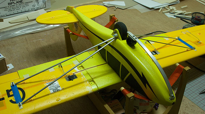

It wouldn't be a Cub without the wing struts. I figured the wheel support  was a good strong spot to start with...
For the wing mount location I created these hard-points...
Cut a slot...
Glued & mounted. The struts are lightweight aluminum struts available at most hobby stores. The blue tape is there temporary to keep the glue from getting all over...
Now that's looking more Cub-like...
Possible maiden tomorrow, although you've heard that one before.

Nose up on highstart was towhook placement as you puzzled over. The highstart pulls "down", the wing lifts "up". The two forces try to line up behind the towline. If the pull is too far aft.....
Sorta the same with the drag on the wheel versus the pull on the towline connection.
_____________________________
Good flying wit ya today
Hide Signatures
(in reply to da Rock)
       Post #: 49
RE: Piper Cub Sailplane - 10/12/2012 5:24 PM
da Rock
Posts: 10904
Score: 265
Joined: 10/11/2005
Last Login: 6/18/2013
From: western, NC, USA
Status: offline
The nose down on tow is probably a torque deal. Drag from the footprint of the tire is at ground zero. Towhook was some inches above ground zero. Tow force will try to line up with the source of the most drag. So the footprint tries to be directly behind the towhook, or the tow point will try to move down to get in line ahead of the drag.
Since the plane was forced into a major nose down pitch, the tow plane was basically trying to pull the planform view through the air. The tow plane could be strong enough to suffice if the hook location was more in line with the drag.
Interesting aside is the wing drag was zip compared to the drag of the tire, with maybe a touch of help from the stuts in the grass.
Were you guys taking off at an angle to the wind? The flag looked like the wind was coming from 10 o'clock or so.
