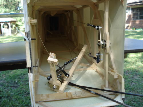

sense you are all on the subject of bellcranks has any of you heard of a idler bell crank?? if so where can you buy them. I have seen them on several big ww1 planes but have never seen one in person. Here is a picture of one

Personally if I wanted to use one servo for two control surfaces I'd set it up with a pull/pull system, a bit more work but by far the best method.

quote:
ORIGINAL: 2.4ghs
Looks like an idler bellcrank is used to terminate push-pull cables; Is that right? Appreciate the photo as I was hoping this thread would yield ideas, photos, diagrams, pros and cons of each system. Things to help a beginner and an old hand as well.

yes sir that is true, I am trying to find something like this and I have searched till im green. I tried contacting the person that posted this on scalebuilder but no response.
It is really a neat set up for a push pull set up.

Here is a link to a manufacturer of very fine products that I have used for years in my giant scale stuff, it is very good quality hardware. Check out the servo trays with idler bellcranks...
http://www.google.com/url?sa=t&rct=j&q=swb%20pull%20pull%20&source=web&cd=2&ved=0CDIQFjAB&url=http%3A%2F%2Fwww.swbmfg.com%2F&ei=1e2yUPCoNIn2qQHq-4CIBw&usg=AFQjCNFMWPV2aK3_UyLdhk8F8321bgLdIg
Bob

Bob that is GREAT, looks like I might be able to use some of this stuff. I am not sure where the guy got the ones on the picture shown as I am scratch building the same type of plane  1/3 scale WW1 sopwith pup.
Again thank you Bob for the great site, lots of great stuff there, love the wire tensioner's

If you would like to build your own robust setup like the one in the picture you can start with the main item you will need and here is a link to it.
http://www.aircraftspruce.com/catalog/appages/bc4w10.php?clickkey=27907
All you will need to do is purchase a some 2024 T3 sheet like .071"-.090" and cut out your arms, drill and assemble, you can find all that you need right from this company. While your in the on line catalog check out the pricing on a 4 X 8 X 1/8 sheet of light ply.
Bob

The pull/pull type of system was used for a lot of full scale aircraft in the old days, using cable and pulleys to route the linkage trough the airframe. I use the Sullivan flexible tubes as the guides for the thin cables that actuate the surfaces. You have to use two control horns for each surface and make sure you are symmetrical to prevent Ackeman but typically the system is lighter and more robust that the bellcrank systems with no slop at all in the control linkages. The beauty of it as far as ailerons is you can use one servo to control both and there is no chance of slop that will induce flutter in the control surface.
Links to information
http://homepages.ihug.co.nz/~atong/
http://web.archive.org/web/20071024183612/http://www.geocities.com/roger_forgues/PullPull.html

Hey Bob that is great, I get a family discount from aircraftspruce as my dad was the original founder of the company back in the 60's and sold to Flow and her sons now own it.
I  thought they looked familar as my dad built 3 full scale homebuilts back when we lived in Van Nuys CA.
after looking at it, it is a bit over kill for what i am doing, you really don't need to get that carried away. I sure do thank you for the info.

quote:
ORIGINAL: iron eagel
Thats exactly what I did on the elevators of my last 2 Lasers. Worked great because the two halfs need to have exactly the same stroke and travel. With ailerons however we do NOT want equal travel so it becomes a very time consuming task to do it mechanically with a single servo.
