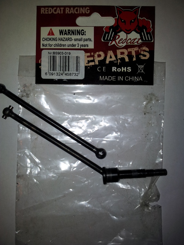

Hi all,
I have a 1/10th Caldera and think it's a good value, and most of the weak points are easy to address (new servo, metal front hubs, keep a spare diff on the shelf)... but I'm constantly bending front dogbones (BS903-019). Moderate front wheel impacts that my other RCs brush off commonly bend one... and as soon as that happens the steering radius gets much worse since the front hub can't turn as far with a bent shaft spinning inside it.
During the summer, careful outdoor driving definately helps when I'm bashing in the local parks... but in the winter I've been taking it to an indoor offroad carpet track: and there any mistake means you usually hit something made of concrete. I can't afford bending 2-3 dogbones in a day when a pair costs $9-$11.
Does anyone know of an alternate hardened part number? Or something that works from another kit? Or an online store that may sell me 5 pairs at a discount?
I bend them back as best as I can, and put the best ones into the rear... but that only let me steal 2 straight driveshafts from the back: I still have about 4 more semi-bent ones on the shelf
Thanks!

I dont know of any dogbones from other models that would work in the caldera....
I can sell you a bunch for a lower price....
And I know it helps to use bits of fuel tubing in the drive cups (especially the diff output cup) to help center the dogbone.
Sometimes the reason they bend is cause the move to far into one cup or the other...which makes the other end bind up and twist the dogbone.
You want the dogbone to have enough play to move as the suspension does. But that only means 1/8 inch of play.
On my EPX Pro models I find the fuel tubing trick makes the dogbones far less likely to bend or break.

just get some hpi dogbones. take one with you and size it up. if its a little big bring out the ball joints a few mm, if its too small, bring them in/fuel tubing.

Hi drbogger,
quote:
ORIGINAL: drbogger
Any plans on the pictures yet? I already have a bent dogbone on one of my front wheels from a crash. Would like to do this mod when i replace it.
Do you have a Caldera or EPX model? Nitrosportsandrunner was talking about the tubing trick for the EPX line since they have dogbones: it won't work with Caldera's since they have a universal joint connecting the driveshafts to the wheel axles.
Hide Signatures

quote:
ORIGINAL: PetRock
Why wouldn't it work? Pull the pin out, put the piece of fuel tubing in and put it back together..? There is still some play at that end because of the slotted hole for the pin.

quote:
ORIGINAL: NewRageRC
There's maybe a fraction of a mm of play at most: the pin doesn't have much space around it. The slot may look wide near the outside of the ball... but it's pinched in at the center. Also, the tubing trick is most often used to keep the dogbones centered so they don't slide too far into either cup and pop out easily: the Caldera driveshafts never pop out.

quote:
ORIGINAL: PetRock
quote:
ORIGINAL: NewRageRC
Well the dogbones on my Caldera for the rear center driveshaft has alot of play. if i slide it into the transmission cup, it comes very close to the end of the other cup.
So I did do the fuel tubing trick to that axel. The rest of them look fine though.
