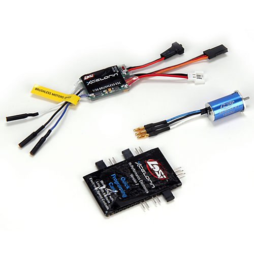

 just installed the brushless and speed control, fully charged the 3s lipo and it wont work at all. when i plug the old battery in, i have full function, but when i plug the 3s in, it only jerks the front wheels left, no function. i can do this over and over. the battery is holding a charge, as it can spin a motor, but for some reason the servo wont register it at all. am i supposed to replace all internals for this to work?? very confused and frustrated seeing as how 90 dollars worth of upgrades rendered my 80 dollar car immobile. a lil help greatly appreciated
note:the upgrades i mentioned are the ONLY thing i have replaced. the rest is stock.

 1/36 brushless esc/motor combo from xcelorin: losb9595, 10250Kv
yes its the stock 5 wire servo
unplugged servo, still no throttle response.
the esc is set to:
3s lipo
normal braking
reverse yes
it is a 3s lipo.
im starting to think somethings wrong with the battery, but when i plug it directly to the old motor it spins (like a bat outta hell). my only theory is that the stock system is meant for 4.8V and the new battery is 7.2V but ive never had this problem with other RC's before.

I checked the specs at the Losi site and it states that the Xcelorin micro system is 3S compatible (up to 11.1v).  However, the instructions state that it's compatible up to 2S (7.4v).  The problem you describe sounds like the ESC is shutting down into a protection feature, such as over voltage.  This would also explain why the system is completely functional on a 4.8v battery.  Losi apparently has contradicting information on their website but, I have always been under the impression that the micro systems can handle up to 2S.  If the guys on Youtube are runnin 3S in the micro cars then they're using a different ESC which can handle the increased voltage.  Can you upload a photo of your battery?

 the battery part number is LOSB9824
figured id show the speed control too, idk

THIS IS HILARIOUS. i didnt even realize it says 11.1V till i looked at the picture i took after i uploaded it to the site.

Why don't u buy the newer style program card, and set the LVD for 3s???? Or am I missing something?
Seriously I wouldent recomend plunging in a lipo with out setting up the LVD, that's just asking for problems.
Answer this honestly, did u read the instructions?
http://www.losi.com/Products/Features.aspx?ProdId=LOSB9375
That's the new card, losi just haven't updated there pic of it but u can see the updated card in the pic below.
Notice it has a extra plug for the jumper that's the closest in the pic? that's for 3s.
In that pic it's set to nimh. After that there is 2s then 3s

Trust me it is 3s capable, I've got the same esc in a micro SCT.

I'm 100% sure it's because he is using a 3s lipo in the nimh setting... Only the newer style cards have the jumper for 3s

quote:
ORIGINAL: phmaximus
That could be true. I have a used micro DT from about 2 years ago and it came with the 3s programming card so they have been out a while.
His 3s lipo also looks a bit rough. It could be old or used or the over discharge protection could be kicking in. Heck, I've read about people charging their lipos with the stock battery powered nimh chargers. I was just trying to cover all the bases with my questions.
Hide Signatures
(in reply to phmaximus)
       Post #: 19
RE: micro t: 3s lipo wont work at all - 1/23/2013 10:04 AM
phmaximus
Posts: 4183
Score: 627
Joined: 6/8/2008
Last Login: 5/23/2013
From: Adelaideaustralia, AUSTRALIA
Status: offline
good idea to cover all bases but he hasent been online since the 8th MIA for 2 weeks...
