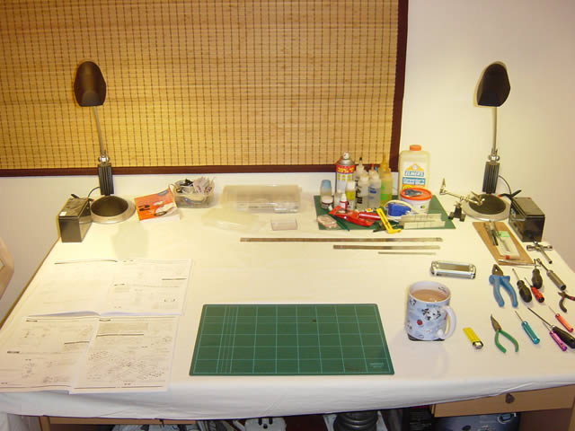

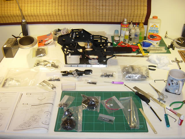

aaaahhhhh… all set, cup of tea, tools at the ready, nice clean work surface (it took around 2 anxious hours to clean the table top of all the Patriot 40 plane pin board and specific tools before I could even start the GSR.) I like to keep a couple of small plastic boxes on my work area and put all bag contents into them as I go through the manual. I like the bag labelling system JR use, not all kit manufacturers do that, nice when they do.
Bottom left shows the two manuals you need to continually cross-reference. There is also an “errors sheet” (3 very minor things). I highlighted the relevant pages that had an error first while reading through front to back before opening any bags (good practice). One of the manuals is the old GS Voyager version as it is currently the closest they have to the GSR construction manual in English. The Manual for the GSR260 is all in Japanese and if like me your Japanese is “rusty” you need to keep switching from one to the other… I would say that for the sake of paying a translator a few hundred bucks to write an English version would be well worth JR’s investment since I believe the building takes a considerable amount more time than it need to (and @ $1900 you would think they could splash out a little . Most sections in each version of the manual are very similar if not the same on a few pages but obviously it is the things that are NOT the same that are important. There isn’t really anyway to work out what is going on in a few Japanese sections that are not covered by the GS English manual. So far, that is the most avoidably stupid thing about the kit.

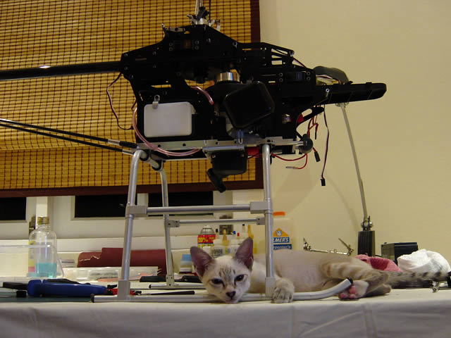

12 Hours into the build and all the main bits and pieces are completed. Servos are in, skids are on (those skid clamps are a tight old fit!!). The tail is pretty much done at this point, just need to start trial fitting the tail fuz around the tail control rod clamps.
Engine is in (roughly).
Still need to make all the ball link rods up but my hands and fingers are raw to the bone already getting that lot together, just can’t take the pain!.. Gonna have some kip and hope my fingers are back into action tomorrow night.

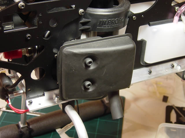

Any educated opinions on good quiet pipes? Would rather it be quiet than HP as this is my replacement Commercial Cam Ship so need to keep the noise levels as low as poss. Suggestions and maybe links to products would be massively appreciated.

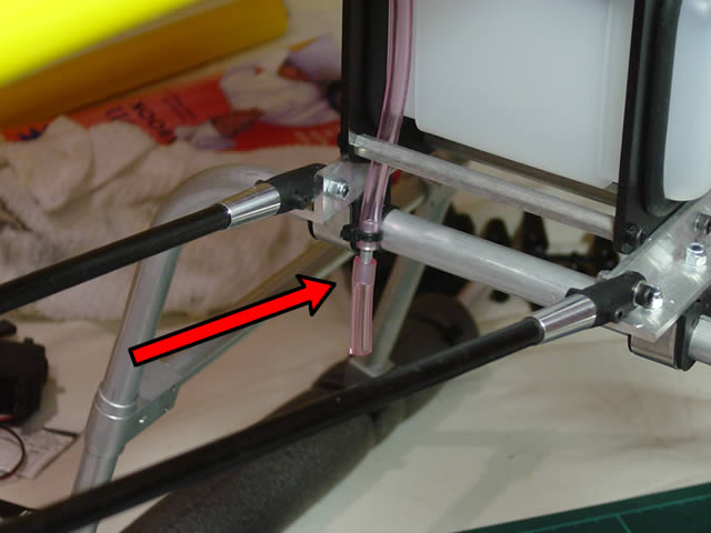

is this correct? And the same thing with the other vent on the carb yeah?. From what I can work out from the instructions, there is no pressure feed from exhaust to tank yeah? Currently I have the top nipple on tank as picture and the one on the carb the same at the front – please let me know if this is incorrect.

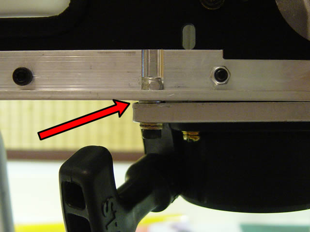

I found I needed a washer to adjust the angle of the engine very slightly to achieve a perfect alignment between engine and clutch bell whilst maintaining good gear mesh etc.

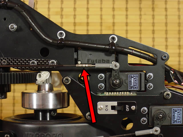

here you can see where I have crimped the tail control link. I don’t have much confidence in this type of connector; I have had a bad experience with one before on a different model. I used 30 min epoxy after sanding (to roughing up only) with 150 grade sand paper. Then I used a pair of pliers and gently crimped the connector in several places. I am hoping this will give me a little more security – I have done this both ends (because the air cannot escape when you insert the CF rod into the threaded connector, they keep wanting to pop back out b4 the epoxy sets, I crimped them slightly first to let air out). Please let me know if any of you have had bad experiences with this type of linkage failing.
BTW- the rizla papers in between the gears was from setting up the mesh. Normally 4 layers of the blue type rizla makes a perfect mesh IMHO
Also – note use of S9253 servo on throttle as well as tail, you think this will be ok? I used this servo on my Rappy 60 with a Throttle Jocky pro with the Optical upgrade, thought it would be good to have the throttle slightly ahead of pitch speed to reduce load lag (although with a 26cc engine I am not expecting much load lag )

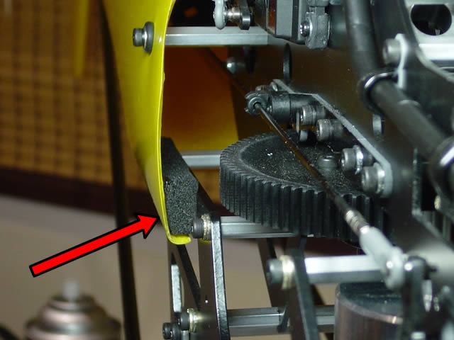

I chose to epoxy some HD foam as shown as the fuz was very slightly touching the side of the lower frames. I could tell it was going to make an awful noise even with the smallest amount of vibration. The fix worked perfectly both sides and feels rock solid with no “rattles” etc.

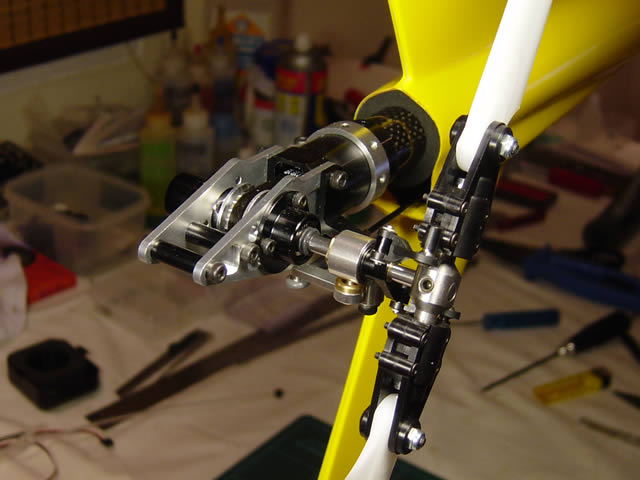

I like the tail on this thing. There is very little slop in the linkage. Loads of messing around re-shaping the tail control rod clamps on the tail boom so that they clear the boom-fuz and tail supports & still slide freely.
I have only had a couple of belt driven tailed Helicopters. The majority of machines I have had in the past have been shaft drive. Despite little time with belts vs shafts, I think the belt drive is much smoother, and in some cases quieter when compared to shaft/bevel gear drive sytems. Blade grip holders are kinda plastic/GRP/CRP type material, at first I thought they were anodised CNC Ali, they look like machined Ali.
Is it right both those rubber ‘o’rings go together or one each side of tail pitch slider? It wasn’t clear on the Jap section.

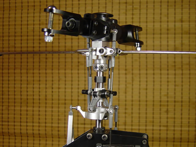

Just about 100% metal head. (not quite though)
Interestingly enough, I have never flown a CCPM chap before. I was really looking forward to this being my first. CCPM just kinda makes more sense to me. It looks like a far more linear based movement compared to the standard 4 point swash. I love this stuff man, just totally slopless, just cant wait to see how it feels in the air, I reckon its gonna hover like its sitting on the table… I wanna eat it! I can often just stare at the marvel of engineering like this for hours. It sends me off thinking about “some chap” who sat down and worked out the whole cyclic control system for the first time. Having started early life as an electronic and mechanical engineer I appreciate stuff like that
The head comes already assembled so I reassembled it re-threadlocking etc as I don’t like trusting factories with stuff like that (like the cardinal rule when passing a firearm to someone and they stupidly ‘ask’ if it is loaded. If you need to ask, you need to check).
The main shaft was a smaller diameter than I had expected. It actually looks to be the same dia as the Raptor 60 shaft. I think the GSR shaft is solid vs the hollow raptor shaft though. (don’t quote me on that )

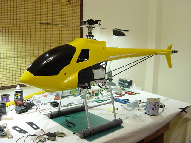

So this is the 99% completed beast in her nakedness. The canopy went on beautifully. I drilled the holes exactly where they were marked on the gel coated surface and the holes lined up perfectly – I love it when that happens!
Canopy window was cut reasonably well from factory to fit recess in main canopy mould, a few trims but generally all pretty good stuff.
I spent an awful amount of time getting the horizontal fins right. I am a little too much of a perfectionist with these kind of things and can often spend hours on something most would just say “that’ll do”. I am around 94% confident the H fins will stay where they are. I used 30 min epoxy after using 80 grit paper to roughen both contact surfaces.
All in all, so far I think this Kit ROCKS!. It is the best machine I have built to date. I think I will feel very confident mounting my Cam gear on this. I like a helicopter that inspires confidence in its reliability during the build. I have built many a model before be it cars, planes or helicopters and sometimes i get put off while building it if the kit seems to be low quality. A good building experience where all the parts are there, all the parts fit and none of the parts look like they should be re-designed can really help me concentrate on the flying experience at the field rather than constantly looking for the “next thing about to break or fail”.

The stock Airfilter HAS to go along with that crappy pipe. Any ideas on where I get one of those K&N jobs? And how do they mount? Do I retain that plastic housing with the choke arm with the K&N or is it a different mount altogether? Some light shed on this would be great (or any links to other posts covering this, my initial searches came up blank.)
