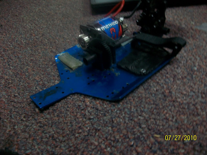

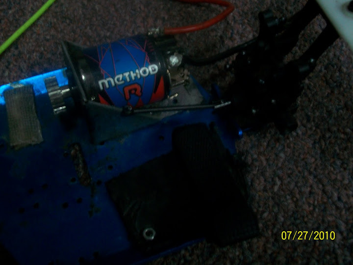

well i got downstairs around uhhh i think 11 30 and its now 2, almost got it all back together (reversed front and rear arms/hubs so gotta switch shock, and ball link sides, after almost 3 hours i was done) either way i got the pinions mounted in, i got a kinda hack way of keeping it all happy, pretty much i took, 2 small squares of paperboard from the packaging and i put it where the diff cases meet on the bottom to give the diff a little bit of room to get pushed back by the pinion and such i only did this on the bottom, and on the top i just left things a little loose, this is far from puerfect this is just me doing what feels pretty smooth (mesh on these pinions is a bit off but i'm hoping the rings will break in quickly). also should my paper diff spapacers not be enuf i was thinking about cutting out some paper washers to get the diff cases a bit longer pushing the ring gear away from the pinion to loosen up mesh, making something like these...
http://www3.towerhobbies.com/cgi-bin/wti0001p?&I=LXLZT9&P=Z
this is when i wish i was still in high school this way i could walk into the tech ed room hop on a computer whip out a pair of cailpers get the ID and OD for that paper washer chaos spec, polp a old cereal box into the laser cutter hit print and watch the majic happen.... ahh rapid prototype how i love the....
i got somepics that i'll post up tommorow of the washers cuz now i'm in bed like fall alspeep hamming this out on my laptop... (i'm talking about diff case, not diff ring washers) also if you have the right screws you can attach the pinion to the output shaft i had these screws
http://www3.towerhobbies.com/cgi-bin/wti0001p?&I=LXUPX2&P=7
i think they're the same size as the ones that hold the ring gear to the diff case only machined threads vs plastic tapping, either way i foudn withe caps they would rub, on the diff case so i chose to run with out up, the pinoin nor the output isn't going anywhere, so i'm not worried,
as for the dog bones, being short, i was able to use a little well placed feul tubing to get the bones well centered in both the outdrives it takes a little trial and error, more with the rear center vs teh front center,
so yea i think i jsut wrote a book not really sure on a laptop like i said and the window is olddly small only like 10 lines of text which is probally a good thing.... either way any q's pust um up, and i'll put up pics of the washers then the assembly, (i had it stripped down to the motor and the battery plate/strap)
the hungery lug (its been like 7 hours since food i can be hungery)

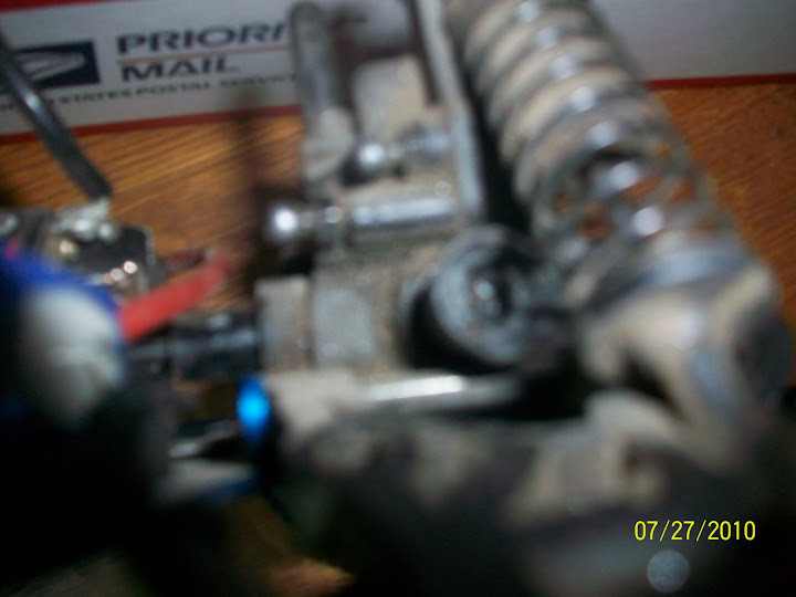

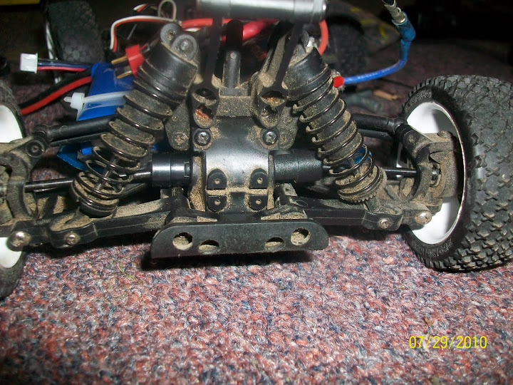

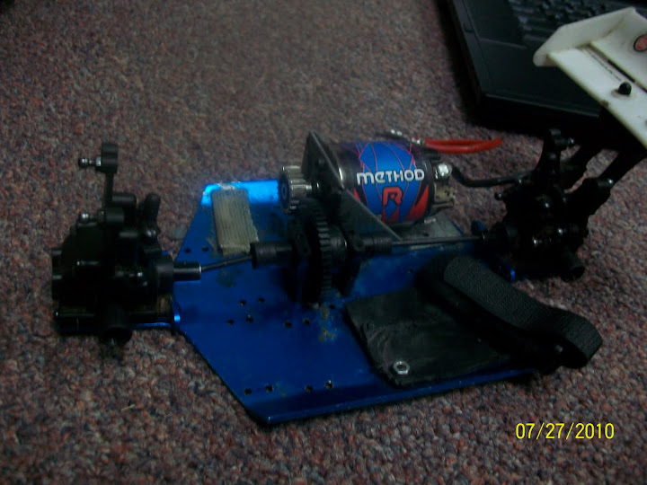

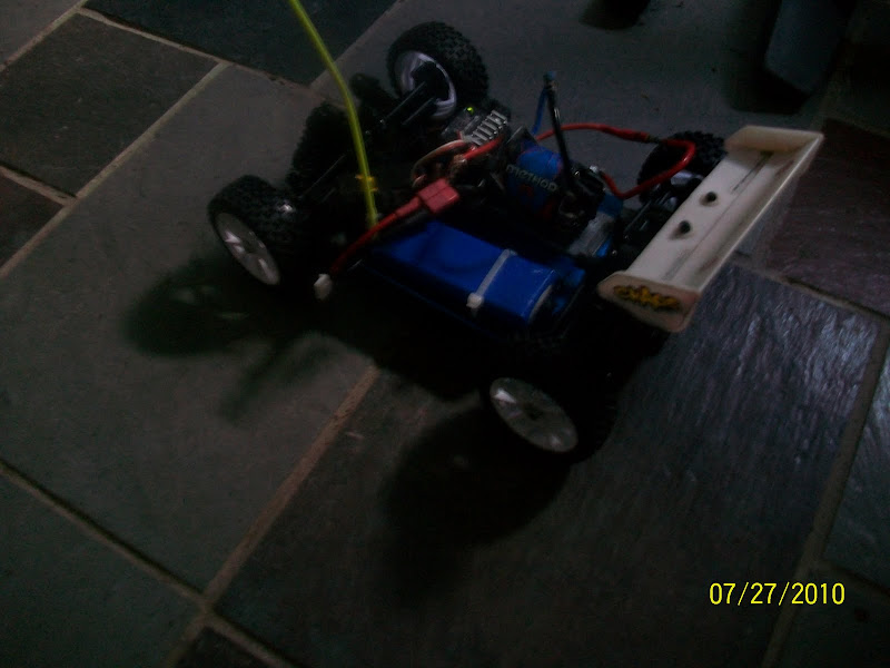

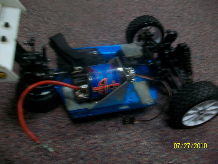

well we finished things up today and it went very well
first thing my paper washers... first 1, i then trimmed them with a knife
sorry its kinda grainy but its a 100X better than it was before it hit the editor (btw the picasa online editor is super nice to have and very easy)
here's a pic of the rear tower bolted up, and my super nice dog bone holder
center diff in place
the front end all mounted up...
added servo arms and such...
then majically and RX ESC and rear end apears on there (i forgot to take a few pics along the way)
i knwo there isn't a ton on the outdives/pinions, i should've snagged a few more but didn't really think they were nessasary at the time but they would've been nice now that i'm posting stuff up... but its a pretty simple install like i said last nite, i'd set the bearings in the cases, (my front one got pulled out with the pinions) then pop the front pinion in holding that in place you should be able to get the outdrive in, they stay together decently, but can fall out, if you like hold it outdrive down it'll fall out...
but i did shoot some vid, its okay, there is a good bit of gear/motor noise but the e chaos has always had that...
was a bit squirly but it ran well, the diffs held up great, havn't pulled them apart yet, after the vid, but after some light running around in the basement, i took a peak, and they looked fine...
now i get to really focus on setting up the diffs, i gotta see about de bonding the ca locker job i did on the rear... i hope boiling watter doesn't mess up the plastic... spun a driveshaft in the hub... i guess the rears don't need feul tubing in the outdrives....
its a bad pic but you get the idea... thats why it was pulling one direction soo much in the vid under accel.
thats all i got for now btw the lipo vs that 8 cell AA nihm pack, LIPO wins soo much lighter
the lug

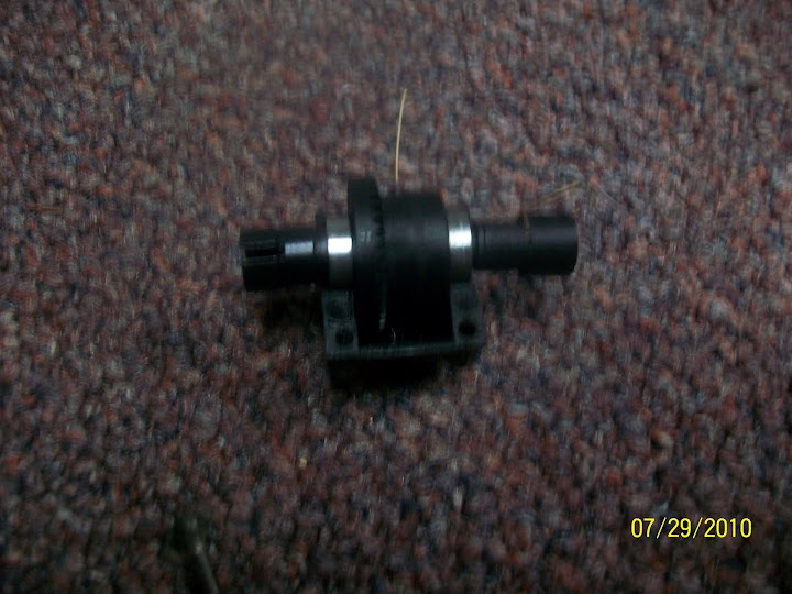

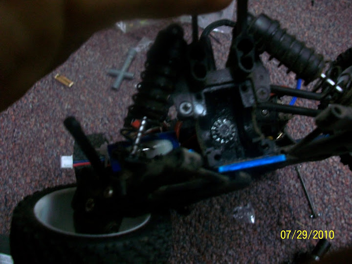

i got my outdrive upgraded found one from a trinity now they bolted on decently had to dremel down the flatspots a bit on the outputs from the diff wasn't too hard tho you gotta do it slow i went a bit too far so pics
sorry this ones a bit blurry
all bolted up
and then the diff pinion in the diff housign...

Ok I dont know what I did, but It ran good for 3 tanks. I was happy with it. So here is a few pics with the larger wheels , lift, and stock.

Nice job. It was probably a small bubble in the line...
The little snausage looks cool w/ the reversed suspension and nose cut-off.
Run it on packed dirt, but not on grass unless it's really short like a golf green.
