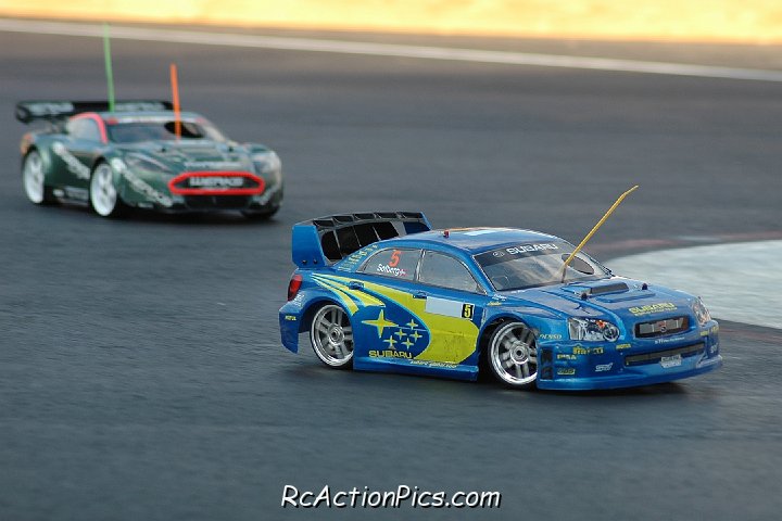

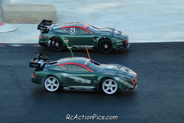

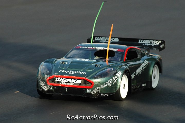

Yes, 75W in all 4 shocks. Sway bars front & rear. 50K in front diff, 10K in rear diff. The car was a rocket ship.
What my IGT really needs is less caster in the front end. I talked to Steve and he said the stock blocks are like 20 degrees.
I think if I could cut that in half my steering would greatly improve.
There were several turns in the infield of the track that I could have gained a lot of time. If my car could have cut those corners the way I’d like to, my laps would have been in the 14 second range.
Any ideas?

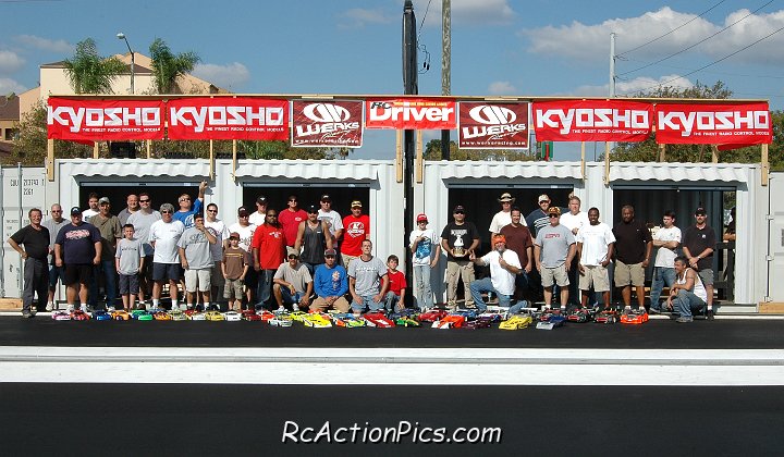

Here are some pictures of the race & my GT in action. I'm the guy holding the gallon of Werks Racing Fuel.
