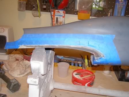

Fuse Plug #2-11
Summary
Today, I glassed the fairings and applied the first coat of epoxy primer on the plug. Now, the fairings are very rigid. I can't bend or break them no matter how hard I try . Next, I have to wet sand the plug smooth, separate the hatch from the fuse, and one last coat of primer. Then, several coats of black enamel followed by MOLDS!!!!!!!!!!
Construction
First, the fairings area was outlined with painters tape (Figure 1). Then, I applied one layer of heavy weight fiberglass to the top and bottom of the wing saddle area (Figures 2 & 3). Followed by feathering the fiberglass to a fine edge (Figure 4). This was NOT fun. Even with 60 grit sandpaper it took 2 hours .
Figures 1 & 2
Figures 3 & 4
One last shape check with the grey Krylon primer (Figure 5). Here's the plug with a few thick coats of white epoxy primer (Figures 6-8).
Figures 5 & 6
Figures 7 & 8
More to come,
Mods
< Message edited by Mods-R-Me -- 4/22/2007 11:35:13 PM >
