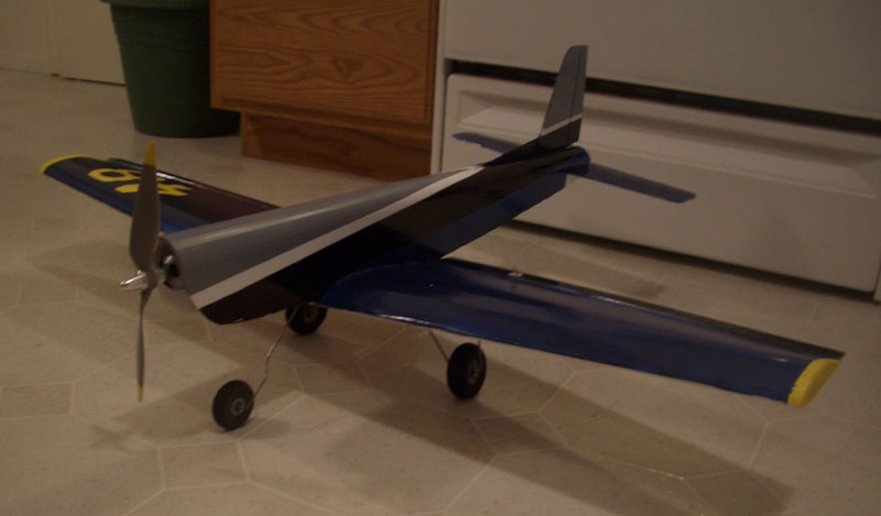

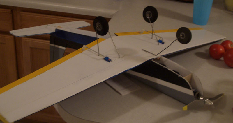

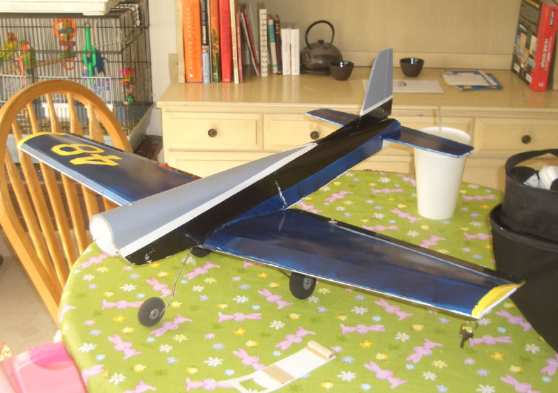

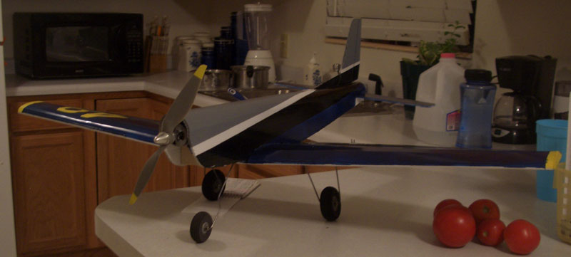

This is my first attempt at SPAD in general, but also to designing & scratchbuilding.
It has a 40" wingspan. E-flite 15 motor. It weighs 40 ounces, for a 0.15oz/in2 wingloading (eek )
Should be plenty fast, I figure! Anyway, I'm gonna try to fly her this weekend.
EDIT: Oh yeah, and it's painted up like Jimmie Johnson's 48-car per my girlfriend's request.

Looks nice, congratualtions ! Couple comments: - The speed might be decreased much by the wings thickness
and the wheels, maybe smaller wheels or no wheels at all would be lot better. And also, you are happy guy - your
girlfriend does not hate(yet) the RC things, better teach her to fly RC as soon as possible ... then you will
be even more happy in the future than most of us ...

Thank You for your compliments. Yes, my G/F is excited to learn RC flying.
I was actually trying to make this a trainer to teach her, because she wants
to learn, but I'm afraid that this plane will be too hot to learn on. I hope to
take the lessons I learned from this one to make a nice trainer next time.
Then she can crash it and it won't matter cause it's a scratch-build job.
Yes, I immediately wished that I had made the wings thicker. As for the
wheels, well they are foamies so they only weight about 5 grams each.
I suppose they will create drag, but I need big wheels to land on grass.
Oh yeah: since the photos were taken I fixed the twist in the tail section.

Although your fuselage is not completely aerodynamic, the biggest drag I guess will come
from the wings. Also take-off from hand and landing on a grass is OK without wheels might
prove how huge the effect of the wheels is - I did that just to test and after that I am trying
to avoid wheels at any cost. That is not only their drag, it seems to me that drag comes in
"right" place to damage every thing even for very big and powerfull planes.

Good looking build! I salute your courage in using the brown stuff for fuse formers. I can't be the only one looking forward to the maiden flight.

The first flight was incredibly difficult! First, the nose landing gear bounced like crazy!
I think I bounced off the runway twice before I was airborne! Then, the control throws
were set about 3 times higher than optimal. At first, I thought the plane was inherently
unstable and unflyable, but then I switched the low rates on and was able to get some
degree of control over the aircraft. I flew a few circuits to set the trim (which was
significant, I regret to report), and then I brought it in to adjust the control throws.
The landing resembled the takeoff, with lots of bouncing, ultimately topling the plane
but causing no damage.
Thanks for the compliments. I was kinda wondering how my use of basswood is "courageous".
Are you just saluting my build technique, or am I taking some risk that i should know of!
Please clarify, Thanks.

My Tongue-in-cheek comment is based on the razzing you may take using anything not plastic in construction of a SPAD. There are a few out there that are intolerant of wood in any form.
Sorry to hear of the difficult first flight. Experimentation can be time consuming, not to mention frustrating. Ultimately you will have something special. It looks good already.
Try either a conventional factory nose gear, or the lighter rudder activated tailwheel. The wire you first built is destined to bounce, as you noticed. I am willing to bet that you will find the extra wing likely to interfere with your racer aspirations. Speed implies a certain amount of wing loading. Extra wing area makes less wing loading but lots of drag to go with it.
I wait with baited breath to hear of your further exploits.
By the way---neat bunnies on the kitchen table.

I've put another few flights on her, and now I've worked out most of the kinks.
Although I fixed the nose-wheel bounciness, I had problems getting the landing gear
to track straight, so I eventually decided to remove the wheels when I found a folding
prop that worked. I flew it twice today in this configuration and it was a nice setup.
Hand-launching was a little dicey though (due to the high wingloading). I will always
have to hand-launch from at least a small hill.
The E-flite 15 flies it around at a fairly good clip with about 65% throttle. I got a 10-min
flight today on a 2000mah battery. Not a bad flight time for electric, and i think I could
stretch that by a couple more minutes.
I've had such a blast scratch-building a plane. I've taken the lessons learned and I've
started working on a second spad. This time I will build fuselage first, then wing after
i know the final fuselage weight. I think I did things a bit backwards on the first plane.
