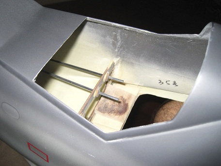

RE: KMP / YT FW-190 Build Thread - 9/7/2012 4:16 PM
Bill Rademacher
Posts: 450
Score: 100
Joined: 12/31/2001
Last Login: 5/25/2013
From: Rineyville, KY, USA
Status: offline
I mounted my PTR 36 in a similar fashion. Put the fuselage vertical. Set the motor without the spinner on the firewall.
If your cowl is tight, put wax paper between the cowl and fuselage. Then place your spinner backplate on the crank and adjust the motor. If you slip it off carefully, not disturbing the motor, then you can mark the motor mounts positions.

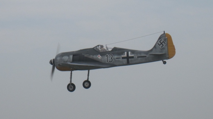

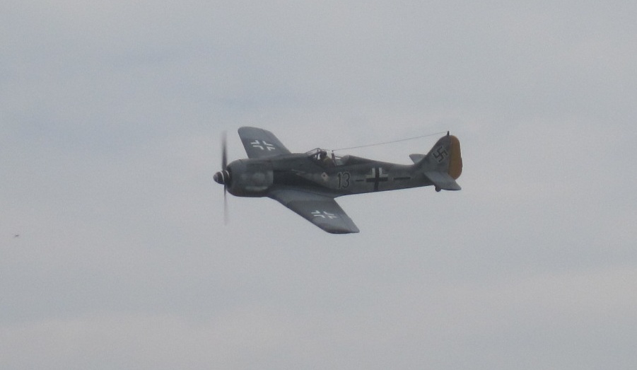

Hi All,
I haven't contributed in a while because my electric 190 has been in retirement for just over a year. Revisited the plane and have had a half dozen flights this month, and finally got a decent movie, shot by my great mate and cameraman Bob.
She flies just as well as I remember, so here is the link to the movie. I hope you enjoy it.
Al
http://www.youtube.com/watch?v=KkLyzHtRkcE

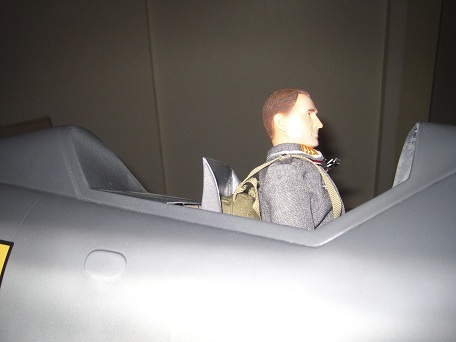

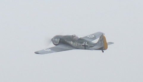

RE: KMP / YT FW-190 Build Thread - 10/8/2012 3:08 AM
Dowmer
Posts: 113
Score: 100
Joined: 10/24/2008
Last Login: 5/14/2013
From: Bangkok, AP, THAILAND
Status: offline
Al,
Nice video!  It really is an art to get everything right.  Al, I must admit you were my inspiration for converting mine to electric. I used your same set up with 8S. I was considering switching to 10 cells. I have enough power for scale flight but I'm swinging a 22X10 prop to get enough watts since my plane is so heavy at 19 pounds. Pretty high Amps at 65 with bursts to 80.
I had a fun day at the field yesterday. Its still very touchy on the elevator though. I have 15mm of throw.  Manual calls for 25mm. I tried expo too, then backed off to none. Plane balanced at 135mm, manual says 140mm. I think I will try 130mm and see how it likes it. Where are you balanced?  Perhaps I'm still a touch tail heavy still. Plane looks very nice in the air and flies pretty rock solid once you get everything trimed and set. Pictures below.
And another some more
I have the gear doors pulled off from previous flights. Wet and muddy field with the monsoon season here in Thailand. I've had a few little mishaps but nothing I can't repair.
The one nice thing I like about bashing these ARFs is that you can do a color scheme that no one has. I haven't seen anyone do the "Pips" Priller bird in a large scale. A real head turner.
One more thing. Feedback for anyone building this plane or any other ESM for that matter. I tore or damaged the gear plate/ribs of this plane 3 times. OK, Ok, my landings or in two cases ..aborted Take offs into soft muddy grass were not pretty but muddy grass tore them loose. The balsa for the leading edge (forward part of the landing gear bay) is real spongy and soft. The ply actually separated and pulled loose twice. I glued the leading edge back with CA to harden it and then CA'd and reinforced everything (ribs, plate etc) with milled glass Epoxy and some FG. No more problems. The greater surface area with the epoxy fillets around the joints did the trick. I'd definitely reinforce and beef up this area if I build another ESM plane.
For Flaps I've tried 15 degrees and none for Take Off. None really required. For landing I use 58-60 degrees. No real pitch change and it slows the plane down fine.
Cheers,
Jason

RE: KMP / YT FW-190 Build Thread - 10/8/2012 6:28 AM
wagen017
Posts: 941
Score: 100
Joined: 10/5/2003
Last Login: 5/23/2013
From: Eindhoven, NETHERLANDS
Status: offline
Jaspn, don't forget: flying electric means no fuel! I'll be hauling around a pound of fuel at take off. So moving to 130mm for CG might really help you. Maybe some other electrics can chime in.

Hi Jason,
Great photos and an equally impressive colour scheme .
The CG on mine is at 140mm. I too have found that the elevator is sensitive with the flaps and wheels down, but I guess that I have got used to it. Having said that, you can see on the movie that I had a couple of "bites" at the landing!!
I have 3 other FW190As, the FMS 1400mm one, the ST Model 1200mm one and the FMS 800mm one. The first two have retractable wheels and flaps and they are also pitch sensitive during the landing.
I'm sure that moving the CG forward to 130mm will make it less sensitive.
Hope this helps,
Al

Jason,looked at the pictures again and looks like you did a great job on the pilot figure / cockpit. Could you show a detail picture + story on what you did?
Volkert

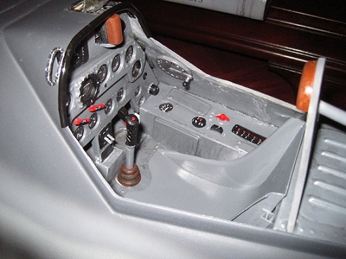

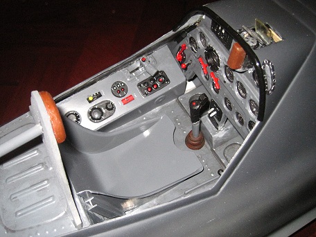

RE: KMP / YT FW-190 Build Thread - 10/9/2012 2:43 AM
Dowmer
Posts: 113
Score: 100
Joined: 10/24/2008
Status: offline
Kahlog,
True, True.  I here ya!....But I think they are using some ironic gas usage humor...
Volkert,
Thanks for the compliment.  I'll post some of my cockpit details below from my Build Thread over on RCSB.  If you want more you can go to RCSB and check out the whole Bash build.  You can Register (free) to view, but if you want to post more than 5 times then you will need to subscibe for $20.  Well worth it IMHO.
My RCSB thread:
http://www.rcscalebuilder.com/forum/forum_posts.asp?TID=17536&PN=1&TPN=1
Quote:
I'm using a DBalsa cockpit kit and I'll need to determine how it will fit with the servo tray located in the fuse.  This first part will go quick since I've been building on it for a little while.  First was cutting a hole for the cockpit kit.  A dremmel cutoff wheel was indispensible for this.  I then had to figure out the placement for the cockpit deck.  I had to get it as low as I could without interferring with the servo tray.  I decided in a little higher than scale location for ease of installation without removing too much.  After some trial and error it fit OK.  I threw a 1/6 scale Dragon pilot to check for depth.  Pic below.  I later trimmed the back of the seat down to look more scale and installed the rest of the kit.  Quite a few things were not very scale with the kit, but it was a starting place to add touches.  It's no INZPAN kit but it works for an ARF and adds quite a bit.  I wish INZPAN made a 1/6th scale kit.  (I now know that I Fly Tallies.com offers cockpit parts for a great looking cockpit.
http://www.iflytailies.com/store/instruments/1-6-scale-warbirds/.)
Here's the pilot test fit.  The height looks about right.  I later removed some stuffing from his chute so he would sit better in the seat. Here's a picture of the man himself "Pips" Priller.  Remember, I cut the seat back down in later.  It was too high.  It's not the most scale cockpit in the world, but for a Bash in an ARF I was fairly happy with the outcome.
Here's the rest of the cockpit put together.  I cut hand holds out and sunk the REVI sight into the dash.  The kit directions had it mounted to the front so it stuck out, but I think the embeded position looks more scale.
Cheers,
Jason

Mine with a Saito 170r 2 half pounds +2 batterys both 4 cell hydra max 4200 mah weighing a pound between them placed hard against the inside fire wall on board glow driver placed hard against fire wall all up front weight over 4 pounds RESULTS = to date 176 flights no prangs clean undies and heaps of fun
