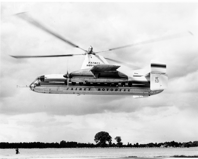

Hey Gang, I'm looking for 3-veiws of the Rotodyne. So far I've been unsuccessful. Any ideas?

Oh yes indeed, I've had the Fairey Rotodyne on my building list for a while now. I've got a good number of pictures, an Airfix kit (very useful and has a set of 3-views!) and even some promotional films on video. What a glorious machine! I can send you the 3-views if you want, but you really should get the Airfix kit yourself. Having a 3-D model in your hands really helps to visualise things.
Jim Morley (of Morley Helicopters) made a Rotodyne as a helicopter, it did fly but it had a rotor diameter of 60" and weighed FOURTEEN POUNDS!!!
Biggest problem I could see with an autogyro Rotodyne was the rotors hitting the tail. There isn't much clearance even when the rotor disk is sitting flat, when you rake it back things get pretty tight. It won't stop me having a go, but there are other projects on my building list as well. Mine would be electric, of course

Okay, here's a question for the technical types to ponder.
The full size Rotodyne used tipjets to get the rotors up to speed, then switched them off and went into autorotation for most of the flight. For landing, the tipjets were re-ignited (looks cool!) which kept the rotors turning for hovering flight. There was no torque with this system, so no tail rotors were needed.
The rotor disk was completely flat, no rake whatsoever. So, how did it autorotate? Will that work with a model?

If you look at early autogyros like the Pitcairn series PCA-1 and on, they had what appeared to be no rake at all. In fact they had a couple of degrees aft rake and a small tilt toward the retreating blade.
On the Rotodyne it also has a very small aft rake angle which is countered by a small thrust from the props on both engines.
I recall that when in autorotation the main rotor actually spins slower than when using the tip jets giving rise to a higher coning angle, this in itself would present a larger area of disc to the oncoming airflow. In addition when viewed from the side while in flight the Rotodyne does fly slightly tail low when in autorotation increasing its effective rake.
The lowest rake angle I have ever managed to fly a model autogyro is 4 degrees. This was with a very reduced hang angle and was not exactly stable in pitch. I don’t recommend it !

I've been wanting to visit that museum for a long time, unfortunately it's on the other side of the country for me! Maybe this year I will do it. I once asked them about the Rotodyne and they suggested I come and take a look, and see if I could find some of the pieces! I didn't realise it had been sliced up that badly
My only concern with a Rotodyne model is with the rotor striking the fins, particularly as I want the fins vertical rather than slanted outwards. If the coning angle is equal to the mast rake, that would at least keep the rear half of the disk parallel to the fuselage in flight. But the blades still need to come up to speed before they will cone properly.
Is there any merit in having an adjustable rake angle? I wasn't planning on a DC head since the Rotodyne will always have airflow over the control surfaces. If I could keep the mast vertical while getting the rotors up to speed, then tilt it back for flight - would that cause horrible problems at takeoff, just when I don't need them?
A flying test bed would be a very good place to start, just a stick fuselage with rudimentary wings and tail surfaces, and a couple of motors to experiment with.

If I were to make an attempt at building a scale Rotodyne it would have DC roll on the head and a normal elevator. I used this method on my latest autogyro with excellent results. It also means you can use a lower mast as the aft tilt is fixed.
I also built a gyro a while back with a fixed mast and stub wings with ailerons as well as elevator and rudder control. it was not successful and had poor control authority in roll, a DC roll control would have cured this. With the ailerons inboard as the Rotodyne would be I doubt the airflow would be sufficient for control unless the model was flying really fast or at high throttle settings using the propwash.
