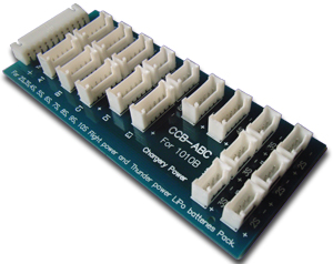

now, there are balance chargers can charge one 10S or 12S lipo battery, but the battery must mount one 11pin balance connector for 10S battery. in fact, the present 10S battery mounted 2*6pin balance connectors. so when you charge 2*6S battery, you must connect them in series, not only power leads connected in series, but also the balance wire (through balance connector) must be connected in series. this is comprehensive, but it is essential, unless the charging current is under 3A.
Use the below CONVERSION ADAPTER, The 2*5s packs, or 3*3s, 3*2S battery packs can be connected in series through balance connector. and you need connect in series the discharge power leads of two battery if you want to charge two battery at over 3A.
