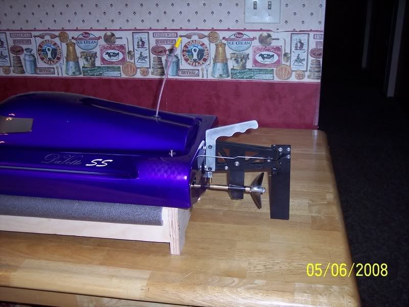

I should let you know that if you have alot of kids playing with the r/c boat for the first time you might want to make a launching handle for the XP-2 . I'd hate to hear of any kids missing a few fingers because they forgot about where the prop is . I also mentioned it to Tony at WWH .

Great idea Dana. I accidently got my hand in an airplane prop about 20 years ago. Yes stitches were involved. The engine was idling and it was a nylon prop. If it had been a boating incident, I would be missing fingers
